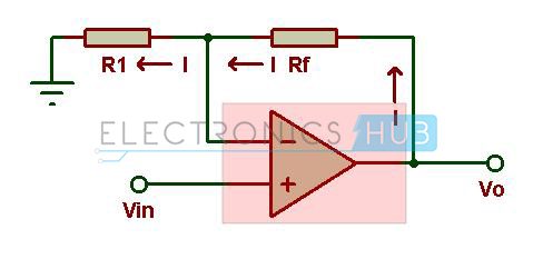

Changing from an inverting (Bassman AB165) to non inverting (eg SR AB763) power amp arrangement also requires, as the description indicates, the polarity of the balanced signal to be reversed.
how is that changing the polarity? - grid input and cathode of the LTPI are in same phase relationship?...
Indeed but that’s just looking at its input stage, whereas when considering feedback implementation, we must consider the power amp system as a whole.
Note that for the Bassman AB165, the voltage sample of the output signal is fed back to the same power amp input as that used for the signal. Hence for the feedback to be negative, the power amp must be configured for that to be its inverting input.
Whereas for the SR AB763, the voltage sample of the output signal is fed back to the ‘other’ power amp input. Therefore the ‘other’ power amp input must be its inverting one; if not, the feedback would be positive not negative.
So from the above, it is apparent that the Bassman AB165 is configured as an inverting amp, whereas the SR AB763 is configured as a non inverting amp. Hence when changing from one to the other, one way or another, the polarity of the power amp will need to be flipped.
Hope that made sense  :think1:

The LTPI is a differential amplifier that amplifies the difference between the signal at its two inputs...With the SR AB763 LTPI, the NFB signal is presented to the input of the non-inverting stage.  The NFB signal needs to be in phase with the signal at the input of the inverting stage in order to reduce the difference between the two inputs...
The above seems topsy turvey.
The NFB signal is a voltage sample of the output signal. If it was applied to the non-inverting input, the feedback would be positive and the amplifier would be prone to instability.
Hence the output and input signals must have the same polarity; the power amplifier block may be represented -
With Rf being 820ohms, R1 being 47ohms.
...With the AB165 LTPI, the input of the non-inverting stage is referenced to ground so that the difference between the two inputs is the same as the input of the inverting stage...
Indeed, the power amplifier block may be represented -
Rf is 47k and R1 is formed by the output impedance of the preceding stage.
With both the AB165 Bassman and the SR AB763, the input signal is applied to the same LTP input. Hence when comparing the 2 power amps, somewhere in the power amp block, the signal polarity (and so inverting / non-inverting nature of the LTP inputs) must get flipped.
