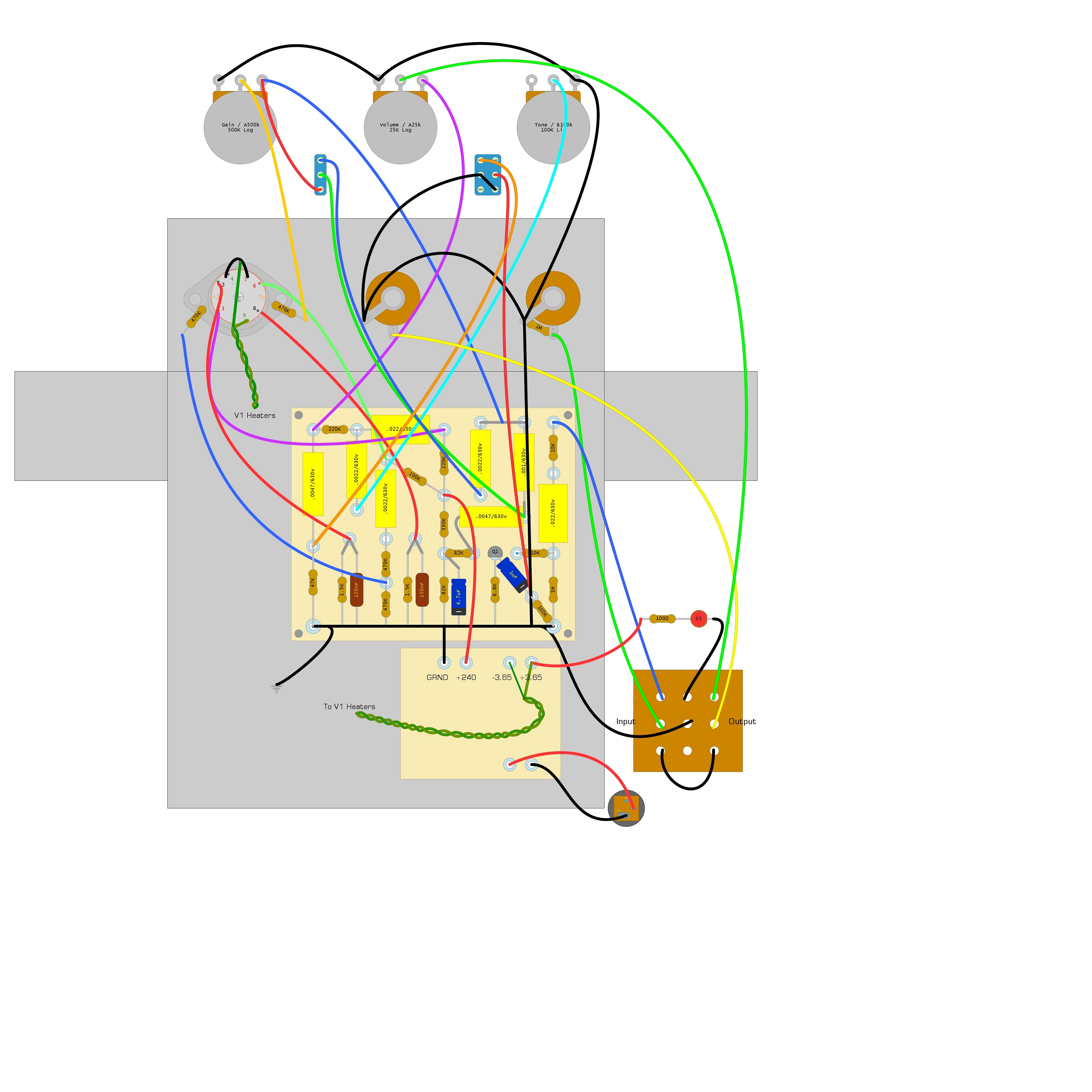

I just acquired a well-used and modded Traynor YBA-1A MkII.  The listing had it described as having the Plexi mods done to it.
In addition to re-gluing the head cabinet which was separating at a joint, I have re-traced the schematic as best as I could to determine WHAT has been modded.  I would like to bring it back to stock as a starting point and only apply whatever mods to the circuit make sense to me.  I'm not wanting it to be a Marshall, I'm wanting it to be a Traynor (similarities and differences aside).  What I really want is the high headroom potential to be maximized (big Hammond iron is BIG), while keeping the tonality firmly in that middle area between Fender and Marshall that these amps are known to occupy and also to make sure that the previous tech didn't bungle anything up
So popping the chassis out to take a look, I see some very obvious changes:
-The old "cigar" filter capacitors have been replaced, and the cap cans mounted to the chassis have been left there but disconnected.  In the place of those old
 caps are four newer 220uf caps, along with a:
-33uf cap to ground coming off of the 100k resistors (R8 & R9 on the schematic).  I cant find this on the schematic, although I see it in most gut pics of this
 amp online.
-There is an apparently new 3.3uf cap to ground between the 820Ω resistor coming from pin 8 of V2.  Dont know what that is doing.
-There are two 1K resistors coming off of pins 3 on both power tubes and connecting before heading to the filter caps.
-Phase inverter resistors are now 1M/10k/1M instead of the original 47k/6.8k/47k values.  (I think I'll keep these as is)
-.1uf bass cap now .022uf (I think I want to keep it that way).
-47k NFB resistor instead of original 100k. (might keep this too).
-470pf cap feeding pin 3 of the treble pot instead of original .001uf value.  (might want to step it down to 330Ω?)
-1M volume pots instead of 4M or 500k that I see in the two schematics floating around (might want to keep these too).
-270k mix resistors instead of original 100k (not sure what to do here, take 'em up to 470k?).
-10uf/150v caps in place of original 8uf/250v for C13 & C14 (might want to bump these up to 250v)
-V1 pins 3 and 8 are terminated to ground through a .68uf/2.7k and an 820Ω/25uf pair respectively instead of schematic values of 1.5k & 125uf?.  I am
 not sure what to do with these values.
-R31 43k instead of schematic value of 47k.
-Cant tell WHAT the two large high power resistors on the right side of the board are but my best guess is 20k and 1750Ω.
-The 470Ω R38 seems to be missing.
-Death cap gone - GOOD.
-Appears to be a choke added - cant tell if these came stock (yay, nay?)
-Bias adjust circuit added, 25k pot on back panel).
The main thing that is concerning me right now is the power supply section.  I am not entirely sure how the original values of the cigar and cap cans translate to these new caps but aren't 4x 220uf caps WAY TOO BIG?  I want reasonable power handling, not values that might choke the amp up or be dangerous.
I know there is a ton of info here and a ton I don't know about tonestacks and proper values of components, and any help is greatly appreciated.
I have attached a file of the schematic that I highlighted and typed up the changes I see present.
Any suggestions?  Thanks for reading!

more pics, red-lined schematic:
« Last Edit: May 01, 2021, 05:55:06 pm by rundgrenrules »

Thanks again Sluckey!  I am going through the board and changing the values back to stock except in a few locations where I want to preserve the changes (bright cap, bias adjust, etc).  What would be a more appropriate value for these large filter caps (instead of 220uf) considering the original 40/40 cap cans and the 80uf cigar caps that were there originally?
Also it appears that the bias splitter resistors are 100k, would I benefit from stepping them up to 220k?
I have gone through the schematic some more labelling the changes I have observed, someone correct me if Im wrong in my labelling:
« Last Edit: May 02, 2021, 02:14:29 pm by rundgrenrules »
