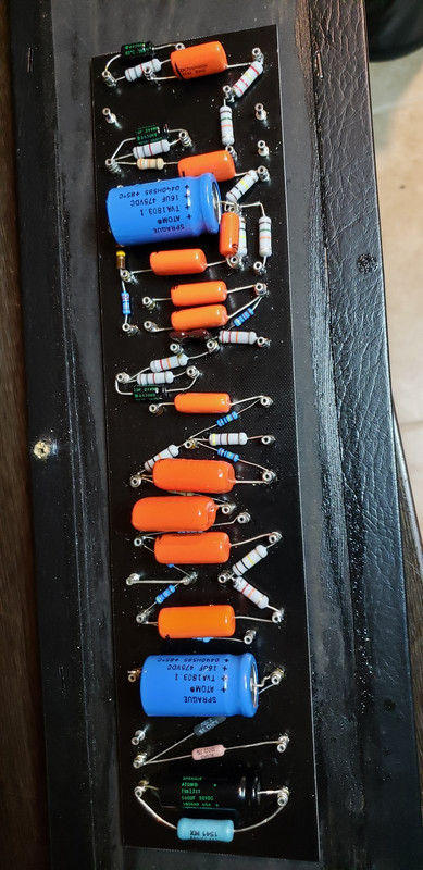

I'm missing a 16uF cap but the board is done otherwise. I thought I had more in stock...Oh Well...
I pulled off the old black tolex and did snakeskin.
Priorities....
I had to stop using the PC for a while. I did the layout for a AB763 and ordered the parts until 3:00AM last night.
I used my hands and time to do what I wanted to do today.
The mouse gives me hellish hand cramps and pain that keeps me awake.

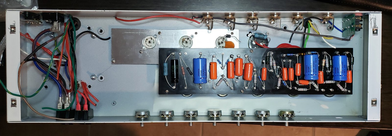

Board Mounted.
Offline Latole
  • Posts: 2522
Re: Tube Rectified SLO-18
« Reply #20 on: July 24, 2021, 02:09:27 pm »
The wires between the circuit and the tubes sockets won't be a problem? Some sockets seem to be hidden under the circuit or am I wrong?
Offline AnalogDok
  • Posts: 83
« Reply #21 on: July 24, 2021, 08:26:16 pm »
It is what it is...Adapt and overcome.
