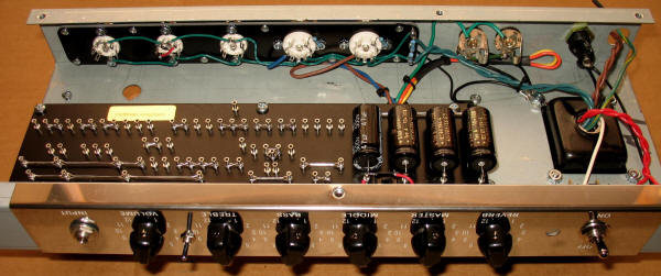

Hi To Everyone Here,
I performed the Blues Jr Mod just before Covid started and the amp seemed to be working perfectly. A little bit of noise but not anything abnormal. Since then I haven't played it and the other day decided to to give it a workout. It seemed to be a lot more noisy than I remember. If you turn either the volume or master volume up the noise gets louder. I honestly don't remember the amp being this way.
Would appreciate suggestions on starting to trouble shoot this problem.

« Reply #5 on: October 13, 2021, 04:23:46 am »
Picture of the wiring may be usefull

« Reply #6 on: October 13, 2021, 09:53:27 am »
Latole is correct.  This is a PCB amp, modded with a power transformer and Hoffman tube socket board.
So it is possible that his AC wiring has strayed close his signal path, or the socket board has been miswired.
Edit:  My bad, I missed the turret board part of his reply.

« Reply #9 on: October 14, 2021, 12:26:08 pm »
Offline Tbone55
  • Posts: 367
Re: Fender Blues Jr Build - Amp Noise
« Reply #10 on: October 14, 2021, 01:42:44 pm »
Bill Machrone?  The father of BJ mods?  (and my favorite journalist of all time).
IMO, these amps do hiss a bit.  Should not be bad.   They generally don't hum, at least in my experience, and I have owned three of them.
Do you think this is a 60 cycle of 120 cycle hum?  Does it hum when the instrument is not plugged in?  Does the environment have an effect (eg, one location vs another)?   Do you have a lot of Led bulbs in the area (I have one spot in my house with LED strip lighting that is very noisy and is to be avoided).  Does it change when volume is turned up or down?   Does it change when V1 is pulled?
I think it's 60 cycle hum. Without the guitar plugged in (Stratocaster) I get very little hum when I turn up the master volume and a bit of hiss when I turn up the volume but amp I'd say is quite quiet. Sounds like the single coils are picking up the hum. I do have Led recessed lighting throughout my basement. Plugged in my humbucker guitar and the amp was almost as quiet as without having a guitar plugged in. With coil split option activated on this guitar the amp still remained relatively quiet. Its looking like the single coils of my strat are the problem. I've got the cavity shielded and a shield underneath the pick up cover as well. This amp is a monster. Turning the master volume just past 2 is loud. You have to turn the input volume all the way up just to get some breakup. Tons of headroom in this amp.
Thanks for the help. If you have any other suggestions please let me know.
