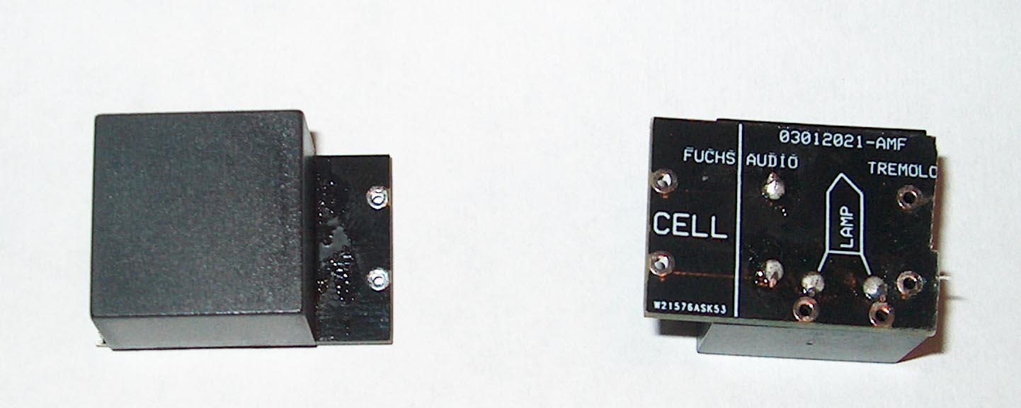

I went through this last year with this same Gemini 1. I have no tremelo. I have all my doc's from many other Gemini amps. You can hear a ticking sound and the speed pot works increasing or decreasing the ticking. But i have to touch a coupling cap to make that happen. Otherwise no tremelo period.Thing's i have done:Installed new Fliptops Trem Module:Installed new Mallory M150 .047 trem caps:Installed (2) Tremelo Cathode Cap's. I have oscillation of voltages across the caps north end. I have 60 VDC on the purple wire going to the lamp.I have 189 VDC on pin#6 when trem switch pedal is disengaged. Lowest voltage during Oscillation of pin 6 is 79 VDC. Last: The INT pot adjusts the volume of the amp.
What am i missing? Here We Go Again.

From your description, the amp is working as though the variable resistor in the trem is open circuit. On the schematic I linked, points X and Y are connected through that resistance, and without it, the trem intensity pot makes a voltage divider with the tone stack that explains the volume change.
Can you observe oscillation on the contact for the lamp itself? You only mention DC on the wire feeding the lamp.
If you have oscillation on the lamp wire, I see two possible explanations:
  • The lamp is bad, leaving the trem resistance at max regardless of what the oscillator is doing.

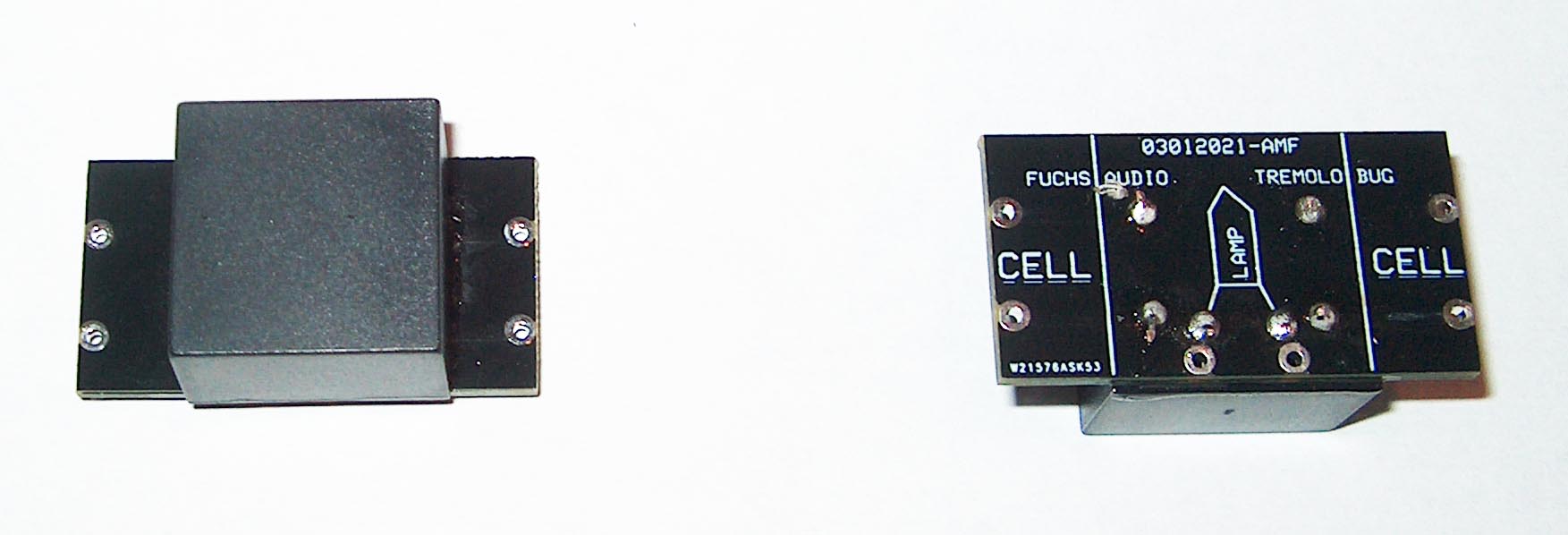

  • You wired the bug wrong. This seems very possible to me not because of anything you posted, but because the fliptops site does not appear to have a wiring diagram for it. In your picture, you use the contacts on the right side of the bug, and in the picture on their website, those contacts are broken off.

There are two choices. This one is the one i have.VM1    VM1 / VM1A Vibrato Module ,  GV and "x" Series Amps UPDATED
And this one that states it works on the Gemini1.
TM1 M1R    TM1/M1-R Tremolo Module for Vintage Ampegs
I have used VM1 / VM1A before and it worked in a Gemimi II.

Reply from Sluckey last year on this very same subject on wiring.
Quote: Ignore the cell on the left.Connect the right cell to the pot wires (points X and Y on the schematic). Doesn't matter which wire goes where.
Connect the lamp to the black and violet wires. Doesn't matter which wire goes where.
« Last Edit: August 12, 2022, 08:22:44 am by plexi50 »

VM module contains two LDRs. The TM module contains only one LDR.

The VM module will work fine in a TM circuit. One LDR will not be used. But the TM module cannot be used in a VM circuit because it only has one LDR. Look at some schematics.

Ok, reversed the pot wires to the left side Cell and BINGO PRESTO! Beautiful full and room filling tremelo! The guy that makes them does not mark the Cell that has the LDR on the board for the TM1 module. He does not break off the end of the TM1 module anymore.
