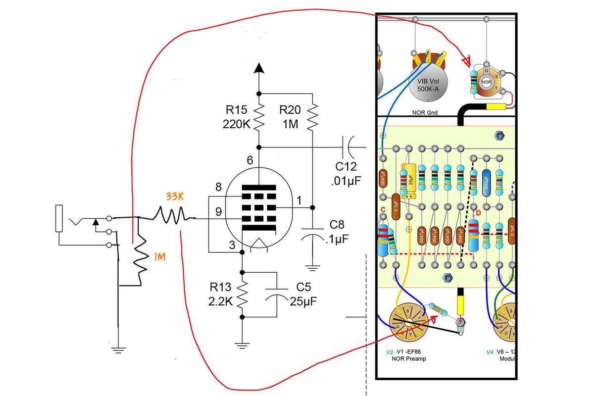

« Reply #12 on: August 12, 2022, 01:49:50 pm »
OK, a very easy thing to do would be replace the green wire between the Brilliance switch and the NOR Vol with a 470K resistor. Use an even larger resistor to reduce the signal even more, or a smaller resistor to reduce the signal not so much. Doing this does not really affect the EF86 gain. It simply drops the output signal so you can turn the volume knob to a higher number.
If you really rather reduce the actual gain of the EF86, then follow Tubeswell suggestions in reply #3.

Following Sluckey council you can give a try splitting the plate resistor and feeding the following circuit with that signal (same effect of the added 470K resistor, without the intrinsec noise induced by that added resistor, end result depends also on how well Is acting your PS filtering)
Look to the first triode plate resistor arrangement

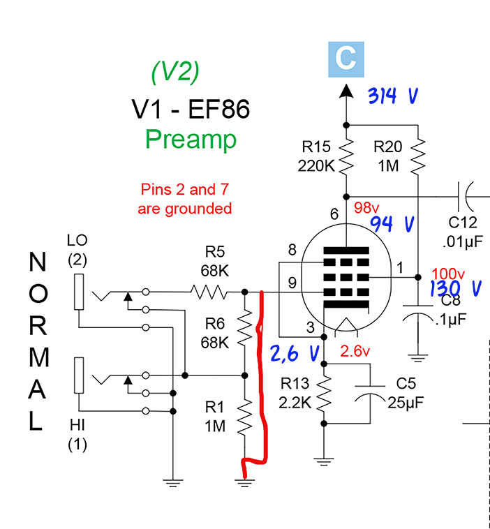

I have made the following measurements and checks:
The 470k resistor replacing the green wire of the brill switch does not affect anything. I have shorted input of EF86(pin 9) to ground. This way I avoid input signal. I have made these voltage measurements and it seems very high to me that of pin 1 (130 V). With all this, when I turn up the volume there is a very big noise like an open signal circuit. That's the strange thing. From the volume to the inverter, there is hardly any noise. The same goes for the vibrato channel, there is no noise but the signal, as we know, is much lower.
That is surprising! Should have cut the signal in half. Are you using the simple brill switch or the 6 position rotary switch? Measure resistance between the vol pot wiper and ground. Slowly turn the pot. Resistance should smoothly change from zero to 500K. Check the ground connection on the vol pot. Try replacing the vol pot.
