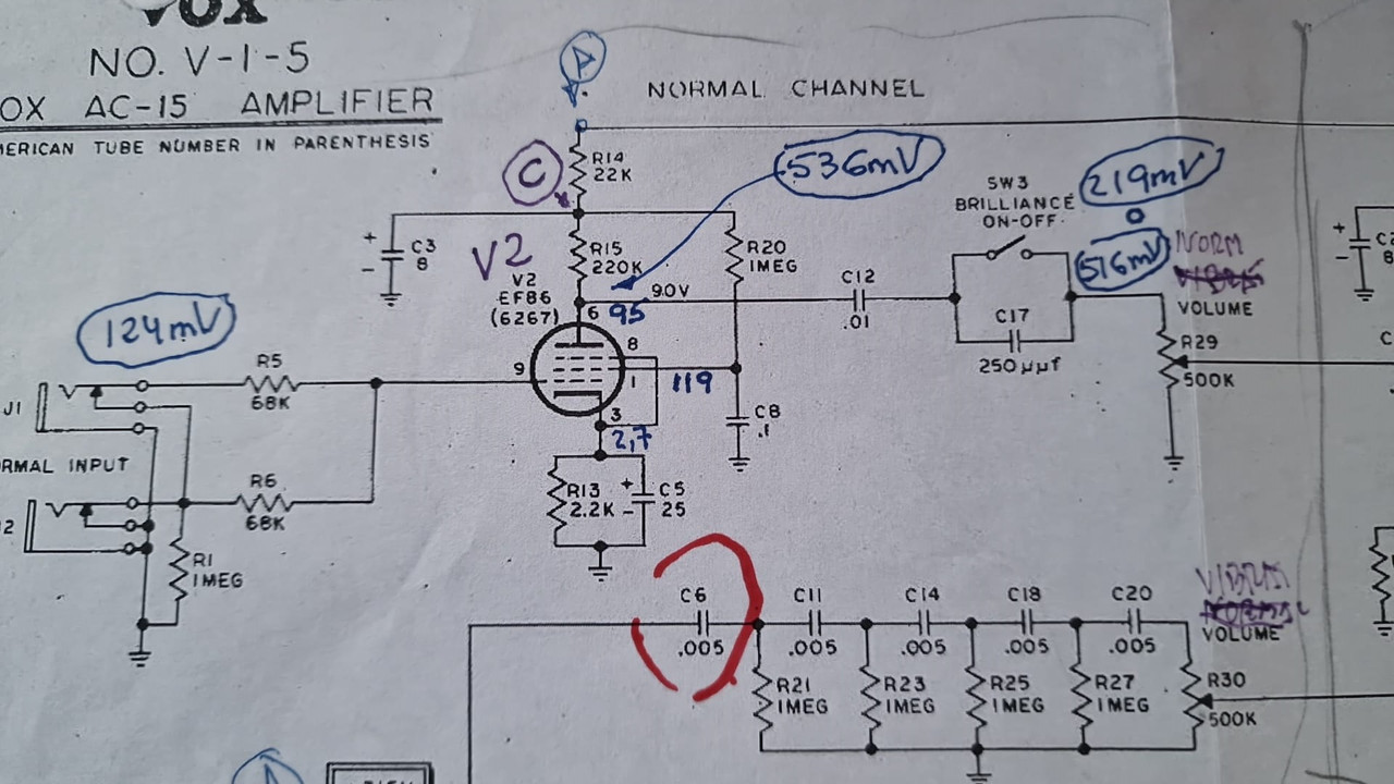

Os muestro mi ampli sonando. Noto demasiada distorsión y ruido de fondo en el canal clean. Es asi?

Gotta be something wrong. Since the VIBRATO channel sounds OK the problem should be around V2. Change EF86 tube. Verify wiring. Verify component values. Measure V2 voltages. Should not be to difficult to find.

The values ​​are:
pin 6: 95V
pin 1: 119V
pin 3: 2.7V
I don't understand what can go wrong.

I have also made measurements with a signal generator at 1 Khz and 124mV at the input, obtaining these values ​​without appreciable distortion on the oscilloscope.
The two values ​​in brill is with brill acting and without acting.

V2 circuit is very sick. Your gain is only 4.3. That's very, very weak. I would expect the gain to be more than 50. IOW, if your input is 124mV at pin 9 your output on pin 9 (plate) should be more than 6V.
Verify your input jack is wired correctly. Measure resistance of R13, R14, R15, and R20 and post four readings. Then measure resistance between ground and EVERY tube pin on V2 and post all nine readings.
You do understand that BRILLIANCE is active when the switch is open, ie, not shorting C17?

R15: 213K
R14: 21K5
R20: 972K
R13: 2K18
V2
PIN1:1M1
PIN2:2,6 OHM
PIN3:2K1
PIN4:3 OHM
PIN5:2,8 OHM
PIN6:343 K
PIN7:2,5 OHM
PIN8:2K1
PIN9:32K8
About the BRIGHTNESS, I understand that when passing a signal through a low capacity capacitor, it will preferentially let the highest frequencies pass. Therefore it will work as BRIGHT when sw3 is NOT short-circuited. I already told you that I have to turn the switch to match the serigraphy.

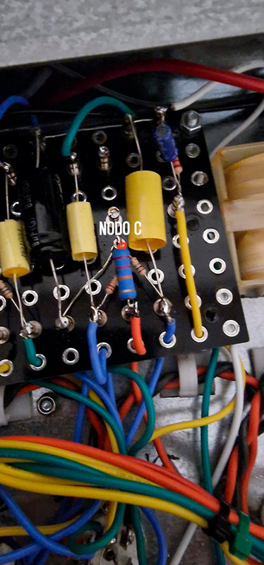

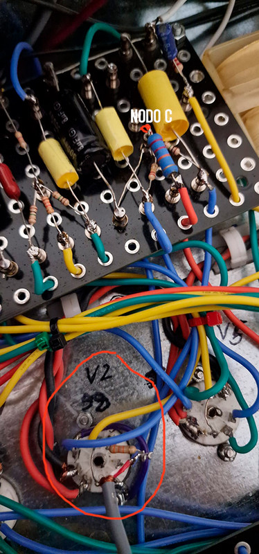

What voltage do you measure from Node C (C3) to ground? What resistance do you measure from Node C (C3) to ground? Reverse your meter leads and measure resistance again.

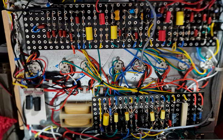

Show us some pics of your board in the area of the normal channel circuitry. You had some issues with the board earlier. Did you correct that?
Offline rafaelctt
  • Posts: 199
Re: My Vox Ac15 playing
« Reply #16 on: September 18, 2022, 02:34:45 pm »
Tensión en nodo C :317 V
Resistencia en nodo C: 130K
I did the circuit again divided into two zones

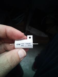

I am going to measure and view the entire signal path with an oscilloscope to determine where the distortion is occurring.
Could I do it with an 8 Ohm load instead of speakers without damaging the OT?

I use a dummyload most of the time, works well.  the wattage is important, a 25W R in a 100W amp might not last long
The amp is 15w and the load is 8 ohms 25w
« Reply #21 on: September 21, 2022, 12:10:08 pm »
That type resistor needs additional heatsinking to dissipate 25W, and maybe for 15W.
For short-term, let it set naked on a fire-resistant bench and smear a little meat on top. When it smells like dinner, take a break to cool down.
For long-term runs a paint-can full of oil will dissipate a lot more power all night.

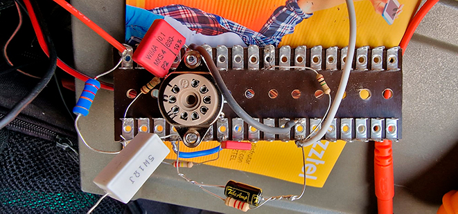

I have bought a new EF86 and all the components that surround it.
I have built a simulator and made measurements.
The amplification is correct when the power tubes (2xEl84) are not inserted.
I give you measurements:
POINT C 345 V WITH POWER LAMPS INSERTED
AMPLIFICATION EF86 1.3 V with INPUT 90mV
POINT C 427 V WITH POWER LAMPS NOT INSERTED
AMPLIFICATION EF86 3.5 V with 90mV INPUT
POINT C 430 V WITH POWER LAMPS NOT INSERTED (and disconnected C12 to Brightness)
AMPLIFICATION EF86 4.7 V with 90mV INPUT

There should be an 8µF filter cap connected to the junction of that 22K, 1M, and 220K resistors.

that resistance is set to about 22k with 8 mF from point C. The idea is to lower the voltage a bit.

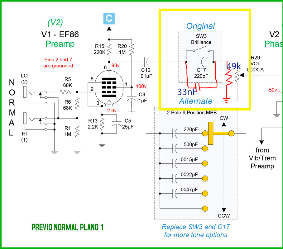

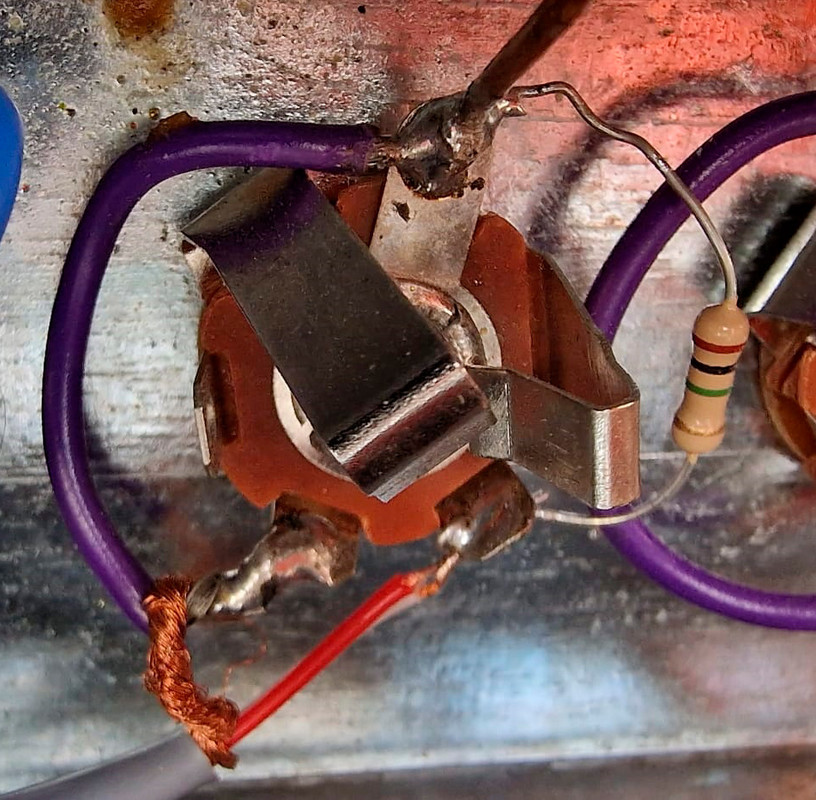

I bought a new Ef86 and it still sounded the same. I made an external simulator and the measurements were the same. So I decided to modify the output impedance just after the brightness SW. I connected a 47k resistor to ground and I got my goal: minus background noise and be able to vary the signature volume more proportionately.

With these two modifications I have achieved exactly what I was looking for. I know it seems strange but there are many tests, measurements and changes that I have made to reach this conclusion. The sound is that of the video. I think it is fine.
There is an error in the image: the resistor is 47k
