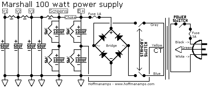

Hello friends,my name is Sergio I'm from Brazil and is my first post here.I need help from anyone because I have a doubt.I'm buiding a Hoffman Plexi 50, here I'm posting the diagram of power supply.Can someone check if the values of capacitors and resistors are OK for 360Vca transformer output?..thanks in advance..regards for all.
  • Posts: 3146
Re: Hoffman Plexi 50 power supply
« Reply #1 on: November 10, 2022, 11:22:20 am »
C1 and C3 could share the same balancing resistor, likewise C2 and C4.

Hi friend, thanks for your reply.You said C1 and C3, C2 and C4 share one resistor for two capacitors, could you make a drawing please?..Also, my biggest doubt is about "voltage", output transforme 360 - 0 - 360vca, capacitors are 400Vcc, do you think is OK?

Yes, I sew this on the library documents, but my biggest doubt is the voltages.I have transformer output 360-0-360Vca, the capacitors are 400V, in serie they will be 800V.Output after diode retifiers 720 x 1,41=1015vcc.

You are wrong. The voltage out of the diodes is 360 x 1.41=507. Your cap voltage rating is fine. See pic for sharing balance resistors...

Here is the 100 watt power supply diagram

Such a high HT voltage of 500V may turn out to result in shortened valve life.
The HT voltage for push pull EL34 with a load around 3k5 is supposed to be 400-430V.
As HT voltage is increased above that, unless the load impedance / screen grid voltage is adjusted to compensate, anode and screen grid dissipation at high audio power outputs will increase near exponentially, to well above their limits.

… I'm building the amplifier following the original project I hope it works.
Transformer voltages such as your 360V can be specified at no load 0mA, full load eg 250mA, or some point in between.
A transformer’s secondary voltage will decrease as the current drawn from the winding increases.
The point being that 360V might be fine if it’s the no load voltage, but may result in valve stress if it’s the full load voltage.
