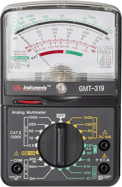

......really meant you have -5.34v and -5.13v, that's way too low.
Might ask what meter was used. A 200kOhm meter would read half voltage here. A 10k/V@20V, or 20K@50V, needle meter could be in that range. They aren't all ten dollar junk.
https://www.amazon.com/Gardner-Bender-GMT-319-Multimeter-Tester/dp/B0002YUN4C
https://www.amazon.com/Hioki-3030-10-Manual-Ranging-Average-Sensing-Multimeter/dp/B008S0CCHI
https://www.sanwa-america.com/products/yx360trf-analog-multimeter-with-built-in-case
Also I have seen (may still have) a good brand DMM made *for* electricians which defaults to a rather low (by electronic technician standards) hundreds-kOhm impedance on Volts. This masks the small "ghost voltage" when you have an unterminated conductor in a cable with 120v or 240V conductors.
EDIT- no, the Klein CL2000 input impedance, ACV or DCV, is about 8.5 Megs. Not the 11Meg of classic VTVM or the 10Meg of most DMMs, but close. (And if you look for CL2000 on HomeDepot, they have it cross-linked with another product.)
« Last Edit: November 22, 2022, 01:42:24 pm by PRR »
