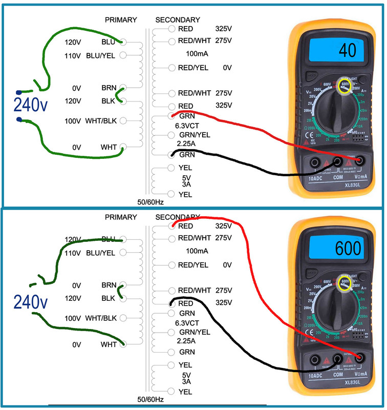

Hello, is it normal that in vacuum(unloaded), there is 40 V AC in the green terminals?
Thank you

Please explain exactly how you measure 40VAC; ie where are you putting the meter probes?

I've never measured voltage in a vacuum before. I suspect you do not have one meter probe connected to a green wire and the other meter probe connected to the other green wire. If you do have the meter connected properly, then the meter is not set correctly, or the meter is lying to you, or maybe just needs a new battery.

Could the primaries be hooked up incorrectly?   Mains voltage?
Hi-rez photos might help us understand the situation.

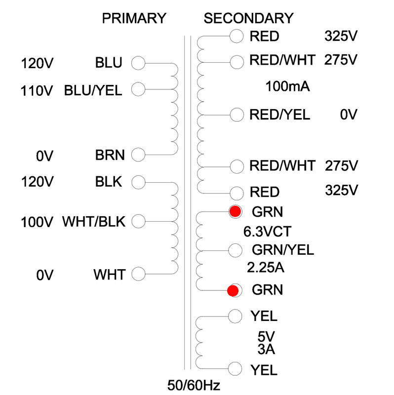

No, STOP ALL, which are the voltages you measure on the other windings ???

« Reply #8 on: December 09, 2022, 12:42:28 am »

Instrument set for DC instead of AC ?
voltmeter at 600 V AC

Ok, that seems weird, it’s worth trying a new battery in the meter, and measuring the 6.3V AC on another amp.
IMO a defective battery will show dimm digits

To make this measurement, is it essential to have the green-yellow wire connected to ground?
No. Try the 200V range. What does the meter read when you are connected to the yellow wires?
New battery in meter?

Where are the probe connected to the meter ? ; picture is cut
Meter look defective.
That's not the meter. It's a simulation.

« Reply #19 on: December 09, 2022, 11:35:55 am »
Depending on design, sometimes a low battery reduces the internal reference and the external voltages will read high. However the cases I have seen, 5%-10% high, not 600% high.
Put a 1k (or 1.5k) resistor load on the winding and try again. Electronic meters are so very sensitive that they will pick up capacitive leakage from a broken winding to other windings like the 230V and 600V. House electricians who run long cable with 0V and 120V and a third UN-connected wire for later wiring may see 59V on the "vacuum" (unconnected) wire. Some electrician-market meters add loading to reduce "phantom" voltages.

Fixed!
Thank you all. It was indeed a problem with the voltmeter. I have changed to another and solved. :worthy1: :worthy1: :worthy1:

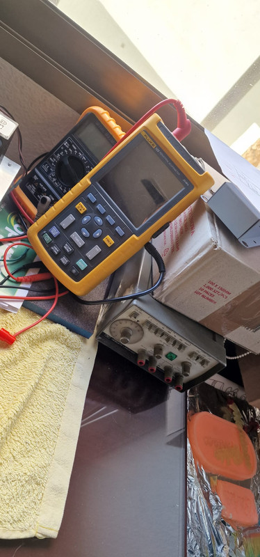

I don't usually work with very bad equipment. I think it was a probe problem.

I did the measurement with an oscilloscope to check if there was any induction

  • Posts: 5230
Re: 40 V AC in the green terminals of 6,3V
« Reply #32 on: December 11, 2022, 08:54:57 am »
Why would you use that cheap $10 XL830L when you have much better equipment available?
