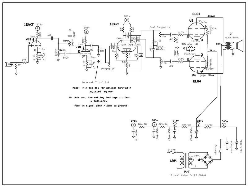

This started out as a Valve Junior rebuild for a friend to use as a power amp for his Digitech GNX3000 amp modeler, but turned into much more.
The starting circuit was basically a Deluxe 6G3, but it quickly evolved way past that.
2 gain stages (with a trim pot between the last gain stage & the PI), LTP PI, no NFB, Hi-Cut control.
Fantastic, touch responsive tone.......probably the best sounding amp I've built so far.
The schematic>>

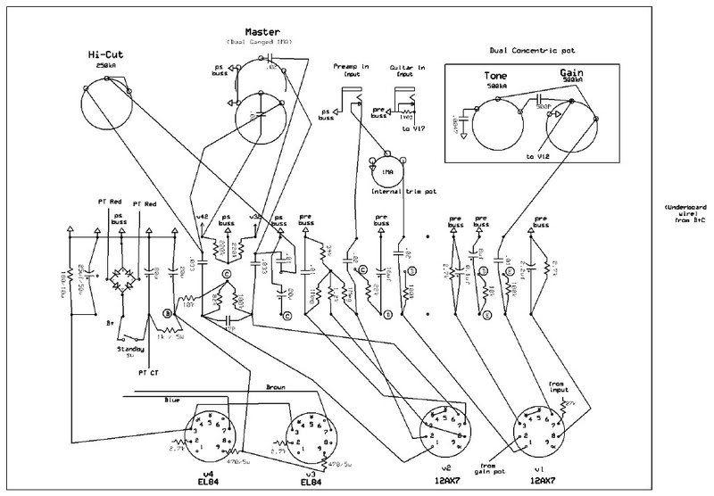

And the Layout>>

Given DaGeezer's positive comments, I thought someone might want to build this as a scratch build vs. a gutted and modded Valve Jr.
So I drew this up. I also indicated a Hammond PT that would be suitable I think for this build and then using a GZ34 rectifier tube. If that was done, the last couple of dropping resistors on the B+ rail would need lower values to get closer to DaGeezer's voltages on the 12AX7 tubes.

Here's a new layout for the Crazy Vox.
This is pretty much true "point-to-point" (my 1st attempt at such) using terminal strips.
The circuit is highly sensitive and can have oscillation if the lead dress is too long. It is very "Trainwreck"-like in that respect, so I thought that the more direct & short leads would help to calm it a bit....we'll see.
I'll be starting on this shortly, as I get the $ together for the parts (although I already have pretty much everything but the Mallory 150's & the PT). For the PT, I'm going to use the $25 Weber RVBPT (260-0 @100mA, 6.3v @3A) which I have had tremendous success with in the past (Little Wing).
Please check for errors......Geez'r

Fixed a few mistakes & did a few tweaks, as follows:
*V1, pin 3 " changed Rk from 2.7k to 2.3k, and corrected the value of the bypass cap from .01uf to the correct 0.1uf.
*Changed the Rk of the output tubes from 185R to 100R. The tubes are now biased @ 100% & have much better definition & clarity....it was biased way too cold with the original 185R. NOTE: the PT I used is 250-0 using a SS bridge recto, so the plate-to-cathode voltage is ~307v. If you use a higher voltage PT, you will have to take that into consideration & calculate the bias current accordingly & adjust you Rk resistor for proper plate dissipation.
*Did away with the "5th" B+ node....the (2) V1 plates now share a common node.
*Added a "normal/medium/low" input switch. on/off/on mini switch gives "normal" input in middle position, "medium" attenuation in the "up" position, & "low" input signal from the guitar in the "down" position. Very useful.
*moved the controls around for a more natural arrangement.
There may be other small changes (i'll post if I remember any), but thoses are the main ones.....G

Updated schematic......made some mods to cut down on Bass responce (too much Bass w/ certain closed back cabs)

More mods & tweaks.......cleaned it up a bit with some local NFB on 2nd gain stage.
Also, I raised the B+ rail voltages to all preamp tubes by decreasing some of the dropping resistor values.
Oh, also now able to put a 12AT7 in the PI slot (was 12AU7) & removed the cathode bypass caps from the triodes......a switchable Ck on at least one of those stages would be good as a "boost" for those who want more gain.
