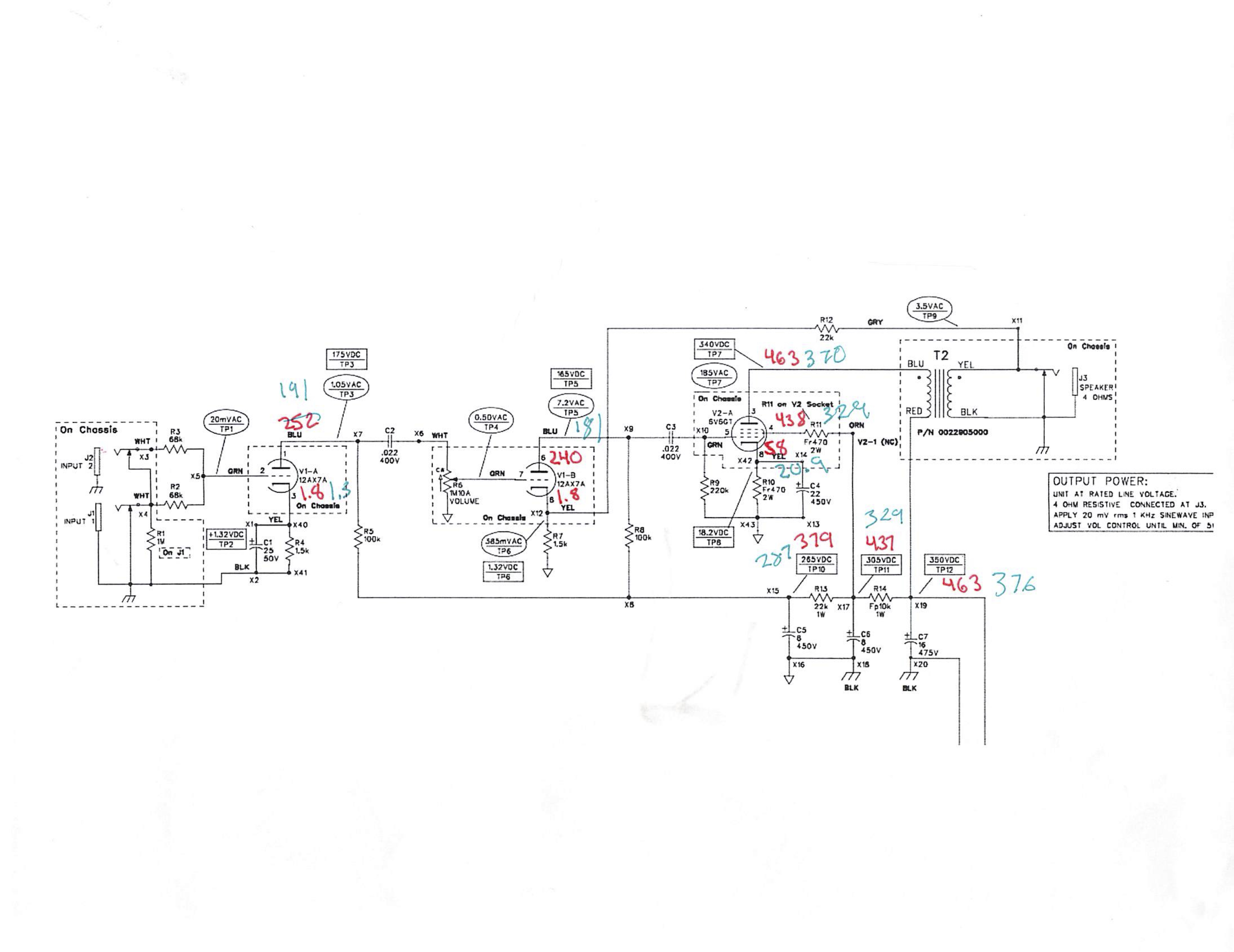

Bought a 57 champ reissue from a local store that was selling it as a customer return. It makes a little distored sound sometimes when a guitar is plugged in but sometimes no output.
I have done the following: checked 12ax7 and 6v6 and they test good. I have also swapped them for known good tubes with the same result.
Signal traced it to the output of the 6v6 and it is going through all stages as best as i can tell with my scope.
Replaced output transformer with a replacement (same result, put original back in)
Replaced volume pot, no result, put original back in.
Checked the outpit jack, verified solder joints, etc.
One odd thing is i am seeing -420 volts when the schematic says -340. I believe the schematic is at 100v input and my wall voltage is  125 or so.
Here is a brief YouTube video that shows the issue with a signal generator .
Any thoughts?

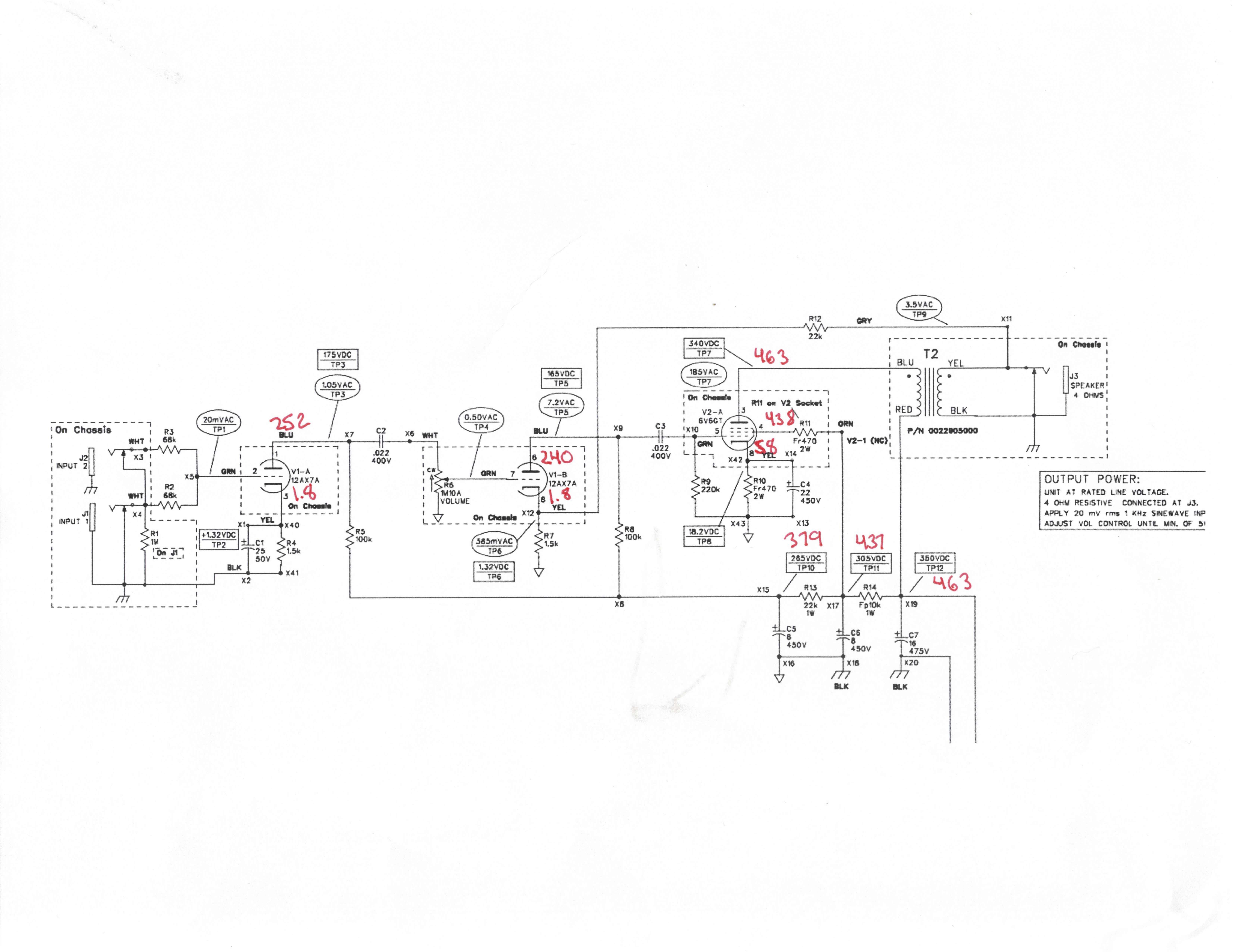

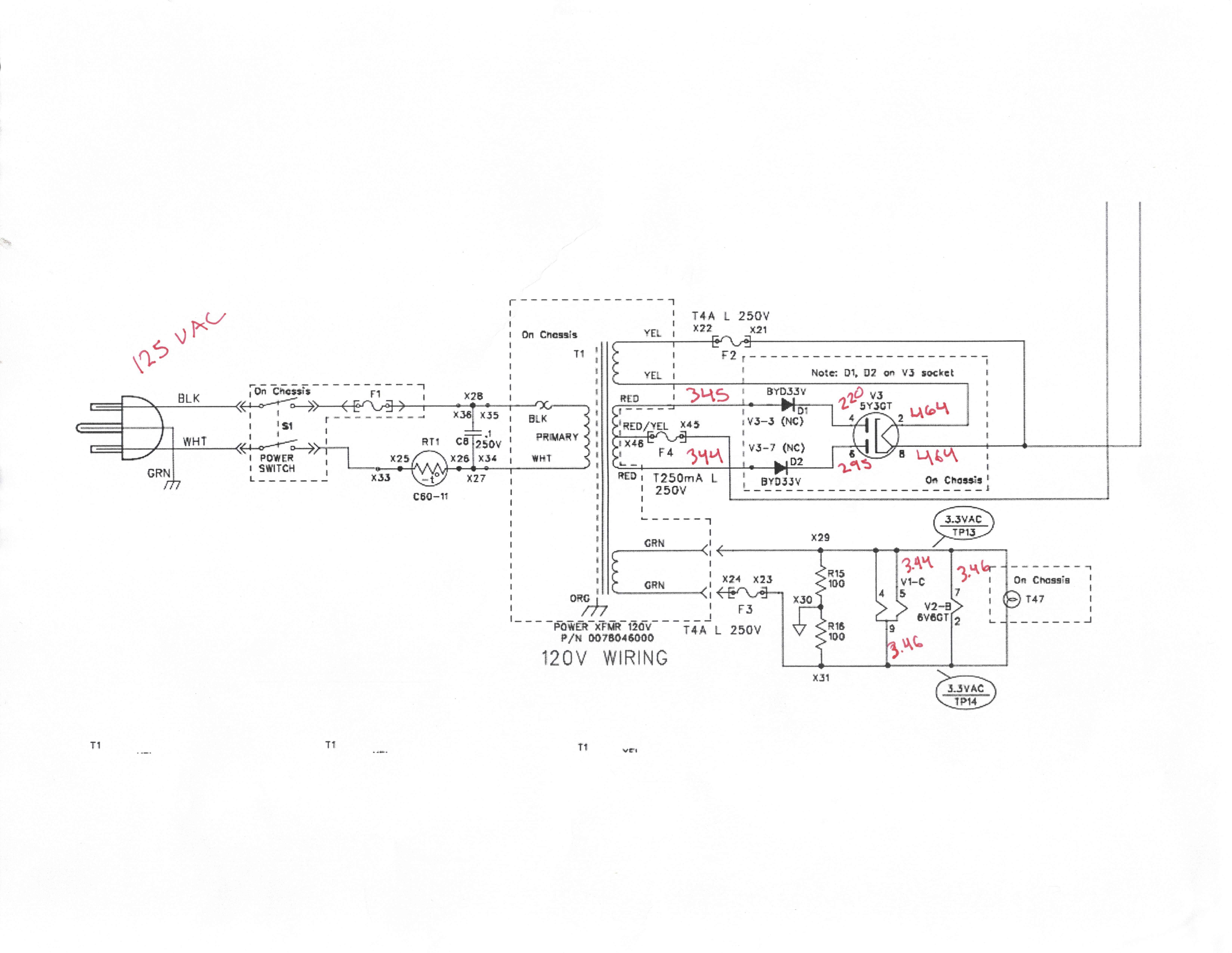

Here is the schematic I am using. I have it all apart at the moment but will try to update with my values vs schematic values.

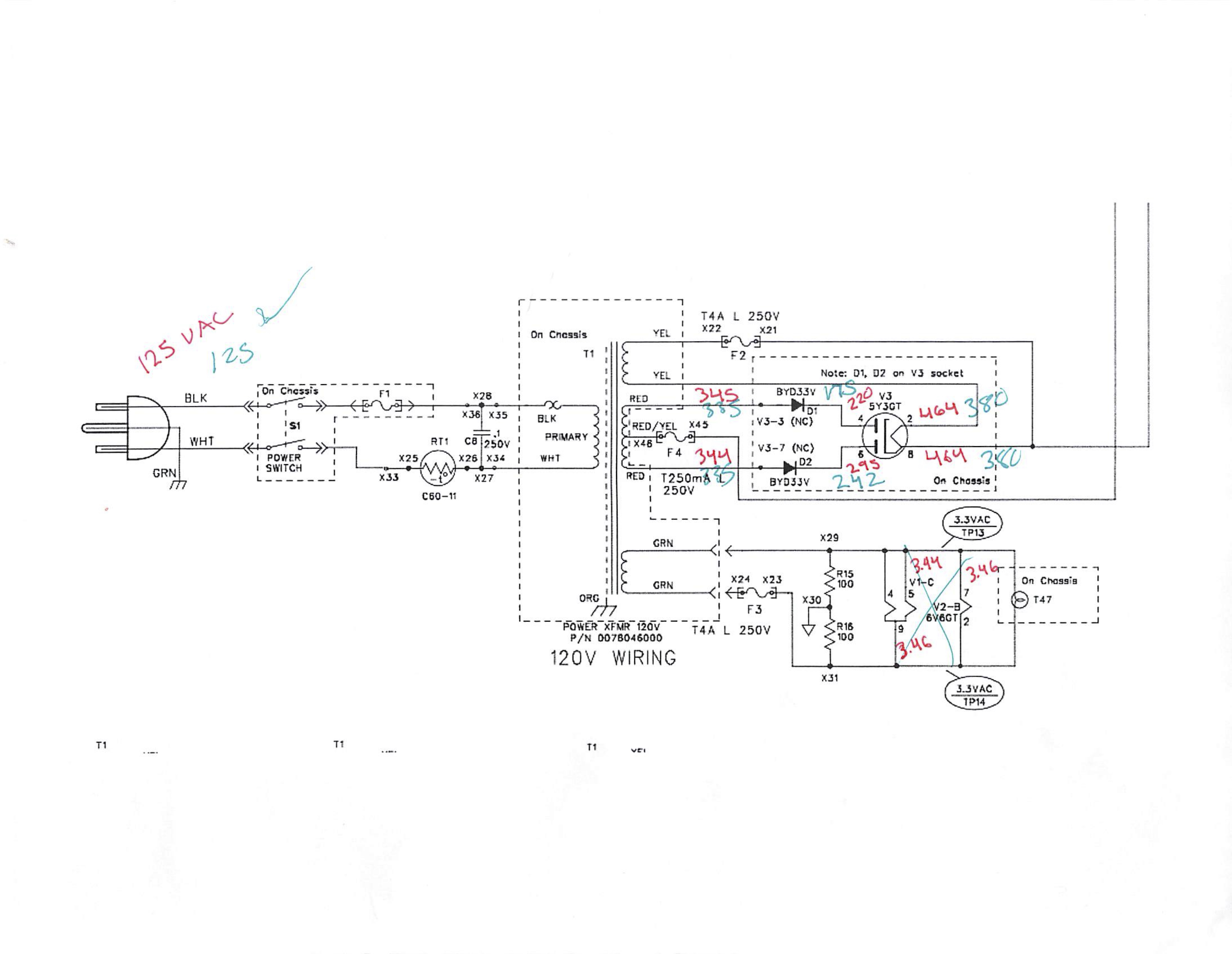

Hopefully he will verify what the part # is on the power transformer. If it's the 100v then the amp came from Japan or S. Korea.
It should be this one for US 120VAC   P/N   0078046000
If the pilot lamp is working then there is filament voltage to the tubes,, but what is the voltage at TP13 and 14 ?

Hey thanks for the feedback everyone. Here are the measured voltages as of a few minutes ago. All tubes were plugged, output speaker plugged in, signal tracer plugged in and volume was at zero.

There's some voltages missing.
Like the plates and cathodes of the tubes, etc.
The easiest way, now that we have the voltages at the dropping resistors, is to measure and record all voltages at all pins on the tubes.  AC at the heater pins, across pins 2 and 7 on the power tubes, and across pins 4 - 9 and 5 - 9 on the little tubes. And measure DC at all the other pins.

The 5Y3, are the 1N4007 diodes mounted on the rectifier tube socket from pin 3 to pin 4 and from pin 7 to pin 6?
Pins 4 and 6 should not be 32dcv difference.

Can't attach these for some reason but here are my after work measurements. The voltage still seems a little high but I dont know if that's the issue.

How do you get 58 vdc at pin 8 of the 6v6. That would be give over 50 watt for a tube rated for 14 watt.
  • Posts: 10645
Re: 57 champ reissue output problems
« Reply #24 on: December 11, 2024, 10:35:34 pm »
Because he has 463dcv on the 6V6 plate.  :w2:
  • Posts: 10645
« Reply #25 on: December 11, 2024, 10:41:40 pm »
That Fender schematic shows 250acv for each B+ lead. Your showing your getting 345 and 346acv.
We've seen guys get strange voltage readings from their meter because the batteries were low. Change the batteries just to make sure.
You need to take out all the tubes, and measure for acv at pin 2 and then at pin 8.
What do you get?
Offline SEL49
  • Posts: 463
« Reply #26 on: December 11, 2024, 10:48:13 pm »
58V across a 470Ω/2W resistor means 7 watts dissipation. That resistor is going to burn crispy in short order.
Maybe your meter is lying to you.

I checked the voltages with all the tubes unplugged and with just the rectifier and it was still way too high.
Based on the comments about a crispy bypass resistor I checked it again and yes it was bad.
So here is where we are at. I used a 5 watt 1k resistor on the center tap of the transformer to get the voltage down and that helped get it closer to 340. I also replaced the bypass resistor and hey it's back to a "working" amp. Using my external speaker it distorts at around 1/2 volume and you dont really get much more volume the more you increase it. That seems bad from a tone perspective but I need to check it with the factory speaker as well.
The resistor on the center tap seems like a hack and it gets too hot to touch. I could maybe play with the values and move it around but i dont feel really good about it. I think the root cause is my transformer is bad? I couldn't find the fender part number but there are several options for this amp.
Thoughts?
Which transformer???
Good. Now remove that 1K/5W hack and recheck voltages on pins 3, 4, and 8.

« Reply #31 on: December 12, 2024, 07:59:16 pm »
Did you change the batteries in your meter?
Based on the comments about a crispy bypass resistor I checked it again and yes it was bad. ....
.... I think the root cause is my transformer is bad?
What bypass resistor? What does it bypass?
Yes it seems the PT is either the wrong PT or it's gone bad.
Without tubes plugged voltages are usually way higher.

Wanted to say thanks  :worthy1: to everyone that took time to read this thread and provide your input. I'm still a novice at this but learning a bit more with every repair attempt. Ultimately it looks like the cathode resistor was the fault. Everything is back to stock (removed power transformer resistor, original output transformer, etc.)
The final measurements are below and they seem pretty close to spec so I am going to play it as is for now.
So now on to the four silver tone amps that I have been delaying working on :)

There's still something not quite right with your voltages.
Your plates are operating at 23mA, based on a transformer reading of 260 ohms, (which you measured earlier.)
Your cathode is dropping 21V over 470 ohms @ 370 minus 21V for cathode elevation, or 349 V.   So the tube is drawing 44mA.
That means either your screens are using 21mA, or you have a short somewhere, or you didn't get a proper reading of your transformer, or the voltages you're getting aren't correct.
Measure all the resistors around your power tube.
  • Posts: 10645
« Reply #38 on: December 14, 2024, 12:03:29 am »
Looks like it opened up. I was not able to get a measurement on it.
Wait a second, you gave us 2 different K R measurements before, now you say that K R was open.  :dontknow:
Offline SEL49
  • Posts: 463
« Reply #39 on: December 14, 2024, 12:21:10 am »
Look again. He never gave any cathode resistor measurement.
Offline Merlin
  • Posts: 655
« Reply #40 on: December 14, 2024, 04:28:55 am »
He also claims to measure 335V on one side of the BYD33 diodes, and 242V on the other side. I don't know what Delray is doing, but his measurements are all over the place and cannot be trusted.
  • Posts: 10645
« Reply #41 on: December 14, 2024, 08:52:44 am »
Yes he did.
Reply #17, 146dcv and reply #22, 58dcv. Fender schematic shows 18.2 dcv and he now says he has 20.9 dcv in reply #34.
« Last Edit: December 14, 2024, 08:59:39 am by Willabe »
Offline SEL49
  • Posts: 463
« Reply #42 on: December 14, 2024, 09:02:23 am »
I thought you meant resistance (ohm) measurements.
  • Posts: 10645
« Reply #43 on: December 14, 2024, 09:09:18 am »
I didn't care what the value of the K R was. I was going by that if there's a dcv at the 6V6 K pin 8, then that tube is drawing current. And that would bring the B+ dcv down to where it should be with that PT. So it seemed something was wrong with the PT.
We were thrown off track of what was wrong because he posted a dcv for the 6V6 K.   :BangHead:   :laugh:
Turns out it was a blown K R, so no current draw on 6V6, so PT B+ acv was way high, and so it follows that the B+ filter cap string was high too.
« Last Edit: December 14, 2024, 09:14:28 am by Willabe »
