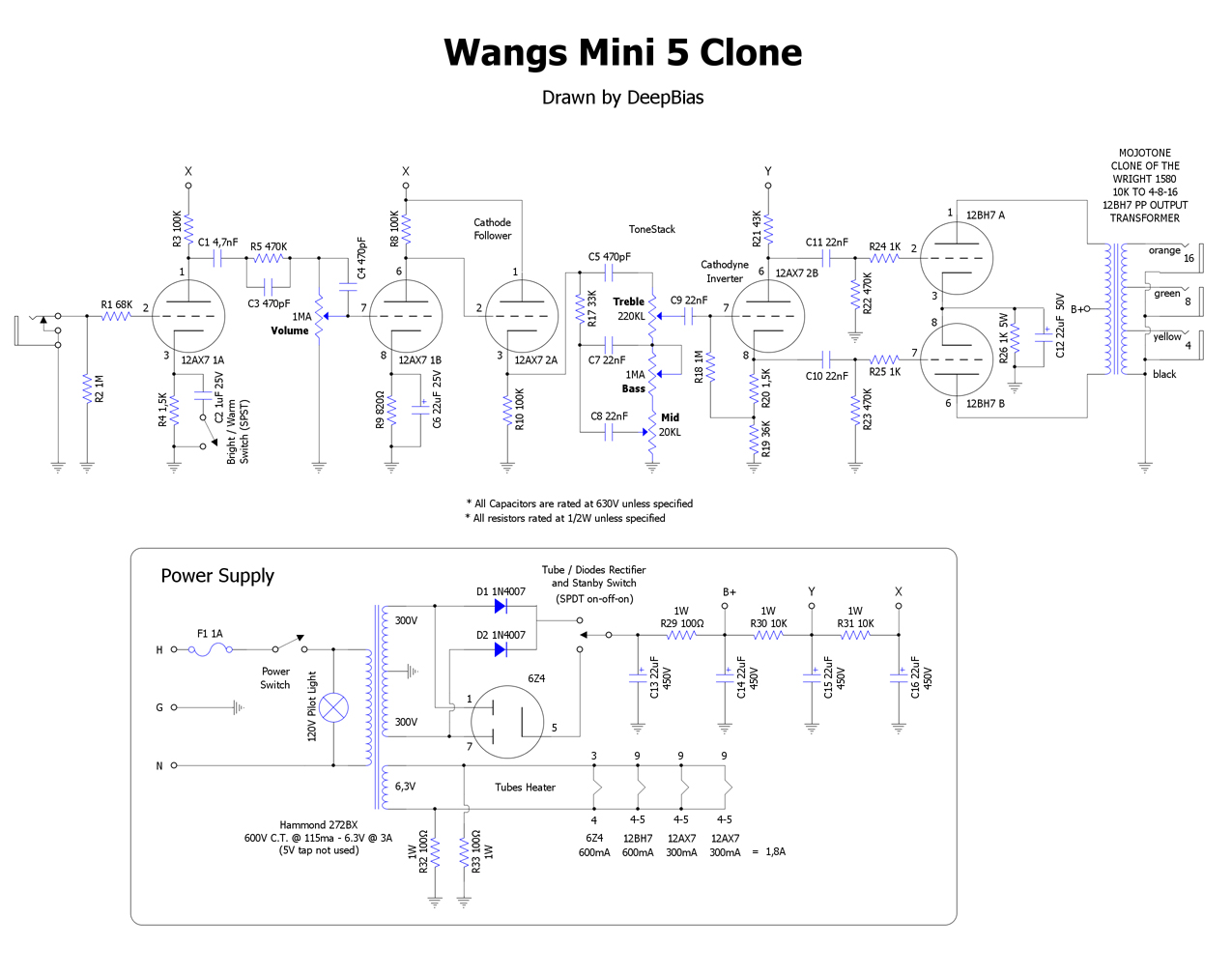

Offline kreidfl
  • Posts: 6
Re: AB763/6V6Plexi amp kit questions/advice
« Reply #15 on: November 19, 2025, 05:00:47 pm »
some pics of the little amp
Some of the mods:
Behind the white wire is a jumper in D-1
I put an external Fuse holder in
I used a 6.3 volt lamp
No Diodes
No resistors in R12 and R13
No  capacitors(?) The ones under the lamp wires
« Last Edit: November 19, 2025, 05:09:20 pm by kreidfl »
