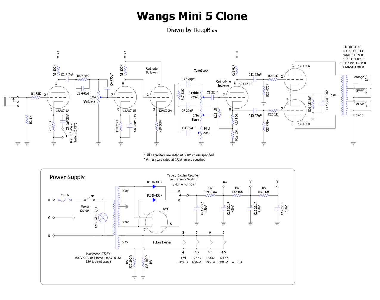

A just built (off of Mojo kit) Princeton Reverb is driving me nuts. Just started testing it, it sounded horrible, and, chasing the problem, narrowed it down to the output section.
It seems that I built a... frequency doubler!
Allow me to point you to the scope pictures at the bottom of this post. First one; "grid inputs"; is taken off of the coupling capacitors coming off of the PI towards power tubes (V5,V6). You don't see bias 'cause probes are AC coupled; bias is applied correctly (tested and scoped).
Second one; "One Input And Output"; has yellow probe intact; and green was moved over to the output jack (running into an 8 ohm load resistor box for test purposes).
When I saw that first; I so did not believe my lying eyes, I had to confirm it with a frequency meter: yep; it's doubling the frequency!
What's even more fun is - and I noticed this accidentally and recorded it - during startup; as the amp comes alive and currents start to flow; it seems that it "wants" to do the right thing - but then, negative half cycles of the output flip to be positive. See for yourselves:
I am driving it with 1KHz, 250mV peak to peak sine thru input 1. Volume pot is at about 2.5 (out of 10).
All voltages (checked with no input signal) are within the spec of Mojo's schematic (https://cdn.shopify.com/s/files/1/0604/9615/0624/files/Princeton_Reverb_SCH_2.pdf?v=1750277593) with the exception of the  Phase Inverter's cathode voltage. They show 15V; mine's in the neighborhood of 50. I thought that was a problem at first; but then realized that it probably is a typo: Fender's schematic is 50V, and my PI output looks good (at the very least; I do see two perfectly legitimate and phase inverted signals past PI's coupling caps). Just to be sure; I checked and re-checked all resistors in that circuit's node as well.
I have attached the schematic with my measured voltages, currents, and notes in the relevant section. Measurements were taken with input signal turned off.

Could it be the output transformer? Some strange, weird, non-detectable by DC examination failure mode? Here's why I think this.
I mentioned yesterday that I accidentally stumbled upon this: if I lower B+ to ~200V and set the bias to -8.75, my output looks okay. It even sounds okay-ish (but of course weak and .. 'farty'?).
The reason why I started lowering B+ voltage to begin with was to examine plates with my scope, which can't go past 300. I figured; if I can manage the thing to run at 200 - 250 (without the rectifier giving up), I can actually look.
Well, I did - deliberately and systematically - today.
What I *expect* to see is the push pull - ie, one is running, the other is cut off, and then they "swap".
Instead, I see what I show in "Both Plates" attachment. Notice they're in phase, and very jumpy (my camera captured several refreshes on the scope's screen)?
This to me looks like a smoking gun. I am in some weird single ended mode there - even though this signal is good frequency wise. Because everything else component wise is good, by elimination, it *must* be the OT...
Another reason I am suspecting OT is that at normal B+ voltages (390 B+; ~20mA idle current bias) there is no effect if I swap the OT's plate leads
Some weird gremlin aliens non-detectable with DC analysis of OT? That's my logic.
Whatdd'ya think?

« Reply #7 on: November 16, 2025, 08:47:26 pm »
... this might be my smoking gun.
Putting OT's primary (blue/brown) on the LCR meter (unsoldered from tubes' pins of course) gives me 9.5 millihenries.
My tranny is Mojo - they don't publish the spec sheet for it; but! Hammond does. Spec sheet for 1750E which is a drop-in for Fender Princeton Reverb OT shows 24H at 1KHz. (for their 1750E). I am 3 orders of magnitude off!
I have another OT - for a SE amp, 5k impedance / 25watt. Just for **its and giggles, hook that up to my LCR. That one is 15 henries.
So I think I am onto something here.
Offline fidot
  • Posts: 6
Re: Mojo Princeton Reverb: output section turned frequency doubler
« Reply #8 on: November 18, 2025, 12:50:14 pm »
All is well in the world.
Replacing OT fixed this mess :) Aliens evicted; and guitar noises abound :)
