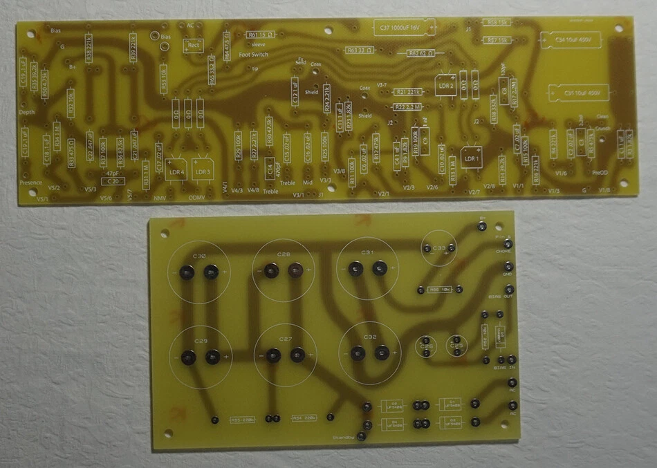

I'm looking at building a single channel 1U rack preamp based on the Soldano SLO100 overdrive channel. I'm fairly new to circuit modding, but have soldering experience and built an Egnater seminar amp without issues.
The Rob Robinette SLO Nakid circuit seems better suited for this than the original circuit, so I'm planning on starting with a turret board rather than a C3 SLO PCB. I'm torn between turrets and eyelets and open to suggestions—I see most people seem to favor turrets. I'll have a PCB available if that would be an easier starting point for some reason.

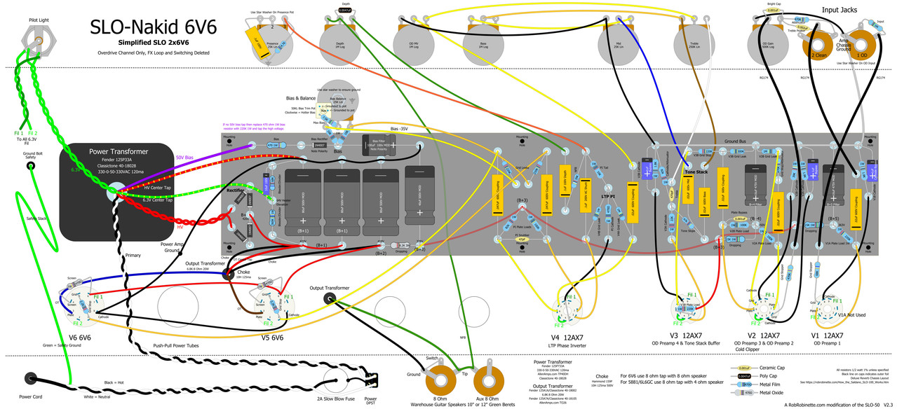

First step would obviously be deleting the power section. I have some questions about where to go from there, however. Here's a crude mockup with the power section removed:

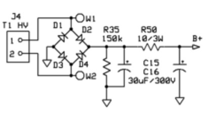

1. For a PT, I'm looking at the Hammond 261C6 (secondaries are 250VAC 45mA and 6.3V 1A, 1.625" wide). Would this be adequate for the 4 preamp tubes in this design (assuming V4 will be an output buffer stage)? A similar project I saw online using this transformer used the following full wave rectifier circuit which I believe outputs ~350VDC:

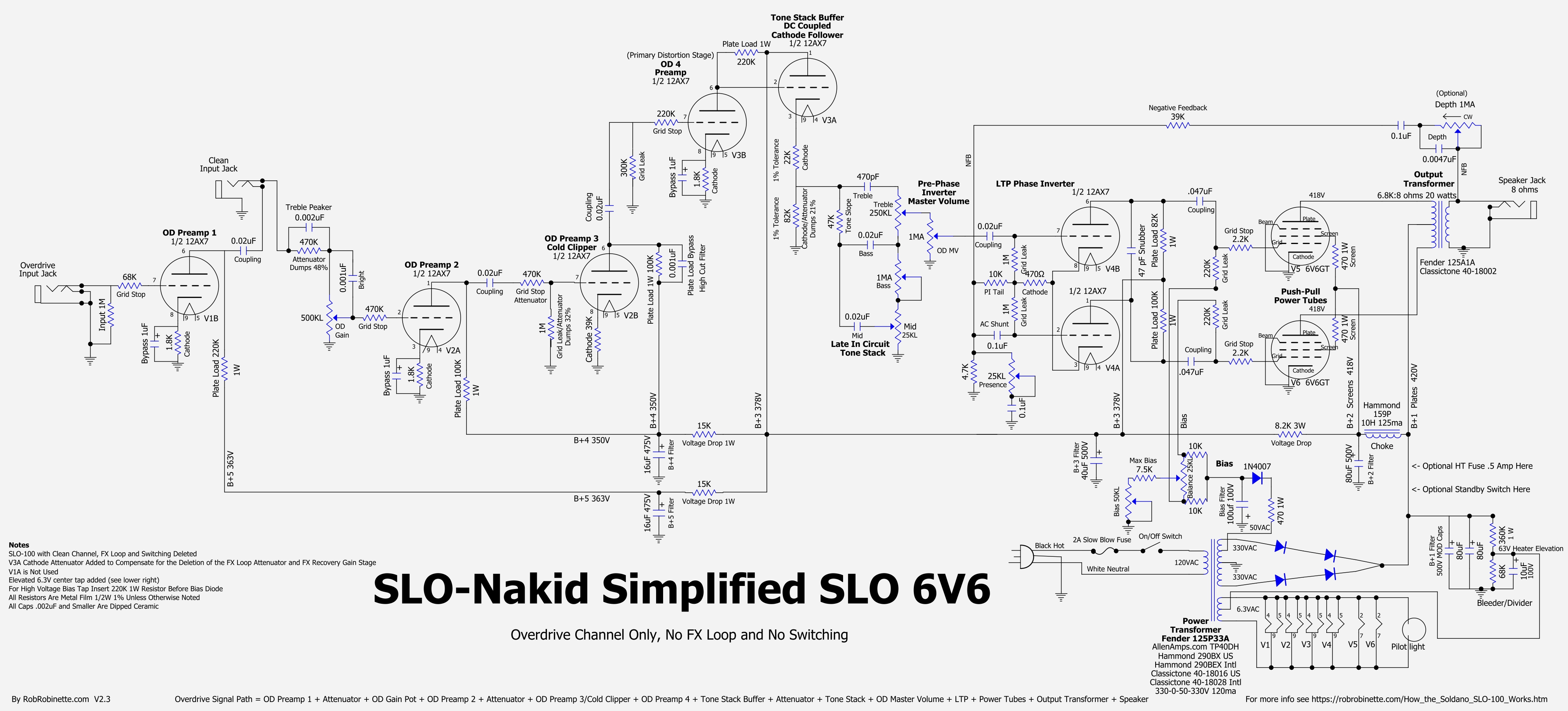

The SLO Nakid schematic shows preamp plate voltages ranging from 350V to 378V so I'm concerned about this transformer being underpowered.
2. What would a V4 output buffer look like in this circuit? I know from experience that the Soldano SP77 output impedance is higher than ideal (~77k unbuffered I was told) and it gets loaded down when switching in effects units. The Soldano X88R doesn't have this issue, so maybe adopting its output stage would be sensible.
3. What kind of filtering would this circuit need as a preamp only? I see the Soldano SP77 preamp uses 2x 30uf 450V and 2x 10uf 360V, while the Soldano X88R preamp uses 4x 16uf 450V and 2x 40uf 450V caps. I have another 1-channel high gain rack preamp that uses 4x 47uf 450V and 2x 330uf 400V. How would the power filtering layout need to change in preamp-only configuration?

If you are using 4x 12AX7 @ 300mA each for heaters then you may need more heater current than a Hammond 261C6 transformers 6.3V at 1A can deliver
Although you could run the 1st input 12AX7 only with DC heaters from the Hammond 261C6 to get 600mA DC heater for that one tube...
Then a separate 6.3V 1A to 1.5A transformer to run the other 3 tubes on AC heaters?
