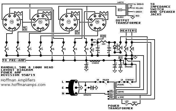

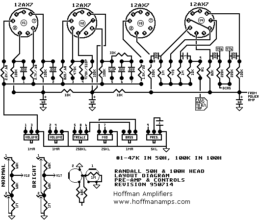

My original layout diagrams for these amps are on the library page
They are split into pre amp and power amp
