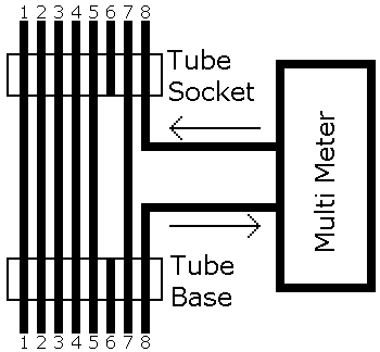

Hopefuly a quick question. I built a bias current checker that will not read current (ma). I put it together using Dougs plan, with one difference. I used sheilded cable twin conducter and used the two wires instead of the braided shield and one wire . Could this be the problem? I am checking el34's into a Fluke 23
dmm set to 200ma. The amp is a Laney AOR 100 combo. Thanks for any help in advance.

You can't use a dual banana plug with that meter to measure milliamps. You need individual banana jacks (or hacksaw that dual plug). Your bias checker must be plugged into the 300ma jack and the common jack on your meter.
Or, you could put a 1Ω resistor across the banana plug. Then plug it in just as if you were going to measure voltage. Set your meter to read milliVOLTS. The number of millivolts you read across the 1Ω resistor is also the same number of milliAMPS flowing thru the resistor.

EL34 typically has pins 1 and 8 tied together.
You should be able to play thru the amp with the bias checker/meter plugged in. Do you get normal sound?
Did you try bridging a 1Ω across the meter leads and checking milliVOLTS?

OK. Now check your bias dongle. Short the two banana plugs together. Then check for zero ohms from the female plug pin 1 to the male plug pin 1. Repeat for all 8 pins. All readings should be zero. Are they?

Should work. What are we missing? Got another meter?
Try this. Connect the dongle as if you were going to check bias but DON'T CONNECT BANANA PLUGS TO METER. Just leave the banana plugs open.
Can you play guitar and make a sound thru the amp like this?

I disconnected the dongle from the meter and the guitar still plays trough the amp.
Well, that's just wrong! It can't be wired right. You have continuity from pin 8 to pin 8 somehow. You didn't tie pin 1 to pin 8 inside the dongle, did you? What's your shield connected to? Hopefully nothing.
Take it apart and look for the culprit.

Thanks sluckey. I am looking at the bias checker connections right now #8 pin clockwise from the alignment pin same for the top. I can ohm the banana plugs and it indicates infinity zero. Could it be the design of the old Laney amps. this just doesn't make sense.

This may be stupid , but here goes....this is what you stated
"I am looking at the bias checker connections right now #8 pin clockwise from the alignment pin same for the top."
If that statement , that you made is literal .....then your connections are wrong ....They should mirror each other. one clockwise from indicator , one counterclockwise .....

I've got some questions just to be sure we're on the same sheet of music:
Did you build only one dongle?  I assume so since it sounds like you talk about it in singularity.
The AOR-100 is a four tube amp.  So, when you tested to see if the amp still played with the banana jacks disconnected, you had the dongle in one socket with a tube plugged into that, and then three other tubes simply in their respective sockets.  Is that right?
Now, when you built the dongle, did you use a socket for the female connections and a tube base for the male connections?
And are the female (socket) connections directly wired to their respective male (base) counter parts, except for Pin 8?  This means that Pin 1 socket is wired only to Pin 1 base, Pin 2 socket is wired only to Pin 2 base, etc.
Pin 8 should not be wired across like this, but rather one wire from your twisted pair lead should connect to the Pin 8 socket and the other should connect to Pin 8 base and their respective ends should terminate at individual banana plugs.  Is that what you have?  That's what it should be, but it seems that yours can't be like that.
Does the subject tube's heater light up when the dongle is in use and the amp's on?
With the dongle completely unplugged from everything at both ends (meter end and amp end), double check continuity between each dongle socket pin and it's respective base pin.  Each pin should read zero resistance from socket female to it's respective base male underneath, except for Pin 8.  So, you'd measure from female Pin 1 to male Pin 1, and repeat for each pin pair around the dongle.  The Pin 8 pair should read open or infinite.
Last question... what did you do with the shield?

It's too simple for the grief you're having. Are you sure you don't have pins 1 and pins 8 confused? Looking into the male end of the dongle, pin 8 is CCW of the key notch and pin 1 is CW of the key notch. And, looking at the female end, pin 8 is CW of the key notch and pin 1 is CCW of the key notch.
If it's wired like this, it should work unless maybe you have some goofy EL34s that have pin 1 and 8 jumpered internal to the bulb.

Thanks everyone for the input. OK here goes. looking from the top of the female socket, starting from the alignment pin going clockwise pin 1,2,3,4,5,6,7,8. Looking at the male socket from the bottom from the alignment pin going counterclockwise pin 1,2,3,4,5,6,7,8. If I ohm the banana plugs there isn't any resistance. Checking the pinouts 1-8 all check good indicating resistance. One wire connects to the top of pin 8 female, one wire connects through pin 8 male
soldered to the bottom of the pin. The shield wasn't used. I have built only one bias checker and my amp is a four tube model. When I use the bias checker the heater lights up on the tube it is being used on. The #8 pin does read open through the banana plugs. I am using standard el34 made by Ruby Tubes.

No    You need to look at the bottom of the female (where the connectors are ) you may have one or both backwards
If you look from the top of the female the first one clockwise would be #8 not #1
you look from the inside, the connection side.....is that what you did ?? and remember the male end is CCW from inside
NO NO NO! That's backwards. You actually have the banana plugs connected to pin 1 on the tube.

I took the unit apart and resoldered. You were correct, I had the #8 pins connection soldered to the #1 pin. The male base does no have numbers on it. I took an old el34 tube that does have numbers on it and compared. All is working fine now . Thanks for your help. This is the best forum on tube amps out in cyberspace.
                                                                               Soundcarver
