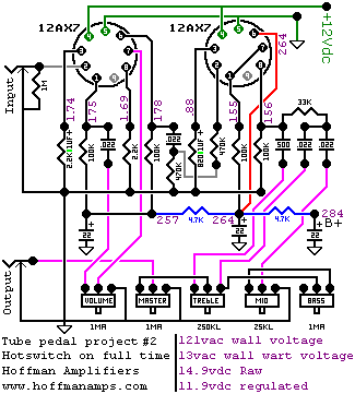

I'm working on the tube preamp and couple of questions raised by studying it :
What is the output impedance ? I want to add a balanced output by using the LL1527 Lundahl transformer and I want to be sure that I can use that.
I saw a difference between the schematic and the layout. There is an additional capacitor 0.027µF and 470K resistor on the schematic (grid to plate V2-A tube) compared to the layout. Is there any reason for that ?
I’m going to use a power transformer able to deliver 206 Volts on secondary. Is that enough to power it ? In that case, do I have to change the 4.7K resistor by another value ?
Is transformer with a 230 Volts secondary is mandatory ?
Looking in the out jack, I see a 1Meg, a 250K, another 1Meg, a 100K.....
They don't all add up. And there's other parts. And half that stuff is variable. But output impedance will generally be over 100K.
It will work fine through a short wire to a 470K+ input.
Since it is hard to get a transformer above 50K, this is NOT suitable for driving transformers.
Also: 12AX7 is -not- a good transformer driver. In Real Studio Gear you use at least both halves of 6SN7, and I have used two 6V6.
They can't arrest you for using 206V. You probably could not hear the difference. I would not change resistors.
Huh. Interesting. Should make quite a difference. One way may be better for some users, the other way for other users. Put the parts in, then try with one lead cut, see which way works best for you.
> I don't want to make any mistake.
Make mistakes. That is the best way to learn. 230V/206V is not a mistake. LL1527 hanging on 1Meg pot "is a mistake" if you want the very excellent response a LL1527 is capable of... but the trimmed bass and strong midrange may be a good guitar sound. Or maybe not. Depends a lot on what kind of sound you like. Many "Classic Guitar Amp Sounds" -were- "mistakes" which sounded good. If your mistake sounds bad, make more mistakes. Just keep track so you don't make the same mistake more than 3 or 4 times.

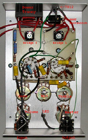

I've been away too long, and finally got around to completing this build (Doug's Tube Preamp Pedal) which I started 2 years ago. I also haven't done any tube work since then, so thanks for bearing with me and my newbie questions.  :BangHead:
I corrected a few mistakes I made and still have a few things to work out. I can hear some hum and the volume varies with the Master Vol pot, but nothing from the volume pot. No signal is getting to/passing through the circuit.
First of all, my voltages are nowhere near the readings on the wiring diagram. The power supply has been wired according to the schem and wiring diagrams, which agree with each other.
These are ok
13 vac wall wart = 14.09 vac
14.9 vdc raw = 15.38 vdc
11.9 vdc regulated = 11.86 vdc
B+ Doug - me vdc
284 - 2.57
264 - 2.48
257 - 2.39
Guessing this should be fixed first and will check solder joints. Component values are OK.
Second, these component values differ between the schematic, the wiring diagram and the photos.
             The schem shows V2a Pin 2 with a 470k resistor --> .047 cap -->V2a Pin 1 & 7. The wiring diagram shows no cap at all. The photo shows a .022 cap going directly to Pin 2.
I just need a little help getting started on the right path.   :help:

Gotta fix those B+ voltages first. I would suspect the toro PT is wired incorrectly first. With dual primaries and dual secondaries, phasing is very important.
Just to the left of the socket I see a resistor going straight to pin 2. That .047 cap and 470k resistor are mounted directly on the socket. Schematic and photo are in agreement. The layout omits the .047/470K between pins 2 and 1/7.
