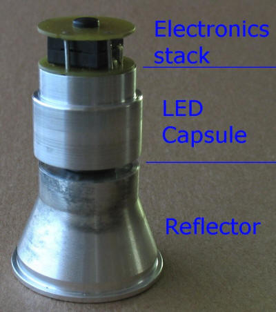

« Reply #6 on: July 01, 2009, 10:13:44 am »
I have a long piece of it in my shop.
I use it for the prototypes that I show to the machine shops and other projects.
That gives me a better idea of what to pay.
I would think a selling price of about $10 is a fair price for a custom cnc'd part like that.
Here's a pic of the one I am showing the machine shops.
It's two diameters and bored out hollow on the back side.
Offline TubeStake

« Reply #7 on: July 01, 2009, 07:03:55 pm »
Ah-ha...
Is the capsule and the circuit/switch stack all held in compression between the butt end of the reflector the black plastic Marwi end cap (I didn't see any added set screws in your photos)?
$10 would be a no-brainer as opposed to making my own...

I set up a web page that shows how the whole thing gets put together inside a Marwi light.
http://www.el34world.com/Misc/bike/BikesLights37.htm
