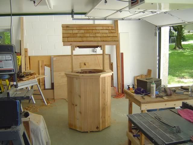

I do a lot of wood working and I will not use that glue
I did a test on gluing two pieces together
Tightbond was the best the glue held the wood broke
I did a dry wall repair with the G-Glue works good
my last project
