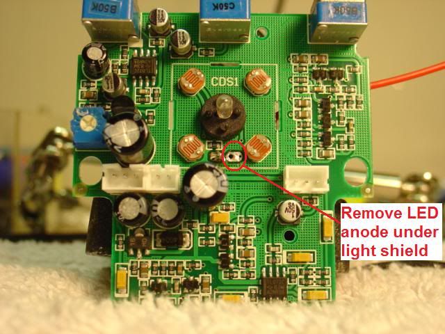

I found these pics and mod info online. Wasnt easy to find. This pedal sounds pretty dam nice to me
I gave up the idea of spending $300.00 for a Deja Vibe 2
Volume Boost Cure

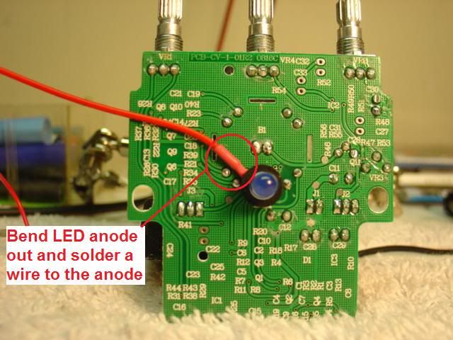

To fix the slight volume-boost you add a 100k or 120k in parallel to the existing 47k in the feedbackloop of the output stage (Tl072 IC on the bottom right on the PCB.
Put the 100K resistor between pin 7 and pin 6

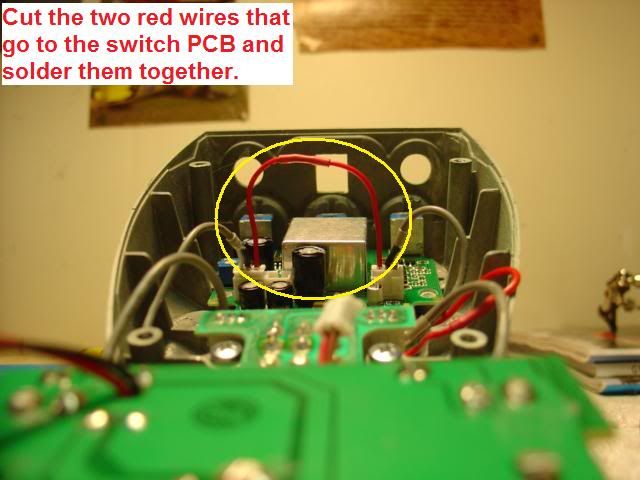

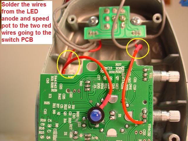

Delay cure: The LED will pulsate and the 2 second delay in Vibe will be cured.  The B+ is rewired to activate the lamp faster. See pic's

The delay was due to the photo bulb not having any voltage to it before the footswitch is stomped on
This mod cures all that. I just finished mine and man it is pretty cool
