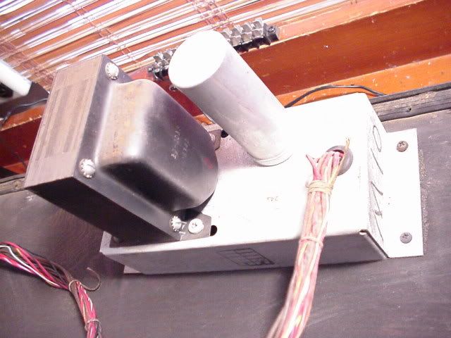

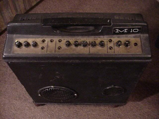

This is pretty beat up but once i can get to the power supply i will know more / It powers up but no sound
I can hear some thing rattling inside the cab itself. Crayon? PS cap? Petrified Twinkie? I hear these are a pain to work on
Personally i think this amp will need a lot of work to get it working and looking decent again

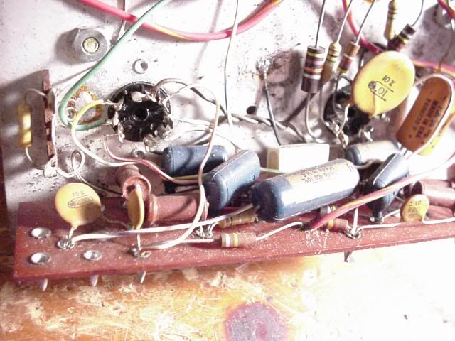

no worse inside than an old silvertone  :grin:  should be a great project!
Re: Magnatone Custom M10 Mess
« Reply #2 on: July 16, 2010, 10:12:14 am »
Those old Magnas had actual pitch-changing vibrato, did they not?
Yup, insides looks like someone swept up the floor in an electronics factory & dumped the sweepings into the chassis. I've actually never seen the insides of one, doesn't look like I missed much!

Looks simple and easy compared to old Gibsons. I've got a '59 Les Paul GA-40 with the componants mounted on BOTH sides of the circuit board. Fun!

The amp has no hum at all.  I really thought the PS cap can would be DOA for sure. All voltages are present throughout the preamp and power section
I need to put an anolog meter on the can terminals and rule out any saturation but the amp is quiet. Maybe this means nothing as far as a cap doing it's job though and may be a problem
I have the bias grid at -16.50 VDC.  The volume is very faint and really distorted and the volume fades out pretty fast
Been going over the cathode voltages and one tube is flashing a - VDC up and down. Im not sure at this moment if it is V1 or not
The bias was -14.65 VDC before i changed the drifted 1K grid resistors (1.5K) to new 1K's. It is now -16.50 VDC
So the bias is not my problem as i thought it was.  Boy i get lost some times tracing all the very tight and over lapping resistors,Caps & wires

If V1's cathode is going up and down, you've probably got a bad socket connection of a dieing tube.  Channel 1 should act just like channel 2 up through the 1st 3 stages.  Do either channel 1 or channel 2 work?  Channel 2 will be simpler to bug out because it lacks the reverb circuitry and that very interesting vibrato circuit.  What the heck are those parallelogram symbols?
I always bug out amps from the output back after I've verified the PSU.  Sound's like the output tubes are sitting pretty.  Look at the PI and it's driver.  Inject a tone into pin 7 of the PI driver and make sure you're good to there, then work on the easier channel.
Personally, I'd change the can cap regardless if it's acting fine.  At some point it's gonna fail so might as well get it while the getting is good.  I'd also replace the diodes with good ol 1N4007's.  That's a dollar in parts that could save you grief later.  Them old germanium diodes sure are cool lookin.  After getting the pi55 knocked out of me on a Silvertone split chassis, I'm a big believer in redundant grounding between the 2 chassis.  Of course put a grounded cord on it.  I'm also a believer in leaving the "life" cap on the line power.  It's real nice to have if you plug into a reverse polarity receptacle.

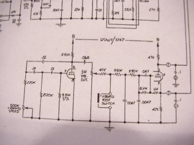

"What the heck are those parallelogram symbols?"
They are varistors! (See lower half of schematic, center) The trem osc appears to be a phase-shift type of oscillator (giveaway: those three caps in a row between the plate & grid of the left section of the 12DW7 lower left) although why there are TWO networks of the 330K resistor and the .0047 to ground right after the footswitch jack is sort of odd.

Plexi, you have the wrong schematic. The one you're using is for the M10A. Here's the correct schematic for a M10...
http://home.comcast.net/~seluckey/Magnatone_Custom_M-10.jpg
I rebuilt a M10A a couple years ago. The power supply is identical to your M10. There may be some useful info on the following link, but keep in mind that the amps have a lot of similarities , but also a lot of differences. The tube layout may be different too, since your amp has a transistor in it. So, stick to the correct schematic.

Just got back on this today. Got the original schematic from the owner. It's going to be a long day
http://s356.photobucket.com/albums/oo5/plexijtm45/?action=view&current=M10.mp4
  • Posts: 5401
« Reply #26 on: July 22, 2010, 02:28:06 pm »
Lo Q videos suck! Just take some good pics. BTW, there's an original schematic glued to the cab.
« Reply #27 on: July 22, 2010, 05:29:54 pm »
That old schematic is a mess. Looks like coffee stains all over it. Im going to take some better actual pics and try something with the small schematic i have
