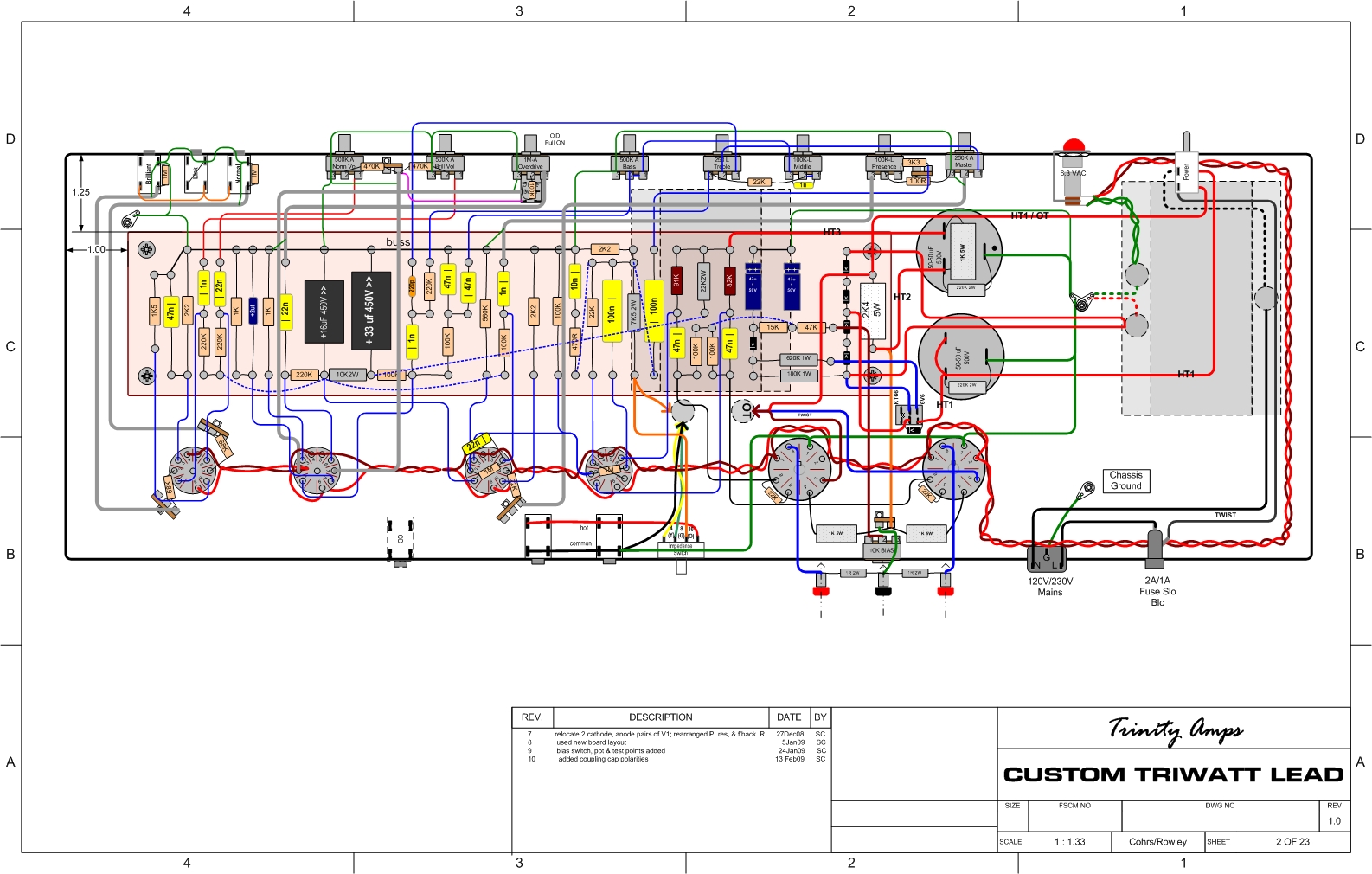

Here's an example of the kind of layout that I (still) need:
I just do the layouts myself now.
Oh, and a detailed "bill of materials" keeps me straight.  You can "roll your own" from Doug's documentation, but it's easier to do that after you've built an amp or two.
Hope this helps,
Chip

Re: A first build
« Reply #5 on: August 04, 2010, 12:07:08 pm »
Nice Layout  :smiley:
I'm not very experienced
but I think it will be better if you change the way the filament winding "cross" the tubes
keep the two wires the same side instead one in one side and one in the other side of the tubes
Kagliostro

« Reply #6 on: August 04, 2010, 12:51:32 pm »
Kagliostro
Not my layout!  I agree in general with your comment about the heater wires though.
Chip

Re: A first build
« Reply #7 on: August 04, 2010, 12:58:23 pm »
Kagliostro
just curious - what is your reasoning for this?

« Reply #14 on: August 07, 2010, 11:02:56 am »
for crying out loud - can somebody elaborate on what the heck the previous posters mean about keeping the filament wires on the right or same side....  I look at that layout and it looks fine to me. i'm fully aware of keepin one side of the filament winding going to the same side of each tube socket... is this what they're taling about?  Perhaps they're talking about physical location of filament wires in relation to sockets, chassis.....    what? Or ...did he mean the way the filament leads are crossing over to the tubes?
Just my take, but I like to have the heater wires come straight down to the tube socket staying together as much as possible and flaring out to the solder tabs from the center.  That layout shows heater wires looping around the outside of the socket.
Does that make any sense?
Chip

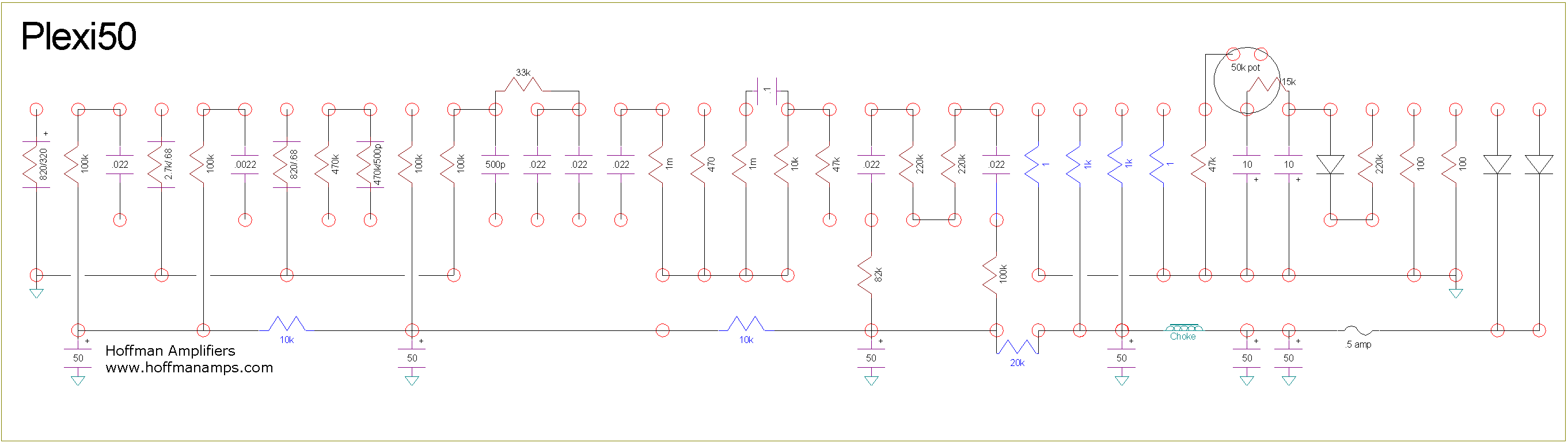

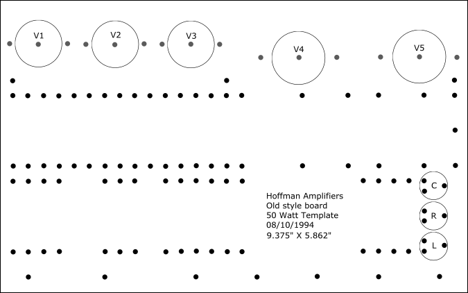

Ok I have a parts list almost complete but I am struggling between the 2 Hoffman 50 layouts.  I think for the most part I understand them but they are different. I have connected points on the 2034 01/08/96 layout (see attachment) please let me know if it looks correct.  It seems that the designations like "V17" would be valve #1 pin 7 and the numerals 1-12 interconnect.  The Hoffman Plexi50 - layout diagram #1 appears different http://www.el34world.com/Hoffman/images/Plexi50Old.gif.  What are the major differences in the layouts as far as how the amp will sound? Is one a dual volume and one a master volume or are they both master volume amps.  The older layout has a bright switch.  I have purchased the older style Hoffman chassis http://www.el34world.com/projects/oldchassis0.htm and have already purchased a bare board so I can lay it out and populate it either way.  Also on the old style chassis i should not need a ground switch and the .047 cap if I use a 3 prong cord as I plan to use the 3 prong receptacle type. Comments or suggestion please.

« Reply #24 on: August 17, 2010, 07:10:37 pm »
Shortfuse,
You are looking at two different amplifiers there.  One is the standard Marshall circuit "1987" Plexi amplifier in a Hoffman layout and the other is Doug Hoffman's 50 watt amplifier he made under his own brand.  The Hoffman 50 has a master volume.  The Hoffman Plexi does not.  I would ask Doug in this thread for his description of the variation in tone between the two.

« Reply #25 on: August 17, 2010, 09:19:31 pm »
Bnwitt that said I wanted to go with the Doug Hoffman 50 (already purchased an original chassis).  I thought that the other (1987) was a newer version of the original as it says Hoffman 50 also (maybe that was just for the board).  Tricky part now is the parts take off, as I think the parts list is for the 1987.  I believe the transformers, choke and tubes are the same looking at both here in the library but the resistors and caps are of different values.  Like I said in the previous post I have already purchased the board Doug suggested so I know it will all fit and then some.  The board I purchased is a Garolite Sheet, 1/8 X 12 X 12 epoxy (a lot more HD than what I have seen in amps probably because it holds the tube sockets also) so it will have to be cut down anyway.  He also has just recently added the old style board template after I inquired about the build http://www.el34world.com/Hoffman/images/2034Template.gif which will help me out immensely.  I may have to do a bit more studying before ordering the parts.  Not quite sure on the all the resistor wattage's.  This is truly going to be a learning experience all the way around but I am really looking forward to it.
