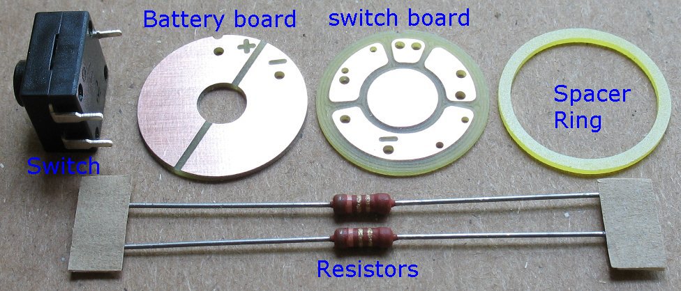

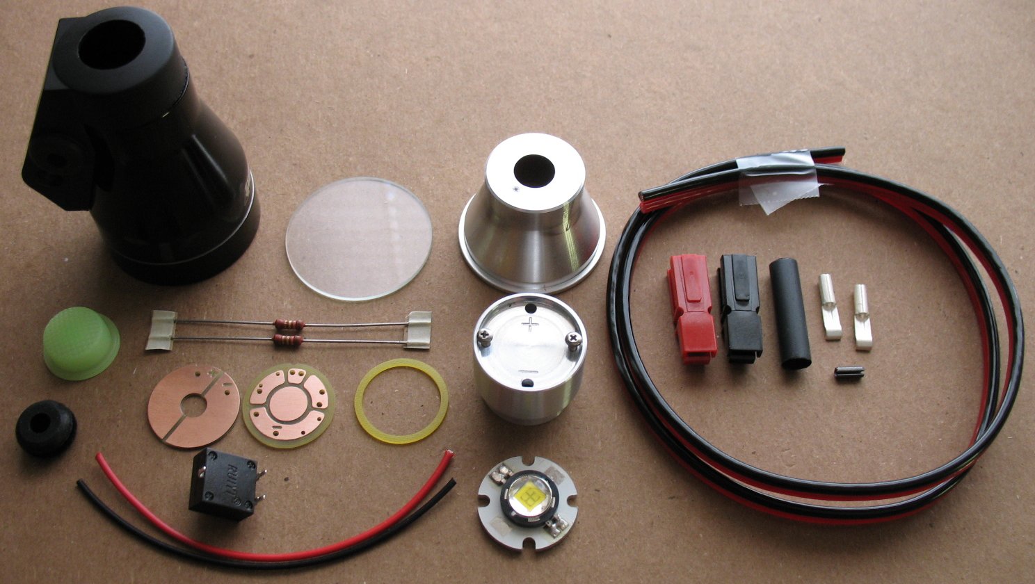

Here's a list of parts I used to assemble the project on this page
Marwi P7 LED conversions The parts pile including Anderson PowerPole connectors
These are the parts needed to assemble the new resistor based driver board.

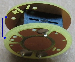

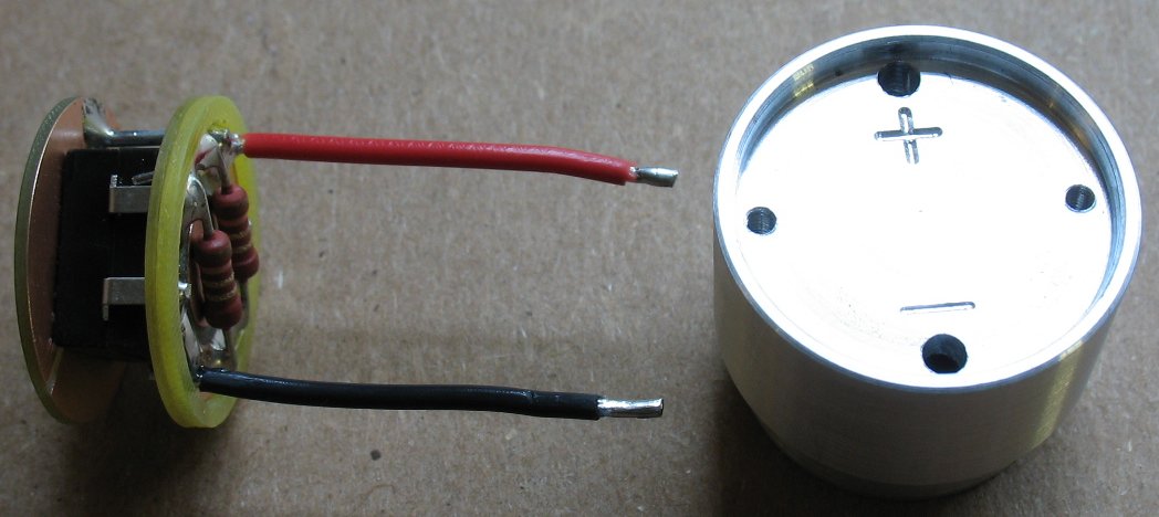

Assembly Tip: Enlarge the hole in the battery board if needed.
This keeps the switch plunger from sticking.
I like to add a tiny bit of super glue to the four corners of the switch to keep it from coming apart.
Solder the switch to the switch board.
Look at the holes in this picture, the switch will only line up one way.
Glue the battery board to the switch with a very tiny amount of super glue.
This keeps the boards lined up properly for the next operation.
The notches (Blue Dots) on both boards should line up.
Make sure you do not use too much glue or you will glue the plunger on the switch.

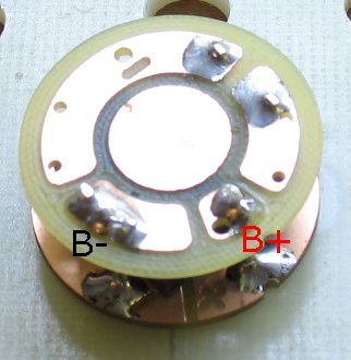

Take a piece of 18ga solid core wire and push it through the battery + and - holes.
The wire goes all the way to the back (flush) of the battery board.
Solder both wires at the Battery board and the switch board.
Trim off the excess battery + and - wires

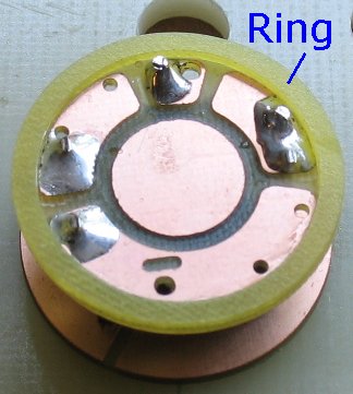

Glue on the Spacer ring.
Use a tiny amount of super glue. Apply with a toothpick.
You can glue on the spacer ring now or after you add the resistors, or after you add the LED wires.
Don't get glue on the copper surfaces that you are going to solder.

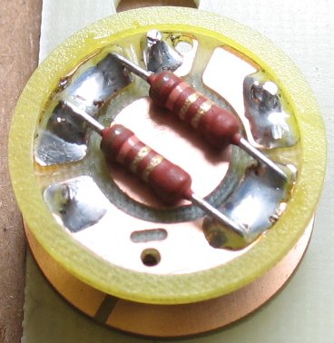

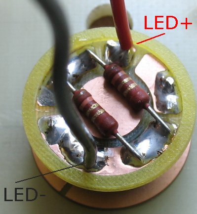

Solder on the 1 watt current limiting resistors.
I designed the board to use two 1 watt resistors, which gives you a 2 watt rating.
The resistance is in parallel, so 2 x 1.3 ohms gives you .65 ohms total at 2 watts.

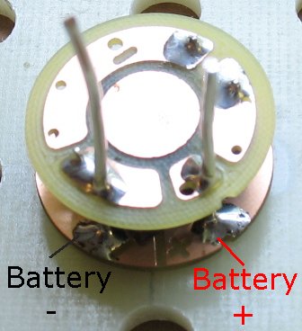

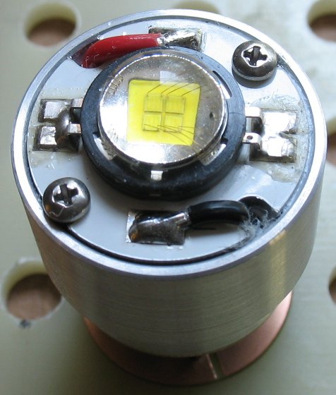

Solder on the LED + and - wires
I sell and use 20 gauge Teflon wire because it is very flexible and has a 200 degree C rating.
The jacket has to be tough to keep from melting or shorting out when it is bent at a right angle.

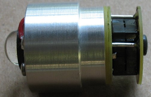

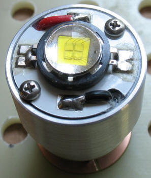

Push the LED heat sink down onto the wires.
Bend over the wires and trim them to the proper length.
The wires should be just long enough to reach the end of the LED solder pads
Pull the heat sink off and strip the ends of the LED + and - wires.
Tin the ends of the wires so they are easier to solder to the LED

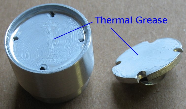

Add a thin layer of thermal grease to the heat sink and the LED.
Don't glob it on, thermal paste works better in thin layers.

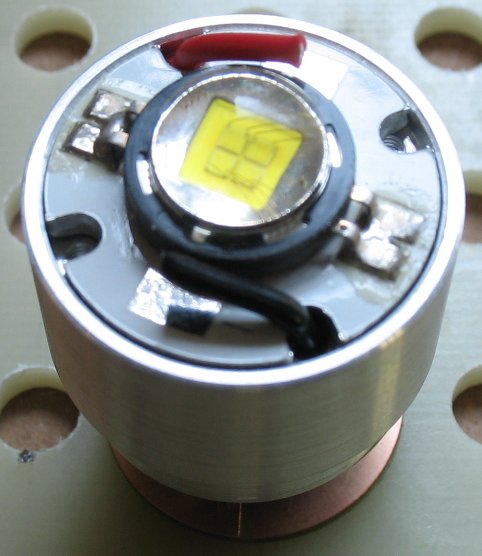

Put the heat sink back on, making sure you get the Red LED+ wire and the Black LED- wire correct.
Screw down the LED and then solder the + and - terminals.
It helps if you add a small amount of solder to the solder pads first.
Use a small screw driver to force the wires down as flat as possible.
If your solder joints or the wires stick up too far, they may short out on the back of the reflector.

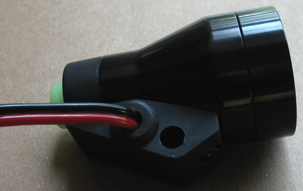

Here's a side view of the completed assembly

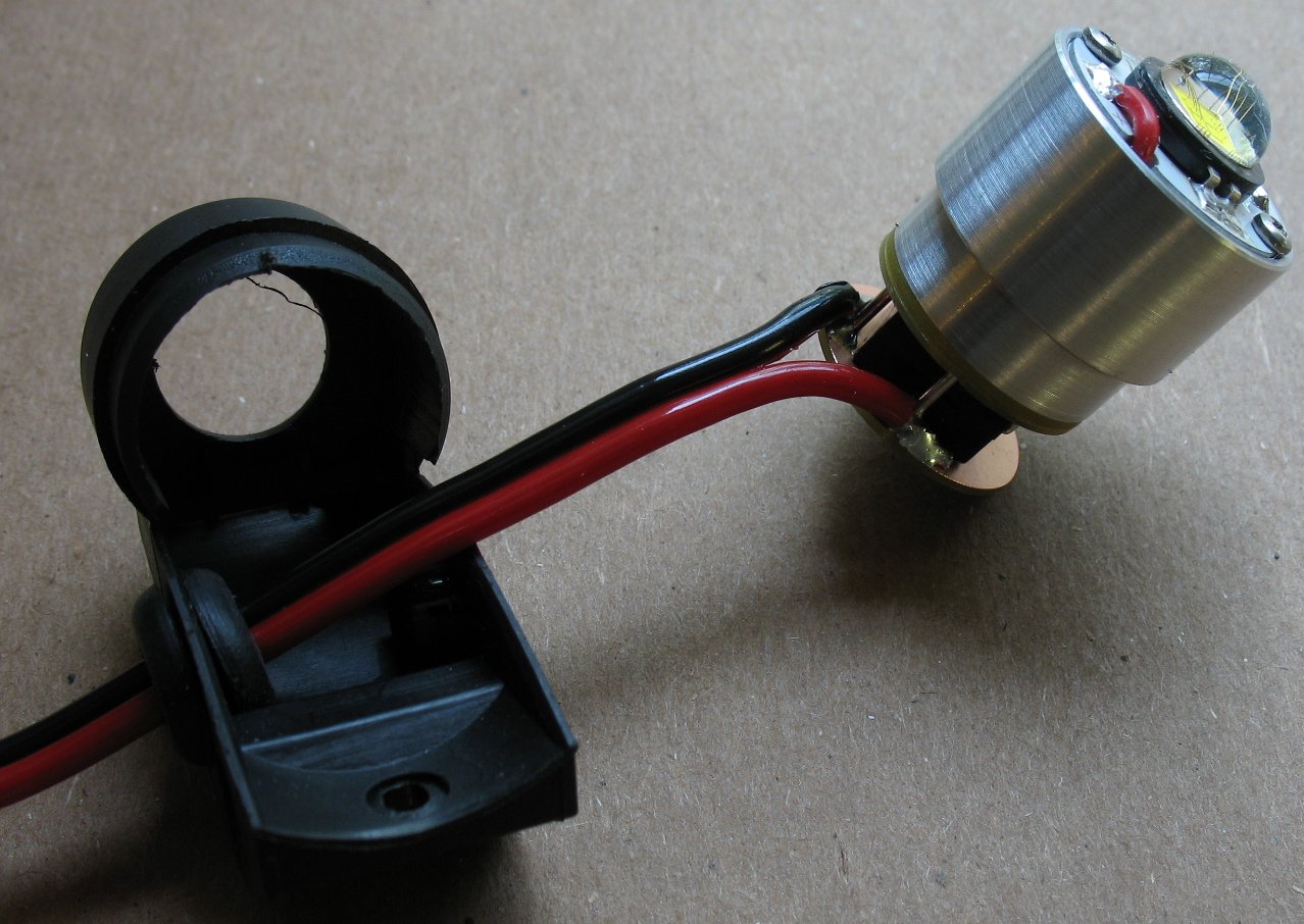

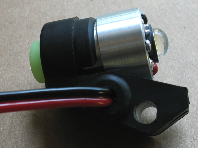

Solder the Battery wire to the battery board. Red is + and Black is -

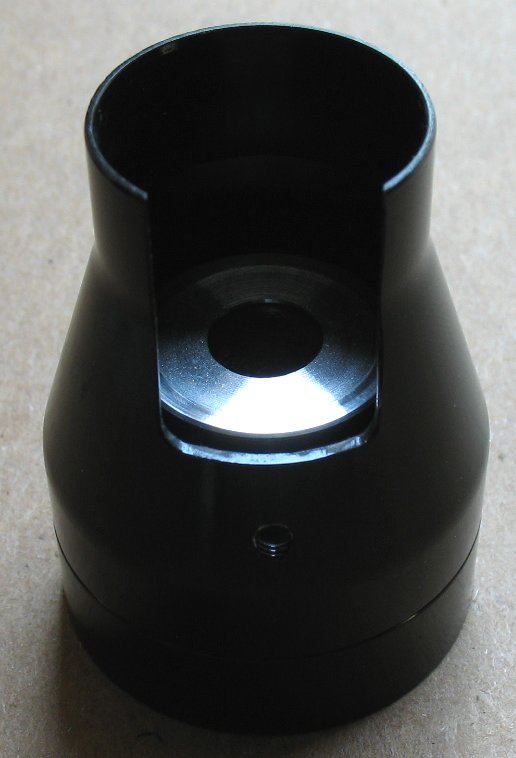

Shove the battery wire through the grommet on the Marwi tail piece.
I install new grommets because the original Marwi grommets are glued on and not re-useable
Push the tail cap button into the Marwi tail piece.
Insert the Led assembly into the tail piece.
This is done by pulling and then pushing on the wire until the whole assemble is in place.

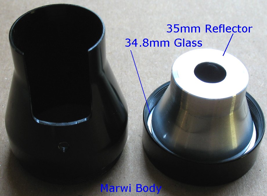

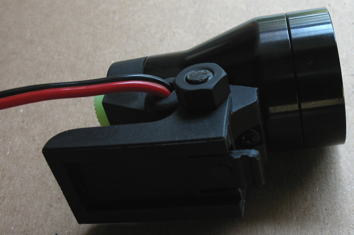

Install the 34.8mm glass into the bezel.
Install the 35mm reflector into the bezel

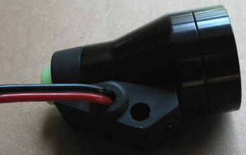

Screw the bezel onto the body
Slide the body onto the rear tail section and secure the two sections with the screw Add a Marwi straight mount to the body.
I am using the nylon Marwi mount kit in this picture.
I am not showing the battery end of the Red/Black 18 gauge zip wire power cord here.

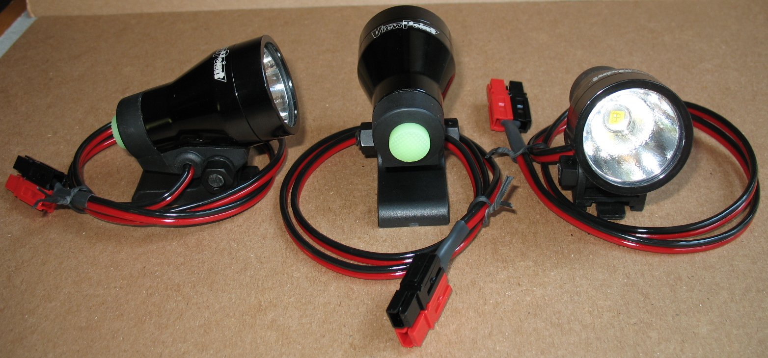

There is a picture at the top of the page that shows 3 completed lights with cords and connectors.
I install 15 amp rated Anderson PowerPole connectors on all my lights and batteries.
