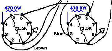

Power Tube Sockets
Fender Service Guide image
   There are two large 470 ohm resistors soldered on the back of the power tube sockets. If you do not have them, you should add them to your amp. Stock resistors are usually a one watt 470 ohm carbon resistor. Most of the time they are not 470 ohms any more because they were under rated and should be a higher wattage. Even if they do read close to 470 ohms I would replace them because I have seen them fail so many times.
 Replace them with a 470 ohm 3 watt metal film resistor and they will be good to go for a long time. Remove them from the tube socket by carefully heating up the tube socket pins and gently pull each end free. Notice that Fender soldered them over the top of the tube socket. This is not a good idea because the resistor itself and the tube socket generates heat.
 Notice in the layout diagram above I have hung them out away from the power tube socket. This method works great, I have never had to replace one of these resistors that I installed. The small 1.5K 1/2 watt resistors are ok sometimes and sometimes they are burned up from the heat. Replace them also if necessary. They do not generate heat themselves so it seems to be ok to mount them across the back of the tube socket. Solder them high up away from the socket just to keep the heat from the tube socket to a minimum.
