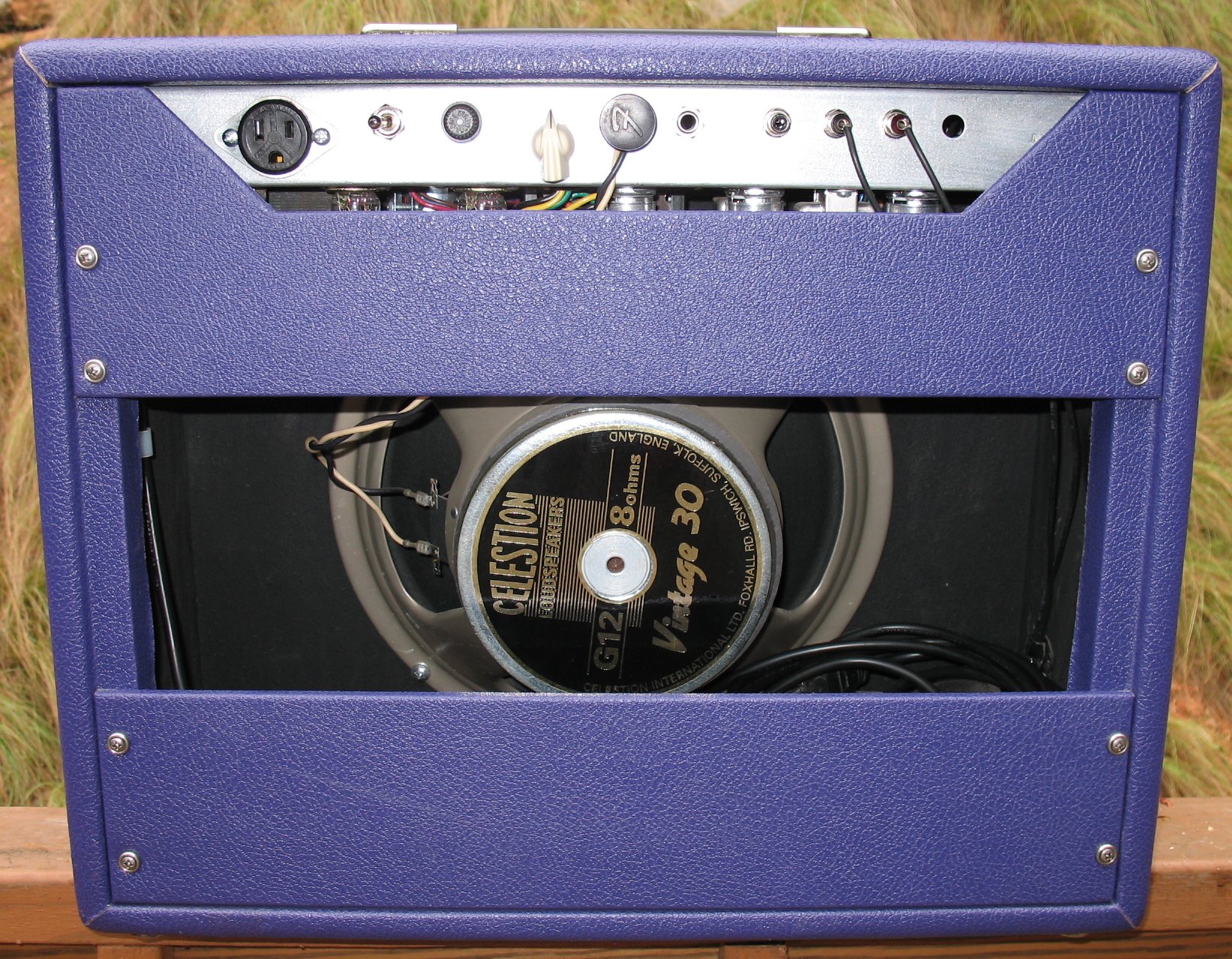

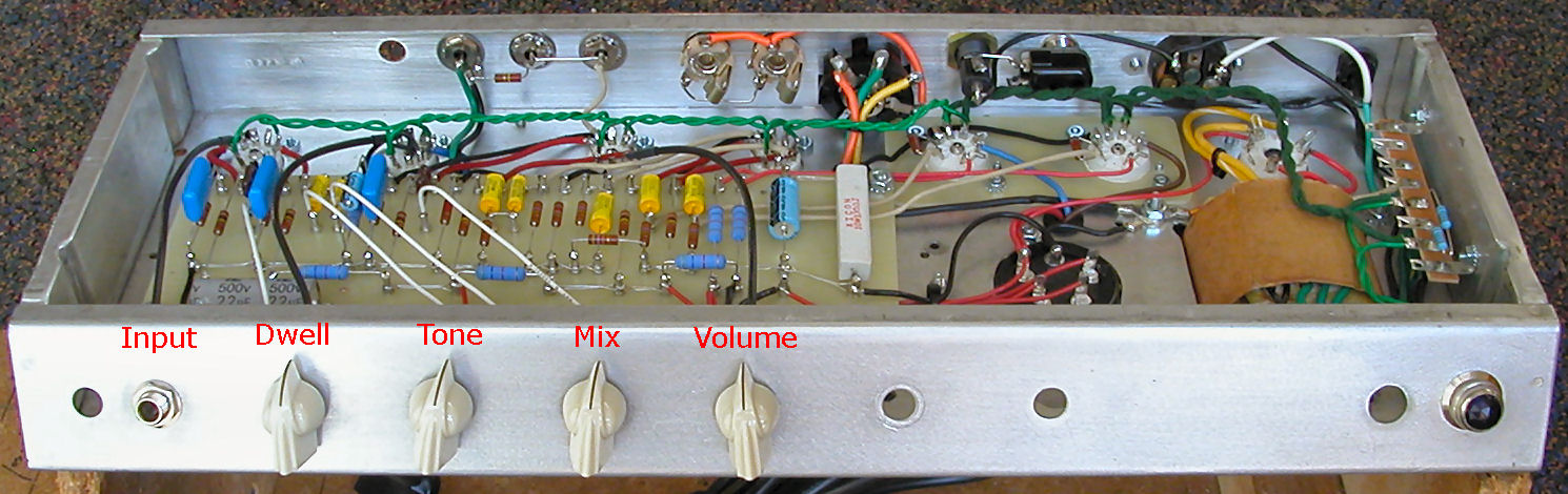

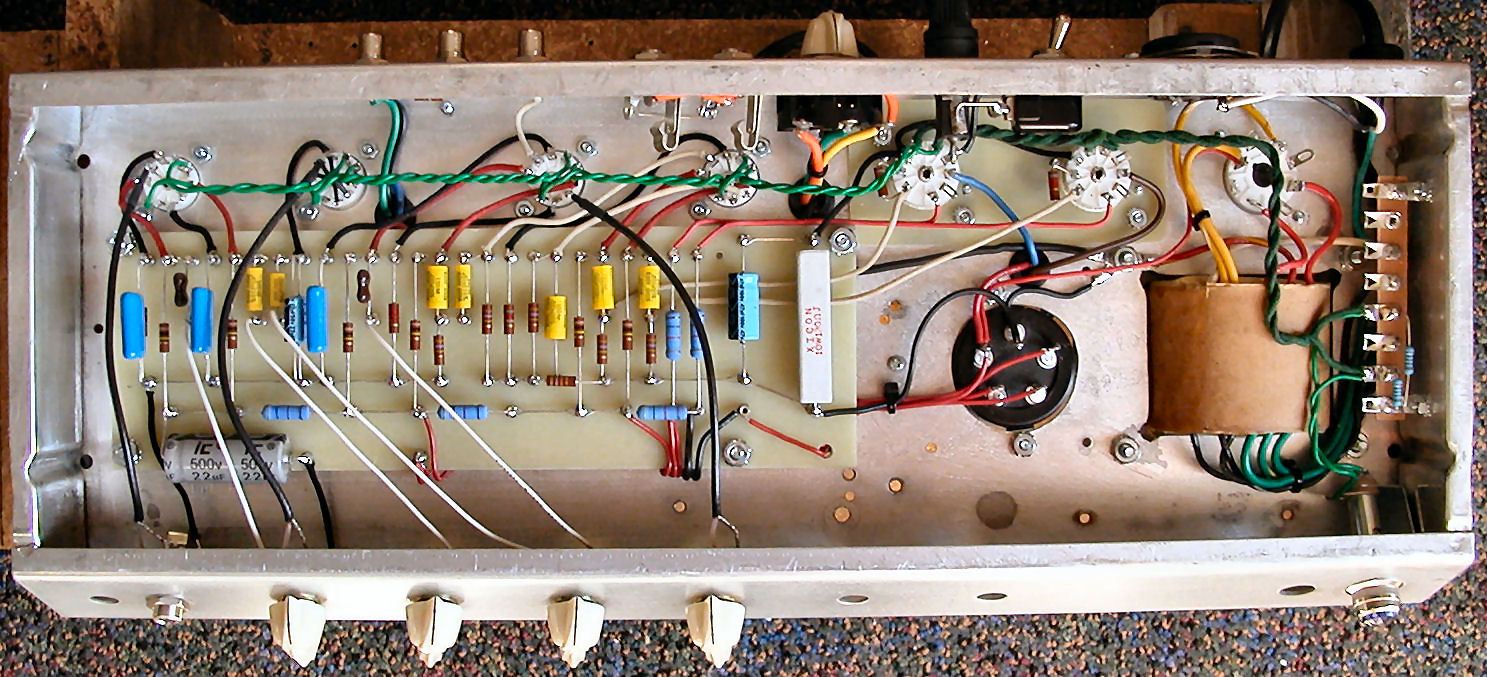

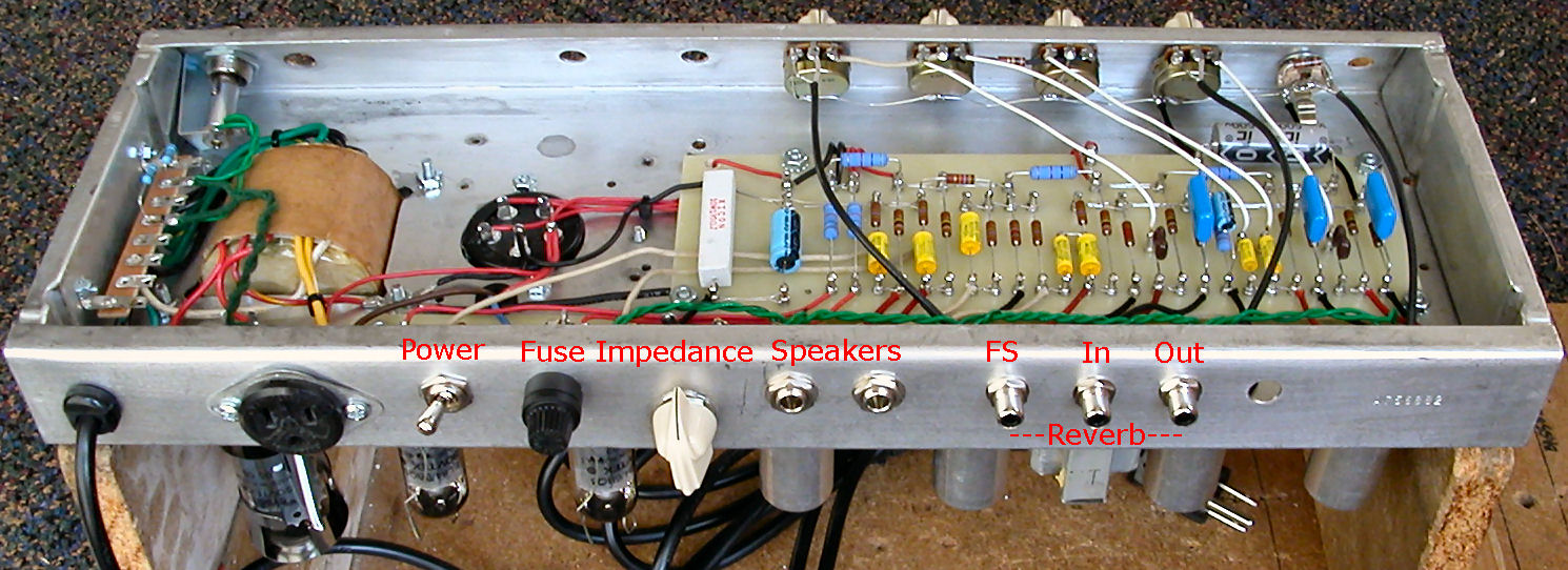

| This is the 18 Watt stout reverb project with the Hot Switch mod on full time.
There is no relay or switch, the second stage of gain is on all the time. For this project, I used a princeton reverb chassis and cabinet that has been through several different circuit boards over the years. It was the perfect chassis to build an 18 Watt Stout reverb in. See the other 18 Watt Stout with Reverb project on the library page for more info on this design. |

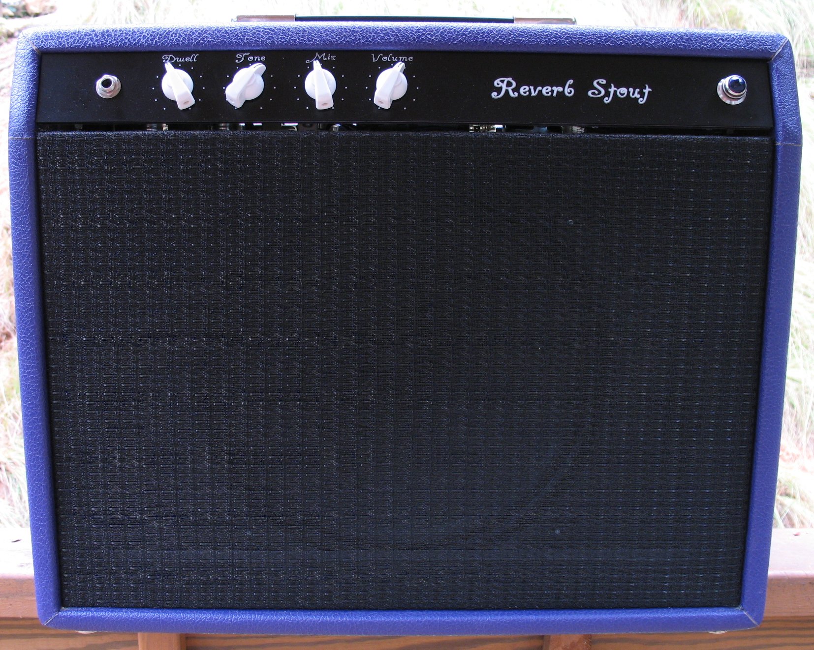

| Update 10/03/2007: I added a faceplate to my Reverb Stout The color is purple. The picture on the right is closer to the real color. |
