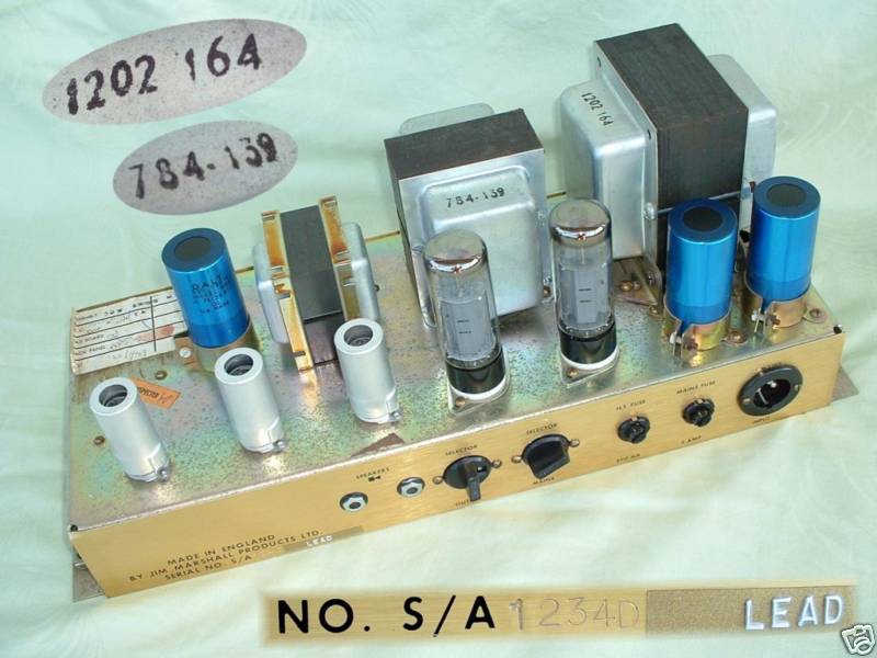

 Hey guys!
What would be the circuit board dimension for the Plexi 50?
I've searched several other places but I didn't find some solid numbers, there are several that goes around 3"x11" something like that.
With this tool is possible to do a very thin cut with around .03mm.
related topics:
http://el34world.com/Forum/index.php?topic=20556.msg216668#msg216668
https://el34world.com/Forum/index.php?topic=20476.msg215697#msg215697
Thanks in advance !

Re: Plexi 50 board dimension ?
« Reply #1 on: July 08, 2016, 09:41:09 am »
3.125" x 11.25"
The actual length is in the Hoffman store page where the boards are sold.
« Reply #4 on: July 08, 2016, 11:43:16 am »
My original has a perfboard that measures Length 11.75" x Width 3.125" x Thickness .125"

« Reply #8 on: July 08, 2016, 06:23:37 pm »
Thanks guys !!
I got the board cut with 3"x14¹/2" , working on the templet now to make the holes for the turrets.
As you can see in the pic I have shaped and sharped(teeth) a special tool to cut the celeron sheet.
Here some pics:

Chassis and layout on the table !
« Reply #35 on: September 12, 2016, 02:35:27 pm »
Hey guys !
Finally I've got some aluminum plate at fair price, got couple pics about how the layout could be, my concern is to not put the cap cans bellow the circuit board, what do you guys think?
After looking at this pic/link, I've added two more pics(layout_02, layout_03) with different layout options. Does this make sense ?
« Last Edit: September 12, 2016, 03:33:27 pm by uki »
https://soundcloud.com/ukiuki
  • Posts: 5391
Re: Plexi 50 ! Work in progress !
« Reply #36 on: September 12, 2016, 03:50:50 pm »
That pic/link mostly follows the original plexi layout. I highly recommend you make your chassis layout look just like that. Better yet, make it look exactly like a real plexi. There are plenty of pics on the net.
I definitely don't like your pics that have the filter caps near the input jacks. A couple of those filter caps have some high level noise and hum on them.
« Reply #37 on: September 14, 2016, 12:27:04 am »
agreed, put the filter caps near the power input section so they are at the source of the noise they're filtering.   Looking good though.
« Reply #38 on: September 14, 2016, 11:09:45 am »
Thanks guys !! I have found this pic of the same type of amp, I'll follow it, the cap can near to the choke is for the preamp section yes?
« Reply #39 on: September 14, 2016, 08:15:40 pm »
Although I don't know the amp, yes that looks right.  Often there would be 2 cap cans each and they'd use the two on the right for primary power filtering and the one on the left for a few stages of preamp filtering, just due to location, Someone that knows the plexi 50 layout a bit better could confirm.  Here's someone's plexi layout that has the same kind of "two cap cans for power filtering, one for preamp filtering" and they do a similar layout except the cap for the preamp is on the turret board.  http://s77.photobucket.com/user/patlinux/media/MetroAmpPlexi.jpg.html
that way the 'noisy' power entry area is cleaned up before even getting close to the power stage of the tubes, and doesn't even remotely approach the input side or preamp section.
