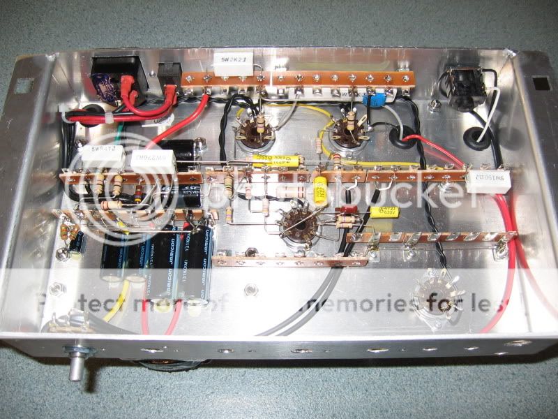

I have been asked to build a new amplifier, so I thought I might post the details of its construction.
The specification was as follows: single channel but with tonestack switching options, 2 x EL84 output valves for a nominal 15 watts. This was essentially identical to one of my earlier designs, so there was a reduced probability of embarrassing meltdowns.
My construction methods were described in some detail in an earlier build description: http://www.el34world.com/Forum/index.php?topic=9027.0 You cannot teach an old dog new tricks, so this project will use very similar methods.

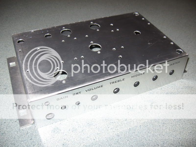

Construction was on a small aluminium pan chassis. The component layout on the chassis top surface was drawn to fit three transformers, the two output valves, and two small-signal valves. A faceplate was already available, so it was used as a template for marking out the front panel. An assortment of drills, files and chassis punches were used to prepare the chassis - surprisingly no blood was lost during this process.

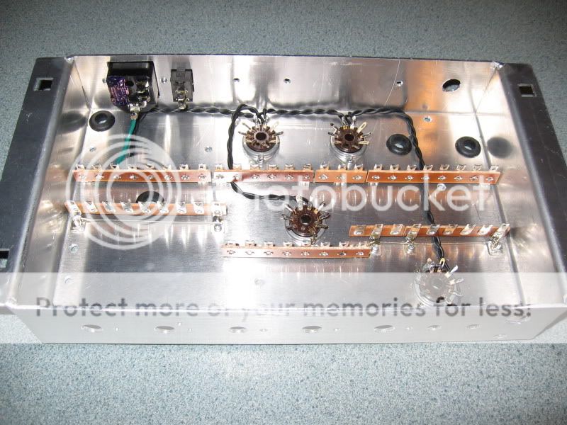

The construction method was point-to-point, using tagstrips. Once the valve sockets had been installed, the tagstrips were next.
I do not use a star grounding scheme, instead using a ground plane method. The tagstrips are riveted into the chassis, but one ground tag in each row is attached much more securely with an M3 machine screw, a nut, and two shakeproof washers. Tinned copper wire is then run from this ground tag and soldered to the other riveted tags, so a secure ground is established at each tag.
Once the tagstrips were in, the twisted pair heater wiring was fitted, and other hardware installed - including rubber grommets where wires would pass through the chassis, the IEC power socket, and the power switch. I often use a rear-mounted power switch to confine the 240 volt AC power to one back corner of the chassis - and because my front panels seldom have space for an extra switch.

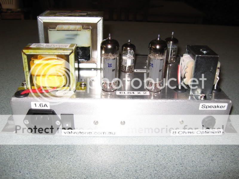

Transformers were next. As I have discussed before, "real" valve amplifier transformers are quite expensive here in Australia, so local builders tend to use non-standard configurations:
As with most of my amplifiers, the plate supply was provided by an off-the-shelf low voltage transformer and a voltage multiplying rectifier/filter. The larger of the two power transformers is 56VAC @ 2.4A, and is used here with a voltage quadrupler.
Theoretical DC output is 56 x 1.4 x 4 = 314 volts.    Theoretical maximum current is 2.4 ÷ (1.4 x 4) = 428mA.
The smaller power transformer is 7VAC @ 4A. It supplies the valve heaters, through a dropping resistor.
The output transformer was originally designed as a public address line transformer, but it works very effectively in guitar amplifiers using push-pull pairs of output valves such as EL84's or 6BM8's. A detailed analysis of this transformer is available here: http://home.alphalink.com.au/~cambie/6AN8amp/M1115.htm
There are exposed solder tags on two of the transformers ( not visible in the above picture ). These were shrouded with heatshrink tubing.

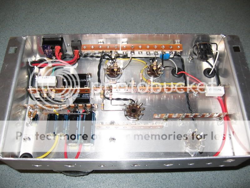

Next, the transformer leads were terminated under-chassis. The terminations carrying 240 volt AC power were covered with heatshrink tubing.
Most of the power supply components were installed next, including the voltage quadrupler capacitors and diodes. Some of the leads and smaller components around the output valve sockets were next, followed by two extra pieces of tagstrip on the back panel. One of these was to support a resistor and capacitor which made up the output stage conjunctive filter. The speaker socket was also fitted at this stage.
Further progress, with almost all components associated with the output stage and phase splitter installed:
The master volume potentiometer was temporarily fitted, so shielded lead could be run from tags near the phase splitter.

That's a unique layout!  I see that you also use the lower holes in the tag strips for connection/solder points.  Those tag strips on the back wall give you a 3-dimensional approach to wiring the power tubes - I like it!

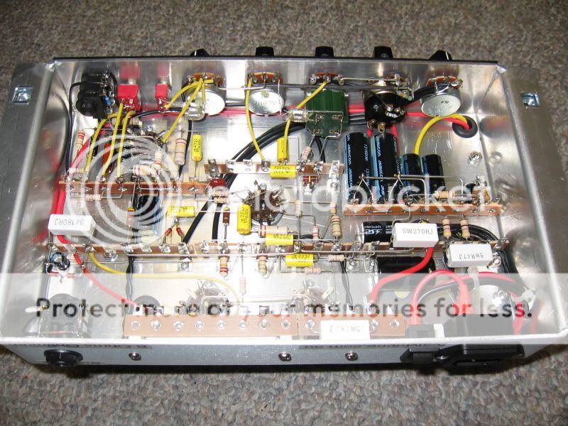

Some pictures of the complete chassis:
Fortunately my amp building skills are somewhat better than my ability with a camera.   :rolleyes:

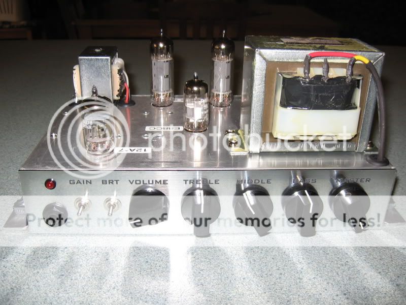

The completed chassis has now been fitted to a very basic timber headshell.
