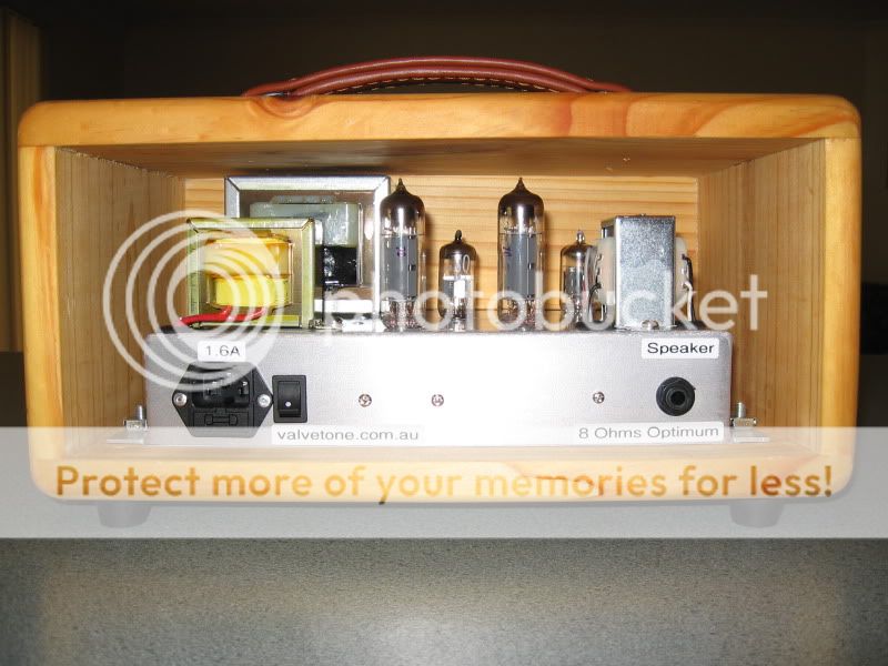

Transformers were next. As I have discussed before, "real" valve amplifier transformers are quite expensive here in Australia, so local builders tend to use non-standard configurations:
As with most of my amplifiers, the plate supply was provided by an off-the-shelf low voltage transformer and a voltage multiplying rectifier/filter. The larger of the two power transformers is 56VAC @ 2.4A, and is used here with a voltage quadrupler.
Theoretical DC output is 56 x 1.4 x 4 = 314 volts.    Theoretical maximum current is 2.4 ÷ (1.4 x 4) = 428mA.
The smaller power transformer is 7VAC @ 4A. It supplies the valve heaters, through a dropping resistor.
The output transformer was originally designed as a public address line transformer, but it works very effectively in guitar amplifiers using push-pull pairs of output valves such as EL84's or 6BM8's. A detailed analysis of this transformer is available here: http://home.alphalink.com.au/~cambie/6AN8amp/M1115.htm
There are exposed solder tags on two of the transformers ( not visible in the above picture ). These were shrouded with heatshrink tubing.

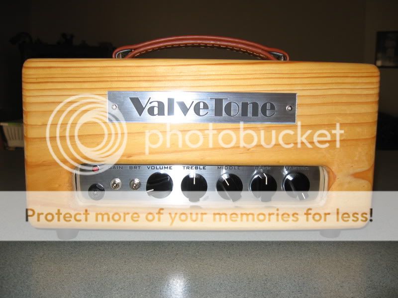

excellent build darryl.  where did you get the face plate?

...where did you get the face plate?
I have faceplates and nameplates engraved by a local signwriting company Ace Plastic Signs. I'm sure any business with a laser engraver would be able to do something similar.

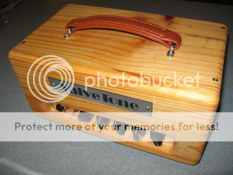

The completed chassis has now been fitted to a very basic timber headshell.
