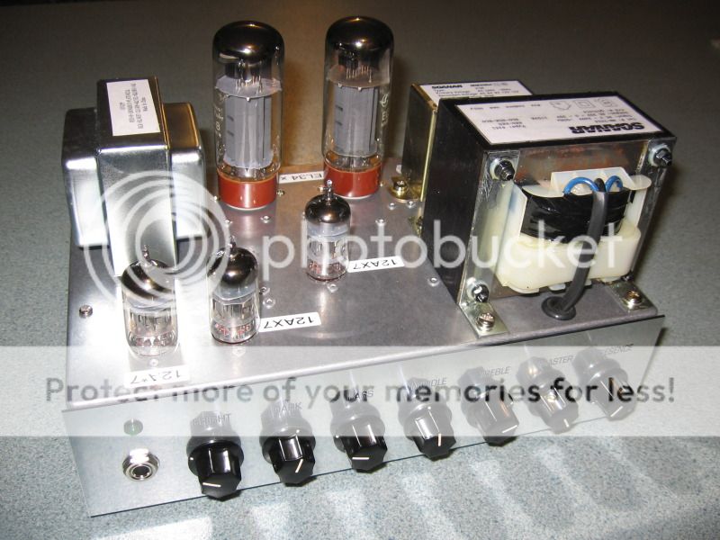

Only note that the two transformers that are near (first photo) have an iron shield

This what I ended up with.It's now taken apart.
This pic was when I started trying to put a bunch of shielded wire, unsuccessfully.
It's a B-15 copy which isn't very high gain.
Waiting for another chassis to arrive.

It looks great Madison - to the untrained eye. Heater wires near the input and then those sensitive preamp wires/pots and then the output tranny wires also near them (all the white wires) is what did things in most likely.
« Last Edit: March 12, 2012, 05:32:54 pm by jojokeo »
Thanks.
I kind of thought the same thing about the heater wiring plus the wiring to the pots were just too manic.
Going to flip everything around the "right way".
I hope that will fix it.

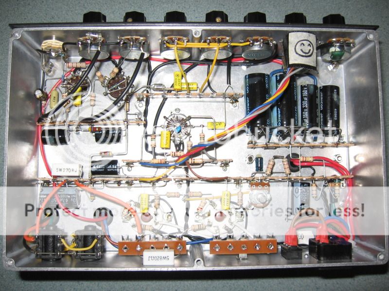

This is a 45 watt amplifier built on a Hammond 1550J aluminium box, with no hum issues. The chassis is 6.7 x 10.8". It has two power transformers, one for the B+ supply and one for the heaters.

What's the specs that OT?
It appears to be much smaller, in physical size at least, than what I am using.
But, yours may in fact be higher quality.
As I did my tests; the smaller the OT, the quieter things got.
I'll try your suggestion.Thanks,
Though I have already drilled out a bigger chassis today
Man, I wish I could do point to point.(I'm not ready for that, probably never will be)
Beautiful work!
« Last Edit: March 14, 2012, 04:27:46 am by Madison »
It's an OT42PP transformer from Musical Power Supplies.
Quoting from their description:
Push Pull Output Xfmr 45W
4200 Ohm Inputs : 2,4,8,16 Ohm Outputs
Can also use as 8400 Ohm Inputs :4,8,16,32 ohms

Darry, love the workmanship there and the extra time it took to make everything North to South and East to West on your runs and bends. I noticed a few goodies like the mustard cap near your input, the polystyrene caps, etc. Me likely. On your output jacks, I can't see the ground wire running from the jacks unless you're using a stealthy bare piece of hook-up wire that I think I can see?
*curious how/what the bright and dark vol controls are?
*I bet running separate PT's for heaters & B+ is helping you as far as noise in concerned?
Offline darryl
  • Posts: 246
    • ValveTone Amplification
Re: PT/OT distance?
« Reply #30 on: March 15, 2012, 07:06:56 am »
I noticed a few goodies like the mustard cap near your input, the polystyrene caps. On your output jacks, I can't see the ground wire running from the jacks unless you're using a stealthy bare piece of hook-up wire that I think I can see?
The mustard capacitor and the couple of "styroseal" capacitors are from a very large quantity of components I purchased about 35 years ago, when much of the domestic Australian electronics manufacturing industry closed down due to the abolition of import tariffs. Unfortunately most of the capacitors ( and resistors ) I have are not suitable for guitar amplifiers. If I had hundreds of .022mfd mustard capacitors, rather than the .22mfd ones, I could almost have funded my retirement.  :sad2:
There is a ground on the output jacks - it's a black wire running from the ground lug beneath the 47mfd electrolytic capacitor to the mid point of the hookup wire which is common to both output sockets.
This particular amplifier is very loosely based on a Fender 5F6-A, but rather than having separate input sockets for the two channels, there is just one socket providing signal to both channels. The outputs of these two channels are then mixed using the "bright" and "dark" volume controls.
I haven't looked into the noise performance of using two power transformers. In Australia, "real" power transformers for valve amplifiers are very expensive ( limited market, high freight costs etc... ) so low voltage off-the-shelf transformers are pressed into service. The B+ transformer has a 70VAC secondary, so the power supply uses a voltage quadrupler to attain the nominal 390VDC B+.
This particular amplifier build is being fully detailed at Australian Guitar Gearheads forum: http://www.guitargear.net.au/discussion/index.php?topic=32065.0  The pictures posted here actually pre-empt that build description.
