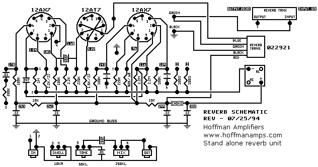

There are two in the Library.
One only has three 9 pin tubes.
The other has two 9 pins and a 6V6 output tube.
Why?
What's the difference?
The one with the three 9 pin tubes, is the tank a rare spec?
If I can't get that tank can I change values somewhere to make a different tank work?

This one.
And can I use a different tank?
http://www.el34world.com/Hoffman/images/HRevskem.gif

That circuit will use the same transformer and reverb tank as Doug's other reverb circuits.
No, same tank as the other (8Ω input impedance).
Like Sluckey said, same operation, but different tube and transformer to drive the tank. The 6G15 basically uses a tweed champ output transformer.
Myself, I like a Type 9 Medium delay tank. I don't play surf, so I don't need crazy drip.

Can this design (or others) be used for other things rather than guitar?
I am looking for something I could loop in/out of a DAW and or mixer.
Line level I suppose would be best.

Anything can be used for anything, as long as you get the impedances and levels right.
But that's the big question: what are the impedances and levels of the ins/outs of your DAW or mixer?

+3.4dBu equals 1.14V RMS (from my google search; verify that with a dB formula and the correct reference voltage).
Assume the 10k input impedance for an unbalanced connection, and that you'll need in excess of 1.5v RMS. That's as bigger than the typical signal fed into a phase inverter, so you know you'll need extra stage(s) after the reverb circuit.
And you'll also need some kind of impedance-conversion circuit, probably a cathode follower of some sort. You could use a transformer, but since you'll need a step-down ratio to down-convert the impedance, your signal level will also be reduced, placing greater demands than stated above ahead of the transformer.
It would be nice to know I wasn't getting any clipping on the return.
You either use your ears, or add some tip jacks for voltage test points, and figure an acceptable voltage reading for that point.
Could I use a reverb pan recovery triode, and hook the line out transformer to the plate of it?
ie going back to this layout, could I hook some sort of line out transformer to V3-3?
To get the right transformer-
Could the spec on the output of the tube be found with a multimeter?
Must do the math?
It is found on the spec data sheet?
That is, IF I even need a transformer to accomplish the task..
(Pardon, I am probably confusing myself and you with these questions.)

Here's a schematic for the Hoffman layout. May help to see circuit options more clearly. I would suggest another gain stage/cathode follower. Remember, this circuit is designed for instrument level input/output signals.

WOW!
This is fantastic.
I gots to build one!
Inset the follower after the Mix pot, correct?
I'd need yet another pot after that for "level"?
Also going to want to stick a TMB in there somehow.
More research for me.
Thanks man

This is if your building a stand alone reverb;
Not really "after".
The CF is for the dry signal that is in parallel with the wet/reverb signal. So it's (CF) really before the mix pot and the mix pot does what it is called. Mixes the wet and dry before they go out.
For what? The mix pot and dwell are the "level" controls.
Why, it's got a tone control, well on the wet/verb side.
                           Brad      :icon_biggrin:
Just wondering, can/could it be after the mix pot?
Maybe Steve would chime in here and say exactly where he meant.
Takes me forever to understand this stuff! :BangHead:
I think he was talking about adding "another gain stage/cathode follower" to get line level signals because you posted this;

I'm still confused, do you want to build;
1. Stand alone reverb for guitar?
2. Build it for line level signals to use with the DAW/loop?
3. Build it to use for both?
2 an 3 need the extra gain stage/cathode follower. 1 does not.

Add the new gain stage, then the new cathode follower after the Mix pot. Remember, you're trying to hit line level after all that stuff.
Maybe, but we're spending time trying to boost the signal to get your line level, so throwing it away seems like a step back. I'd think you'd want to adjust the signal level before the reverb's input to adjust overall signal level. My concern is that adding another pot may just be adding a new place to misadjust and get more noise. Of course, you could always try adding a level pot then removing it if it doesn't work properly.
Maybe a level pot immediately after the Mix pot and before the new gain stage. Breadboarding this is probably the best way to figure out what will work best, before building a nicely-crafted finished project and then ripping out/moving various bits.
Are you sure? Have you tried this kind of circuit with the existing tweed-type tone control?
I ask because this is the standard Fender 6G15 Reverb, and the stock tone control does a pretty good job shifting the reverb tone.
Adding the TMB circuit will entail more signal loss, meaning more to make up somewhere, with more opportunity to add noise, etc. Second, this circuit isn't a stand-alone guitar preamp, and still needs a guitar amp's preamp to boost/shape the signal.
And if you're thinking about tonal control for your recordings, isn't that better accomplished through more elaborate EQ's in your DAW?
I think #3 would be best but maybe too complex for me at this point.
No it's not.  :icon_biggrin:
You know the output of the Mix pot is good for guitar-signal output into an amp, as this was designed to do.
Notice the Output jack is drawn as a switched jack, shorting the hot to ground. This is probably silly, because if you unplug from the output jack, you won't hear any noise anyway. So let's re-purpose that switched contact.
Disconnect the switched contact lug from the ground lug. Add a wire from the switched contact lug to the grid circuit of your new gain stage (with the cathode follower after the gain stage, and a line-level output jack).
Now, the jack after the Mix pot is your "guitar-level output" and is normaled to pass signal to the line-level circuit. If you plug into that output, you break the connection to the line level section automatically.
Things will only get complicated if you want to have both guitar-level output and line-level output at the same time. Even that shouldn't be a big deal, but I'd have to think more that 20 seconds to come up with a good solution.  :laugh:
I am going to have to.
Agreed.
Good point! I was thinking that too
I get it!
Makes sense to me explained like that.
Please be kind to the electronically challenged  :laugh:
Thanks for everything.

Truth be told, I got lucky with an "error" on Sluckey's schematic.
He has a symbol for a Switchcraft 12A jack, which has a switched contact for the hot lug, in his schematic. This is the type of jack typically used for the input jacks and main speaker output of old Fender amps.
But the original Fender 6G15 Reverb uses a non-switched Switchcraft 11 jack for its output.
When you first said you wanted guitar level and line level, I had visions of a lot of thinking to figure how to provide both. When I saw that switched output jack, it gave me the idea to break the signal there for guitar-level output.
So it did take only 20 seconds, but just because someone else inadvertently gave me the idea.

And don't forget... Since you will be using a line level input you don't need V1. Just put the dwell pot on the grid of the 12AT7 and connect the input jack thru a small cap to the top of the pot. Now you can use V1 for the gain/CF you need at the output.
« Last Edit: December 01, 2012, 09:34:10 am by sluckey »
Re: Stand alone reverbs
« Reply #27 on: December 01, 2012, 11:03:14 am »
Ughh... overlooked that.
He wanted to be able to use line- or guitar-level input.
The easiest kludge is to have some control over output level from the DAW to knock the signal down before input to the reverb unit.
The second-easiest is to add a "line in" jack after that first stage, again using the switched contact to allow a normaled connection when no plug is inserted. That gives guitar-level when not plugged into the Line In jack, or line level with first stage disconnected when plugged into the Line In jack.
