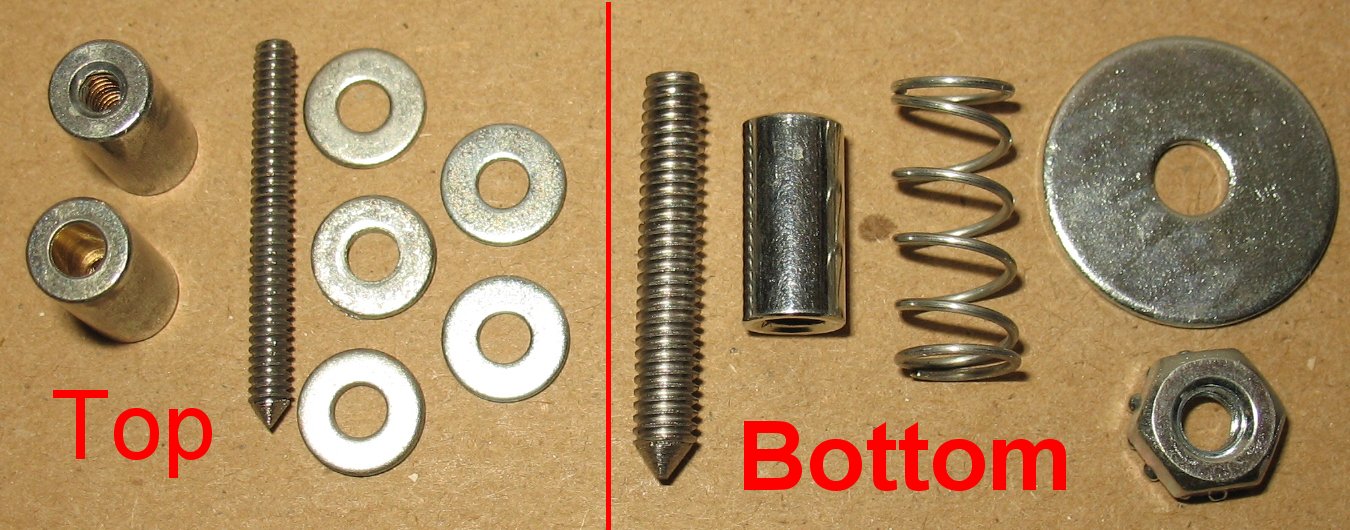

The full sized image is here
https://el34world.com/charts/images/Img_1577.jpg
On the left side are all the parts for the top tool
On the right side are all the parts for the bottom tool
The top tool has two ends that thread onto the small threaded rod
The washers are used as spacers to set up each end of the tool
The pointy end has to stick out a certain amount so that an eyelet sits flush on the end of the tool
The other end has a hole for a turret lug
You have to set the depth of the threaded rod so that a turret lug goes into the hole all the way down to the base of the lug
The threaded rod should not keep the lug flange from sitting flush against the tool surface
The bottom tool is much easier to assemble.
The post below this one shows how to assemble the bottom tool

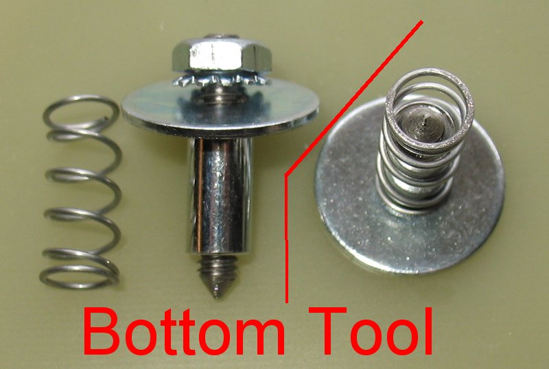

Bottom Tool
You thread the round metal piece onto the larger threaded rod
Leave just a bit of the pointy end sticking out
The bottom tool has a pointy end that flares out the bottom side of Turret lugs and eyelets
The big washer keeps the tool level on the mounting material
The Keps nut locks the tool onto the mounting material
1/8th inch thick G10 board material works great for a mounting plate
I stock this board material on the board building catalog page
A 6 inch piece is usually all you need to mount this tool onto a drill press
The bottom tool gets mounted into a solid piece of material
In the image below I have drilled a hole in a piece of 1/8th inch thick glass epoxy board material
The spring pushes the board material up so that the top side of the terminal sits flush against the top of the board surface
The top of the spring should be just a bit higher than the pointy end
You can stretch out the spring if you need to make it longer

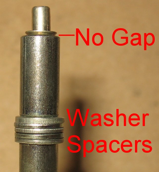

Top Tool
You can see both ends of the top tool in the image below
One end has a hole that turret lugs go up inside when swaging
The other end has a very small pointy tip
The pointy tip centers the top of the eyelet into the tool
The pointy tip should only stick out a tiny bit
The pointy tip should not keep the eyelet from sitting flush onto the tool surface
The washers are used as spacers and keep the tool from sliding as you press the terminals
The end of the drill chuck should be up against the washers so it cannot slide.
« Last Edit: February 15, 2021, 02:17:27 pm by EL34 »

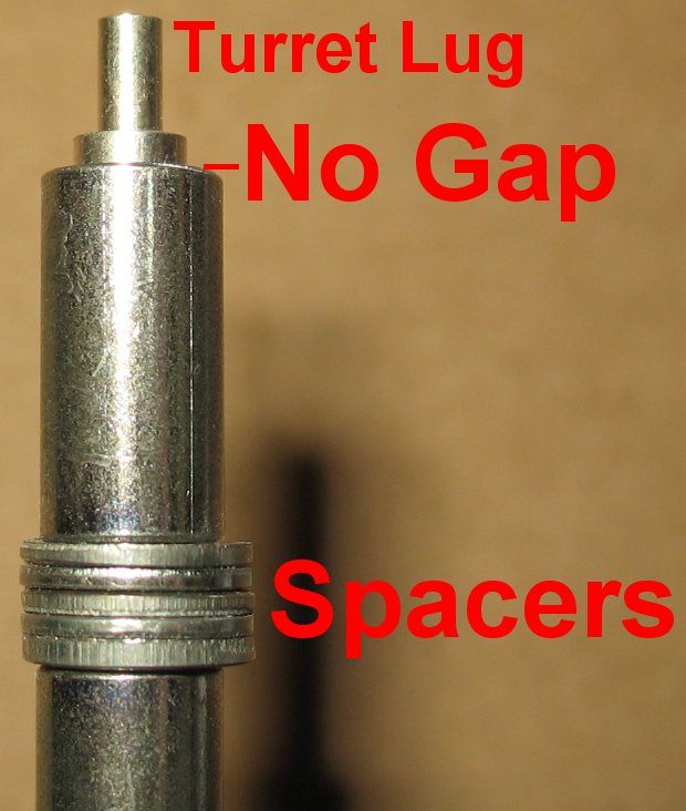

In the image below you can see another shot of the eyelet sitting flush on the surface of the tool
The tool comes with some spacer washers
The tool is assembled with washer spacers in the center
The washers set the spacing for the pointy tool
5 washers come with the tool
The other end of the tool has a hole for a turret lug
The threaded rod in the center should not keep the turret lug from going all the way into the tool
You need to use the washers to get both ends of the tool set up correctly
The images below show that there is no gap when you place an eyelet or turret lug on the tool.
The terminals sit flush on the tool surface
« Last Edit: February 15, 2021, 02:18:17 pm by EL34 »
