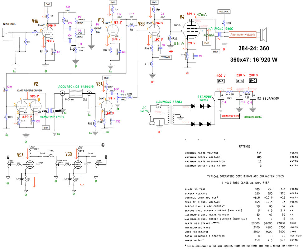

No, there are only two valves (V3 and V4)
It’s not clear from the photo what is happening at the input. Where is the input?
There is no input in this partial circuit. Refer to the schematic in Reply #79. The problem is a 100KHz oscillation on the speaker. Pulling V3 will kill the oscillation. Put a ground on V3 pin 7 will kill the oscillation. Put a ground anywhere else in the V3A circuit will NOT kill the oscillation. What is the solution?
There must be some positive feedback going on somewhere, or the 1st stage is acting like a radio antenna. What about grounding Pin 2 of v3? (A normal guitar amp has a ground tip switch on the input Jack, or an instrument plugged in.) Or running a meter over the PS rail to check the filter caps are properly decoupled?
That is what I find strange, that putting pin2 of V3 to ground, there is a signal in the speaker. Even putting to ground the union of R19 with C12, there is still a signal.

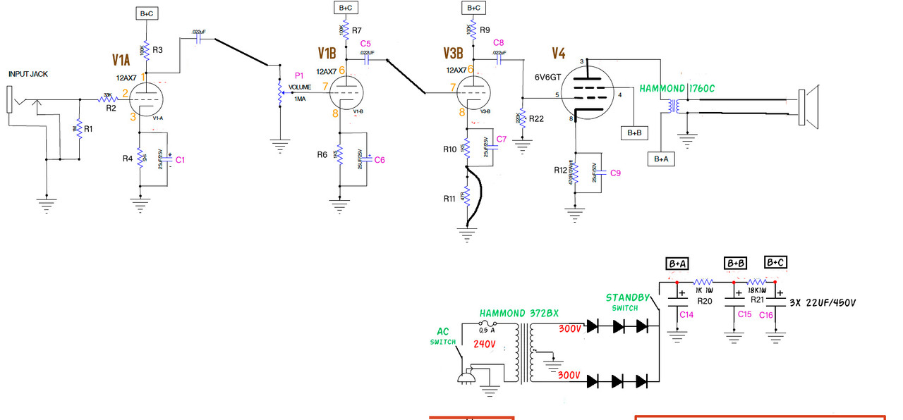

Do you think this simplification of the circuit could work?
Re: voltage on 6v6 GT
« Reply #106 on: January 24, 2023, 02:44:54 pm »
"Work" like play? Probably. Work well? I bet with a complete AA Champ, no NFB or tone, volume, and then a THIRD triode gain stage, it will be a bee's-nest at any knob setting, and overload or scream past "3".
Have you tried a faithful copy of a Fender Champ? Especially the layout! When I tried that, I realized there are hard-learned unwritten lesions in how Leo placed those parts and wires. I was able to get it clean pushing wires around with a 'lead' pencil, but I had 90% stolen Leo's layout so I was closer than I knew.
NO!
Regarding V3b -
A DC path between a grid and its cathode is essential. It’s normally achieved by a grid leak resistor.
Regarding V3b -
Yes, I totally agree. It's a mistake. In fact I was going to do it with a 220k-470k resistor. Thanks

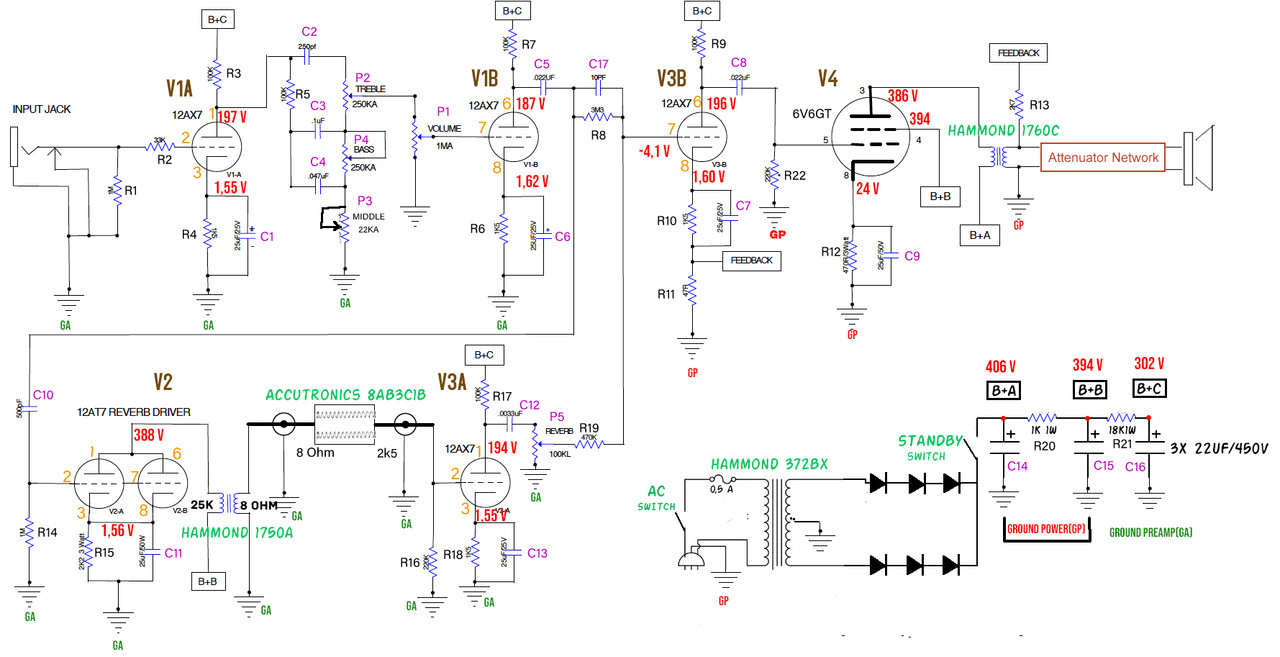

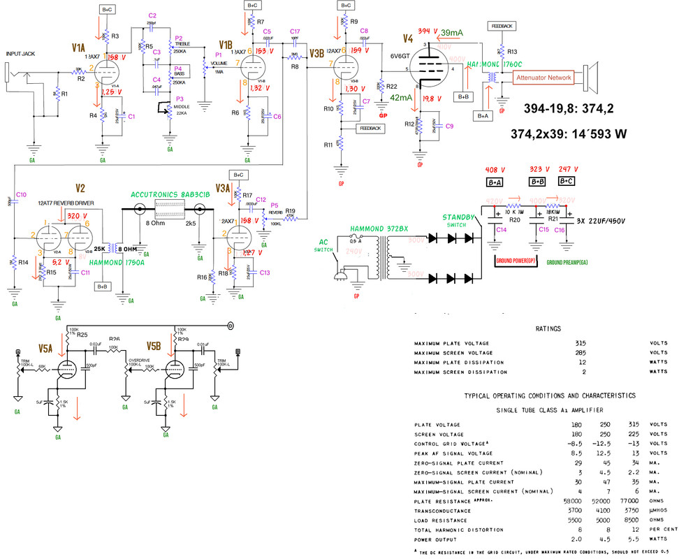

« Reply #112 on: January 30, 2023, 06:10:24 am »

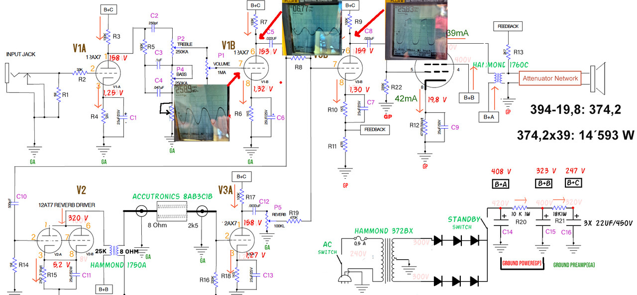

Hello!
I have redone the circuit by shortening cables and following the layout of a Fender as precisely as possible.
It is made as in the circuit of the image.
The measurements I get now seem correct to me except that:
1- They seem a bit high in value to me
2-In pin 7 of V3B I have a voltage of -4.1 V
3- In pin 4 of V3 I still have higher voltage than in pin 3
Are they normal values?
tank you
1- They seem a bit high in value to me   (Quite normal for that Hammond 372BX)
2- In pin 7 of V3B I have a voltage of -4.1 V  (should be zero. Maybe it's really -4.1mV but you misread your meter?)
3- In pin 4 of V3 I still have higher voltage than in pin 3  (pin 4 is filament. What's your point?)

in the 6v6 gt pin 4 is screen
  • Posts: 5394
« Reply #115 on: January 30, 2023, 06:43:36 am »
I meant V4
Sorry. I'm not a mind reader.  :wink:
It's very possible that your OT has been damaged by that BIG high frequency signal you had in the beginning.
Offline rafaelctt
« Reply #118 on: January 30, 2023, 07:27:13 am »
I meant V4
Overall, having 6V6 screen voltage a bit higher than the plate voltage doesn't matter.  And it happens due to voltage drop across the output transformer primary.
Your diagram shows 406v in the power supply, and 386v at the 6V6 plate: 20v dropped across the transformer primary.
Hammond says the primary has a resistance of about 360Ω.  20v / 360Ω = about 55.6mA of plate current.
Your diagram shows 24v at the cathode, across a 460Ω resistor:  24v / 470Ω = 51mA
We can see that either the cathode resistor is lower than 470Ω, or your 1760C is higher than 360Ω.
6V6 Dissipation:  (386v - 24v) x 56mA = 20.3 watts ---> way too hot.
Reduce the 6V6 dissipation:
   Assume the plate voltage will land at 393v
   14w / 393v = 35.5mA
   Add 3mA of screen current:  35.5mA + 3mA = 38.5mA
   Calculate cathode voltage:  470Ω x 38.5mA = about 18v
   Using the triode curves in a 6V6 data sheet (page 5), I estimate the 6V6 needs a screen voltage of about 275v to pass 38.5mA with a bias of 18v (I can show the method some other time if you like).
   Your diagram shows a voltage drop from "B+ B" to "B+ C" that indicates preamp current is about 5mA.
   We'll estimate our 3mA 6V6 screen current plus 5mA preamp current flows through R20: 8mA
   We have 406v at "B+ A" and need 275v at "B+ B":  (406v - 275v) / 8mA = about 16kΩ ---> use an 18kΩ resistor for R20
Offline rafaelctt

Hello!
tank you
Based on this schematic and these reported voltages, the 6V6 is dissipating 16W
(I get 51mA cathode current, i.e., 24V/470R, including 6.9mA* screen current)
So, 44.2mA plate current x 362V plate-to-cathode = 16W plate dissipation
*based on the voltage drop across the supply resistors. i.e. 12V across 1k (R20) minus 92V across 18k (R21). This is way too much idle screen current for a little ole 6V6. In order to lower the screen current, you need to lower the screen voltage by about 50V. So try 10k (instead of 1k) for R20. This should bring the 6V6 back into more normal operating conditions. (Note also that when you increase R20 to 10k, you may want to decrease R21 to something between 4k7 to 10k if you want to maintain the preamp plate voltages around 250V)
« Last Edit: January 30, 2023, 04:08:07 pm by tubeswell »
Offline rafaelctt
  • Posts: 199
« Reply #122 on: January 30, 2023, 03:32:20 pm »
I meant V4
   14w / 393v = 35.5mA
I agree.
But didn't I mention I don't exactly trust the numbers provided?  Because I don't exactly trust the numbers provided.   :laugh:

I have made a series of measurements of voltages and currents. I have done it with resistance R20=1K and with R20=10K. In both images you can see the measurements obtained.
with R20=1k
with R20=10k
Offline rafaelctt
  • Posts: 199
« Reply #125 on: February 03, 2023, 07:11:46 am »
I think that with the 10k resistor the measurements are more or less good. The problem is that I have a lot of distortion and too much gain with the volume at minimum. The reverb also gets really loud with the volume all the way down. How would I measure the gain of each triode? I have a signal generator but it barely injects a level above 100mV when I plug it in. (no load if it goes up to a few volts). It must be the low impedance it has (600 Ohm)

These are some captures with the oscilloscope with high volume.
The current through R20 is increased to 16 mA. Therefore the resistor has to dissipate almost 3w.
  • Posts: 5394
« Reply #129 on: February 04, 2023, 08:25:06 am »
I suggest replacing R20 with a 10W resistor. I'd probably use a 5KΩ 10W resistor.

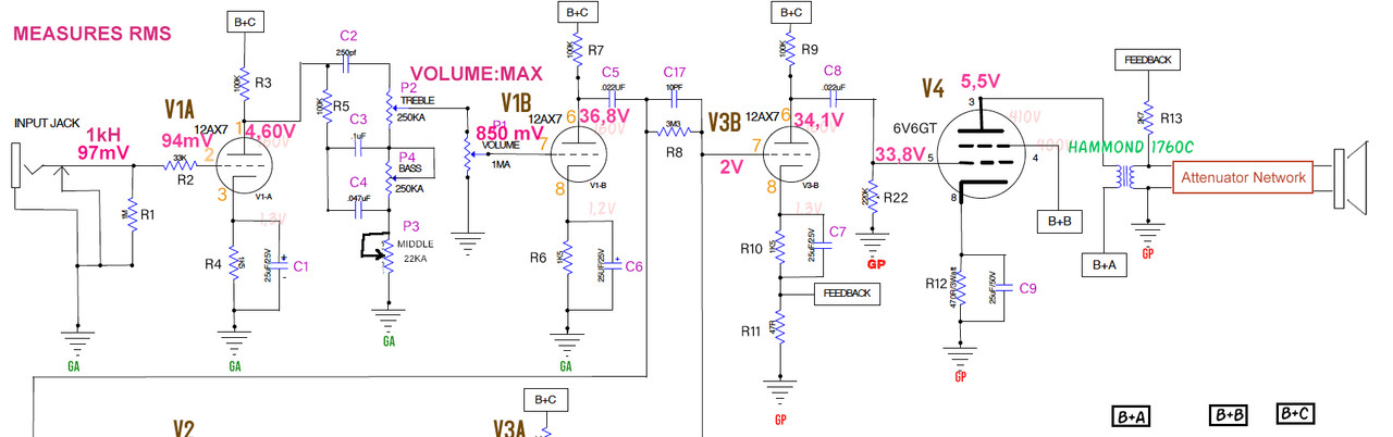

I inject a 90 mV rms signal into pin 2 of V1. With the volume at maximum (P1) I have 30 volts rms on pin 5 of V4, isn't it too much? The wave is very distorted on its positive side.
Offline rafaelctt
  • Posts: 199
« Reply #138 on: February 05, 2023, 01:22:30 pm »
These are the rms measurements injecting 97mV 1Khz
I don't see any alarms.
You have analyzed this amp to death with your FG. IT'S TIME TO PLUG IN A GUITAR!!!
« Reply #143 on: February 08, 2023, 04:24:27 pm »
Your diagram shows 33.8v RMS on the 6V6 grid.
The diagram in this post shows your cathode (bias) voltage is 19.8 volts.  That means the 6V6 cannot accept more than about 18.5v peak before it draws grid current & distorts heavily.
"The wave is very distorted on its positive side" because 6V6 grid current is lopping off the top of the wave.  The 6V6 is receiving 33.8v RMS x 1.414 = 47.8v peak, or about 2.6x more than it can handle cleanly.  PRR told you this would happen back in this post.
You might be able to knock down some of the signal level by making R19 smaller (reduces the Dry signal strength, but makes the Reverb stronger), splitting R14 into 2 resistors to reduce the drive into the Reverb Driver 12AT7, and use a 100kΩ Audio taper for the Reverb pot so the reverb is not so strong at low settings.

« Reply #146 on: February 08, 2023, 08:07:31 pm »
It would be reasonable, for most genres and styles, for the amp to be on the edge of overload when dimed and 20mV input. Since he has 97mV input when he has gross distortion, he's not far off; unless this is already turned-down some.

« Reply #147 on: February 08, 2023, 09:17:13 pm »
Maybe the circuit is  "proven" as mentioned earlier by rafaelctt in this thread, but this isn't a commercial circuit... or is it??
I and others questioned the circuit several posts back. It seems that the basic circuit is proven, but there are multiple added gain stages. In addition, the subject of the non-standard practice layout is still out there. Requests for pics of the revised layout have not been answered making this a frustrating thread.
Were I to work on this amp, I would temporarily disconnect the reverb and the extra gain stages and get the amp working producing clean sound. Then I would start adding things back in, testing and adjusting along the way.
