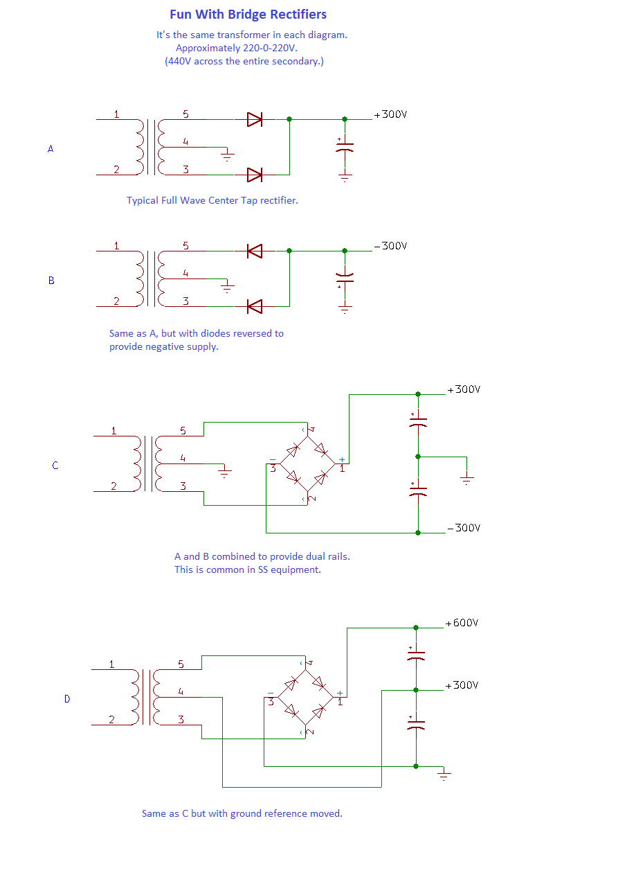

Therefore I am wondering if i could use a 2x 100uF series reservoir cap and tap the screen supply off the half voltage node along with the preamp tube voltages. See attached drawing.

I may be wrong, but I would think you would want your CT referenced to ground.  It might be ok to run your screens off of the balance resistor, but you could even be getting false readings for plate dissipation based on your ground reference.
In my research i found this reference design. CT reference point is between the stacked reservoir caps.
http://schematicheaven.net/fenderamps/twin_reverb_sf_135_schem.pdf
I think if you reference the CT to ground, the ground reference of the rest of the design would also have to move to the intersection of the stacked reservoir caps to prevent shorting a PT secondary winding. But that would result in a dual rail power supply with +300V and -300V nodes.
These are the options:
Option D is the only setup that gives me the high voltage node and an acceptable screen supply voltage for EL34's.
I essentialy created the screen supply attached, but with the added balancing resistors.
I don't think these resistors pose a problem as they are also incoporated in the fender design above as 2x 100k 1W.
I also found this page (section 5 - Power supplies) an interesting read regarding all this: https://sound-au.com/valves/design2.html#s5

Yes, I would double check across the OT primary using the link you posted.  Since you're elevating the center tap and the cathode is still referenced to ground, the ohms law measurements (could?) get squirrely.
Maybe not though, it will be interesting to see the results.
So i've measured across the OT primary, here are the results:
R1 = 68.5R and V1 = 2.68V so that makes I1 = 40.12mA
R2 = 69.2R and V2 = 2.65V so that makes I2 = 38.86mA
with 580V on the plates and 20.1V on the cathode that gives me 90% plate dissipation per tube on idle.
this even makes me wonder if i could lower the cathode resistors from 470R to 390R or 330R...
