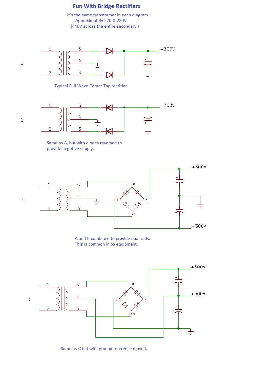

I'm building a Matchless Clubman based on this schematic:
https://el34world.com/Forum/index.php?action=dlattach;topic=5730.0;attach=68259;image
I'm using a power transformer with 435Vct secondary from a Conquest Tube65 amp (3x 12ax7, 2x EL34).
I don't really know how the original Conquest amp was designed, but I'm having trouble using this transformer without exceeding the EL34 max. screen voltage. 435V x 1.4 = 609V.
I found some pictures of the inside of the amp but cannot figure it out due to the PTP wiring: https://www.igoramp.it/product/conquest-t65r/
Therefore I am wondering if i could use a 2x 100uF series reservoir cap and tap the screen supply off the half voltage node along with the preamp tube voltages. See attached drawing.
Also, in the Clubman schematic the V1 plate voltage is created using a 220k dropping resistor in the power supply and 18k plate resistor. I have never seen this setup before and don't really know how it works. I'd rather use the Chieftain setup with a 22k dropping resistor and 100k plate resistor.
Any thoughts or feedback?

After much reading i figured it was ok to continue with the split rail power supply design.
Unfortunately i had to give up on the Conquest output transformer because it was shorted.
I installed a tube-town dual primary output transformer, using the 6k6 connections: https://www.tubetown.net/ttstore/en/tube-town-outputtransformer-dual-primary-for-marshall-jtm45.html
Power supply node voltages are:
A 590V (B+)
B 295V (Screens)
C 285V (PI)
D 285V (ef86)
E 135V (V1)
I kept the 220k dropping resistor and 18k plate resistor configuration on V1 for now.
I'll probably play around with the preamp voltages later, but for now it sounds pretty good.
Bias on idle:
Plate voltage for EL34s is 590V
Screen voltage is 295V
Cathode resistors are 470R with 20.7 V across
Plate-to-Cathode Voltage is 590V - 20.7V = 569.4V
cathode current is 20.7V / 470R = 44mA
Anode current is 44mA - 44mA*0.065 = 41.14mA
so plate dissipation per tube is 41.14mA * 569.4V = 23.43W or 93.72%
Not exactly Matchless territory on the plate dissipation % but i'm not really comfortable with anything higher than 100% idle, so the 470R's will probably stay.

I may be wrong, but I would think you would want your CT referenced to ground.  It might be ok to run your screens off of the balance resistor, but you could even be getting false readings for plate dissipation based on your ground reference.
In my research i found this reference design. CT reference point is between the stacked reservoir caps.
http://schematicheaven.net/fenderamps/twin_reverb_sf_135_schem.pdf
I think if you reference the CT to ground, the ground reference of the rest of the design would also have to move to the intersection of the stacked reservoir caps to prevent shorting a PT secondary winding. But that would result in a dual rail power supply with +300V and -300V nodes.
These are the options:
Option D is the only setup that gives me the high voltage node and an acceptable screen supply voltage for EL34's.
I essentialy created the screen supply attached, but with the added balancing resistors.
I don't think these resistors pose a problem as they are also incoporated in the fender design above as 2x 100k 1W.
I also found this page (section 5 - Power supplies) an interesting read regarding all this: https://sound-au.com/valves/design2.html#s5

As far as I can tell, everything you've done looks ok, should work.
I think you'll need to select the OT carefully though, a regular EL34 spec (3k4) may have much too low primary impedance, and the valves will get too hot.
These tools may be helpful with that
http://bmamps.com/ivds.html
https://www.vtadiy.com/loadline-calculators/loadline-calculator/
Bear in mind that your power supply loaded voltages will be lower than when unloaded.
