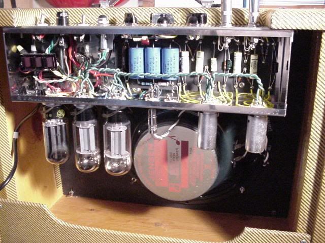

I have a 5E3 Deluxe. I am trying a pair of 6L6GC power tubes with a 5U4GB rectifier. Lots of full headrom. A bit too much i think at times. I dont see a feedback resistor to tame the headroom a bit. Any other options? Glasses?

Thats what was in it. A friend wants to use the 6L6GC tubes for more headroom.  The amp though is what it is. 6V6's do sound best
I should suggest another amp

Re: 5E3 Deluxe Using 6L6GC
« Reply #4 on: October 24, 2010, 12:06:46 pm »
I built a 5E5 for that very purpose (similar to a 6L6 5E3 but with paralleled triode preamps). It is too loud for most situations if you're looking for a balance between clean and overdrive using the volume control on the guitar. It's a great sounding amp in the right room (outdoors) or volume situation. I'm guessing it to be 30-40W output and it's still too loud!
That said, the 5E3 has been the amp that I've built the most of. One suggestion that I've had for people that gig with them is to buy a volume pedal. Most Volume pedals have a "Minimum or Threshold" setting, which is the volume of the lowest setting of the pedal. Set the "Minimum" to the loudest clean tone that the amp will do, then rock it forward for grit. It works great!
The other options may be, 12AU7 instead of the 12AY7.  Feedback may help too, but you may lose some of that "loose or sloppy" low end that is part of the Tweed Tone.

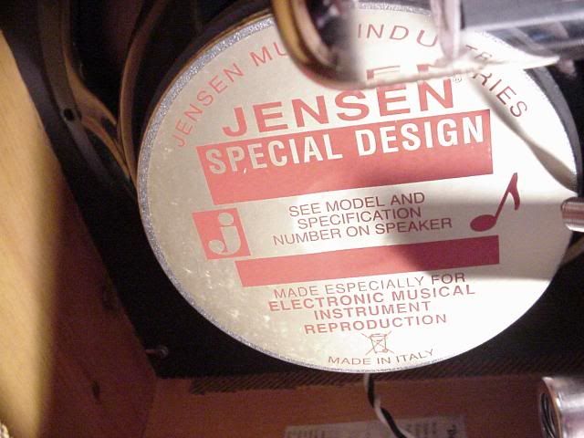

« Reply #6 on: October 24, 2010, 02:35:33 pm »
From what i am hearing this amp would probably sound killer driving a pair of Celestion 12" 75's. It wants to push more air than the 10" Jensen can handle at higher volume levels. It's not a tweed deluxe any longer.
« Last Edit: October 24, 2010, 04:52:08 pm by plexi50 »
« Reply #7 on: October 24, 2010, 03:53:50 pm »
5E3 should have a 12" in it already.
Open Minded But Fixed Bias
« Reply #8 on: October 24, 2010, 04:47:16 pm »
Your right bigsbybender. Having a real altimers month

« Reply #9 on: October 24, 2010, 08:33:15 pm »
Hi plexi50
(so you're running the 6L6s at 1/2 the 'normal' 5E3 load resistance already?)
If you are not happy with the headroom, a 5E3 cathodyne PI won't drive the 6L6s grids to clipping, but you could try:
1) upping the driver stage's plate resistor to 220k, and
2) upping the plate and cathode resistors on the cathodyne to 100k.
3) opening up the B+ supply at the PI position to get a bigger signal swing, by either:
a) using a smaller supply resistors - like 470R to 1k as the first resistor, and 4k7 to 10k as the second supply resistor, or
b) using a choke (i.e.: CLC filter) in the first position to get more voltage at the PI supply point, and playing around with the second supply resistor.
Another thing you could try, possibly combined with the above, is a chunky (5W) unbypassed 4k7 between the screen supply node, and both screens. I built a 5E3 for 6L6s that had a switchable CRC-CLC filter and found that it sounded good with the unbypassed screen resistor in the 'CLC' mode. See attached schematic
JM2CW

Thanks all for the info.  The speaker i think isnt that good.  It almost sounds like the speaker has a blanket over it at higher volume levels. I know a good speaker is KING and a must have when having large headroom. I bet a 15" would sound killer

I agree with Phsy...  That's the wrong speaker for the bassy 5E3 circuit.  To my ears, higher wattage efficient speakers with 1.5"+ voice coils don't sound balanced in a 5E3, the treble tones get covered up with bass (i.e. sounds like a blanket is covering the amp).  I would think this would be more so the case when using 6L6's.  I would suggest the Webervst.com Signature Series 12S ceramic or the Mojotone.com AV12C ($35-40+ ship) for the 5E3 circuit.  Either one of these speakers will let a 5E3 sound like a 5E3 and are loud enough to gig with.  If $$ is no object, I'd go the Weber Vintage series route (12A or F125).  That C12N belongs in a Hot Rod Deluxe.. not a Tweed Deluxe!

I absolutely LOVE the sound of the Mojotone 12" AV12C,which is likely made by Weber anyway,but it's cheap and sounds fantastic.
« Reply #14 on: October 29, 2010, 08:54:45 pm »
In mine I run a Heritage g12H for headroom and it sounds bright w/ thundering lows and has HUGE projection - very balanced. If I want more authentic tone w/ more breakup I use a Weber alnico 12" -125A-S w/ the ribbed curved seem. Two awesome speakers IMHO.

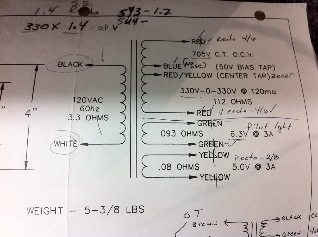

I wanted to post the 2 PTs that I'm dealing with..
The tranny 330-0-330v is the original one that is currently in the amp..
Here are the specs on the one i plan to install ...
I need some confirmation on wire hook ups..
From what I can tell..
From the new one..
Yellows..(2) rectifier pins 2/8
Reds...(2) rectifier pins 4/6
Greens..(2) pilot/heaters
Blacks..(2) power and common
Red w/ yellow to cathode
The questions.. No use and tape off separately???
Orange, green w/white (6.3v center tap), Red w/green (bias)
  • Posts: 4429
yep (and the B+ is taken from pin 8 as well, and goes to the +ve side of the reservoir (1st) filter cap).
yep
yep. You can either use the green/white heater winding CT (OR you can make an artificial ground reference with 2 x 100R resistors, one from each side of the heater winding, each going) to ground with the power amp ground returns  (BUT do not use both methods at the same time - just use one way or the other).
For an elevated heater - put this preferred ground return point to pin 8 of one of the 6V6 sockets (alongside the cathode resistor ;-) - this will elevate the heater winding to the same voltage as the 6V6 cathodes, which eliminates any source of heater hum noise getting into the pre-amp signal.
yep. Put the Mains fuse on the active/phase side (and then the mains switch, and then the PT primary). With the fuse holder, remember to wire the mains/hot side of the phase/active wire to the tip-end of the fuse holder (and not the sleeve end) in order to save accidental electrocution if you have the fuse cap off.
Nope - red-yellow is the HT centre tap, and ideally that goes to exactly the same ground return pint as your reservoir filter cap ground return for quietest operation.  See R.G. Keen's article (attached)
See my earlier comment about the heater CT. You don't need the (red/green) bias tap in the 5E3, so put some heat-shrink over the bare end and tuck it away where its not going to short onto anything/the chassis.
« Last Edit: February 27, 2011, 11:41:50 pm by tubeswell »

Success!!!  Sounds awesome..
Thanks for all the help.. Now ,, off to enjoy the new toy..

Yeah.. Same noise unplugged... I plugged in my bias king and got a 50ma reading...
Tried different tubes.. I also noticed with no cord plugged in, when I turn the volume up past 2 I get a high pitched squeal .. May not have anything to do with the him but thought I'd mention it..
I do have a shielded cable on V2 pin 2 going under the board going to the first volume pot...
