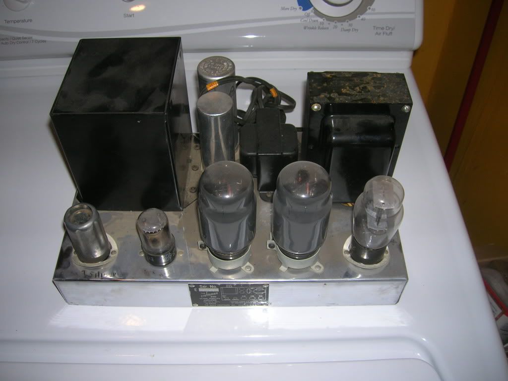

This was $25. and made my day with an ear to ear smile. Cherry condition Radio Craftsmen 500 w/2 qty Genalex KT66. Haven't given it the smoke test yet. 2*6SN7, 2*KT66, 5V4.
Incidentally; the PT is a Stancor PC-8414 (complete with yellow label) 600-0-600 (!) HV winding.
I *believe* this is a triode-connected amp, but I'll have to research further.
Great find. Well worth a full restoration.
The 500 used an LC power supply, with the first choke connected to the secondary. B+ is only 450 V with the stock 5U4G and 117 V mains.
It is. Based on the original Williamson. The US equivalent of the glorious Quad II.

The striped Sprague caps have a reputation among radio restorers as being universally leaky. That may not be the case in your amp, but I have read an extraordinary number of posts on a restoration forum where an untold number of scopes, test equipment and radios have been fixed by simply replacing every striped cap in the entire unit. They are willing to do that because after finding a handful that are leaky, they know that the others will fail after a short additional period of time.
I don't have to tell you that keep the smoke-glass KT66's seperate for sale is a smart idea.
And you may want to double-check the circuit against FYL's posted schematic. The first-stage plate and cathode resistor values on the schematic seem reversed (470k where 47k should be, and vice-versa).
The schemo is from Sams Photofact.
And yes, R1ak should be 470 Ω, not 470 K. R1ap is correct at 47 K. Classic Williamson values...

I *DID* notice some oddities; the HUGE cathode resistor on the first stage; the feed from the heater winding to the cathodes of the KT66's...
The 470 K Rk is a labelling mistake, it should read 470 Ω; there's 40 V atop the cathode Rs, connecting them to the heater CT raises them, with 6.3 V AC running atop 40 V DC => less AC noise, as the static DC field is much stronger than the AC one.
Another bonus is reduced heater to cathode voltages. Check the cathodyne: the cathode is at +100 V, a high value - still OK with quality 6SN7GTs which are rated for 200 V but a problem with sub-par tubes, riding the heater voltage atop +40 V reduces this to +60 V - OK with nearly all 6SN7GTs and their derivatives.

FYL, the 470K, error or not, stood out even to me with my sketchy knowledge.
And yet.....
http://www.xs4all.nl/~ideas/amps/index.html
This ckt has it as a 470K as well. Me? I dunno.
Looking at the one still sitting atop the Maytag, fresh from the hunt, first triode has either a 220 or a 22K resistor to chassis ground. I can't tell whether the color is brown or orange, if I were forced to give an answer I would lean brown = 220 ohms.
There appears to be no "bus bar" mega-ground bus...but the input RCA connector is just about as close to the first 6SN7 as are the tube-socket mounting screws. I mean, jammed right next to it.

And yet.....
Same typo, corrected later on the site. Check http://www.xs4all.nl/~ideas/amps/chapt3.html
European notation is 470R, 470K is very close visually.
Most US techs will read 470R as 470K with a tiny flea dropping atop the K...
Copies of the original WW leaflet are available online, for instance here: http://www.clarisonus.com/Archives/Amp_Design/Williamson%201952%20The%20Williamson%20Amplifier.pdf
SAMS' draftsmen often had a mistake or two.
As already said, first cathode is 470 no K.
Otherwise the 5.1K NFB resistor would set up an unlikely gain of 1.01 instead of ~~10, a reasonable value.
And it is thoroughly Williamson. A tinkerer's dream. Over-done.
Not a guitar amp: way too polite. And of course more valuable as-is.
Yup, as said, this is the +40V DC at cathodes TO heater to attract stray electrons away from cathode signal circuit. And reduce stress on the cathodyne H-K insulation.

Well I finally delved into this a little...more than anything, just alcohol & Q-tipping off 50+ years of liquor-cabinet skunge to prepare it for sale more than anything else. The chassis is like a mirror!
The Genalex KT-66's are AWESOMELY matched, within .5 ma of each other, and they test virtually new. This thing  probably saw very little use in its almost 60 years of life.
What may well impact the salability dollar amount is that the power transformer appears to have been replaced. I am sure the specs of the replacement tranny are proper, but I can see the solder joints are not factory, and, there is an unused winding which is taped off. You can see it in my gut shot--immediately west of the fusepost, with orangish tape on the wire-ends. It's not that obvious. The first clue was the typical yellow Stancor label on the end bell; A factory tranny wouldn't have that, and none of the pix I've seen of these retain the Stancor yellor label. Underneath which it's stamped "P-8414".  It wouldn't surprise me to find that the tranny is identical to factory, just labeled as a replacement part instead of unlabeled as OEM.
So I can't sell it as "virgin untouched" but other than that, I've variac'ed it up to about 85% and nothing blew up, and the B+ was strong and stable.

Well, it's been a while and I know I will probably disappoint some here with this report of the "fate" of this amp.
But: I determined that the power tranny was not original; and not only was it not original, the mounting pattern did not *quite* match up with the holes in the chassis. The way the tranny-replacement tech addressed this was to "tweak" the legs of the replacement power tranny inwards. This caused two small pieces of ugliness, eg; the core of the transformer hangs out over the edge of the chassis by about 1/8" and the mounting legs got tweaked inwards. This also raised the tranny about 1/8" above the chassis. None of this affects operation, of course, but visually, this amp was in museum-grade condition, or so I thought. The chassis was really remarkable, mirror-like.
The repl transformer also did not have a center tap, while the original did.
I also discovered that one of the can electrolytics was disconnected under the chassis....had to presume it was NG.
Anyway, I bought it for $25 and sold it for $685 on ebay. The end.
