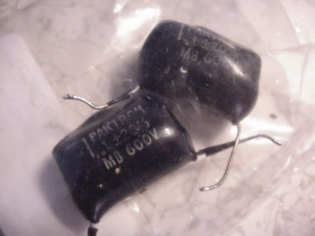

Reasonable is an understatement. Heaven sent. I just changed the cathode bypass caps. I know those old brown caps dont have a good rep but for now they will have to do. I am waiting on a parts supply. Are these old blue caps in the last pic better than the brown ones? I wish i had some more of the blue molded caps
Better? Not sure. But they are highly sought after.

Sorry FYL those blue caps in the bag or on the board now did not come from this amp. I have a ton of them in bags from over the years. I really dont know much about them. The blue molded ones i put on the board last night in place of the original brown caps. Plus i am using a .047 instead of the (2) .022 caps that were on the board. I got rid of the brown turd caps and put some Xicons in i have. Amp sounds better with the Xicon PI coupling caps and cathode cap changes made today /  :grin: :grin: :grin: :grin: :grin:
Oh well, could have been interesting.
Made by Ajax. Good quality Mylar film caps, most are still fine after 40+ years and don't leak.

What was bad about the brown caps anyway?
Poor construction, a lot of them have become leaky.
