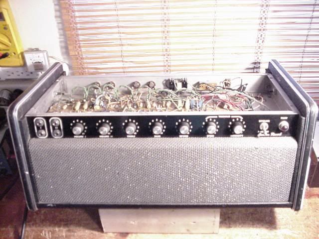

I just picked up this amp in trade for building a weber 6M18 TMD Kit
I cant believe this. The amp has never been cracked open / It was sealed so well i thought it might be the model that the top did not lift off from
All tubes are high end RCA including RCA EL34's with the dual top getters
I pluged it in and tested the bias and it is -37 ma @ 433VDC
I flipped the standby on and the amp is just incredible in tone / Not a crackle or noise what so ever / Reverb and Trem is sweet
It's the most quiet amp i have seen in a while. I at least expected the Mallory PS caps to need changing but there excellent
The sweet point here is the preamp stages are running at 132VDC & 146VDC & B+ is 433-35VDC

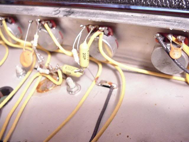

The pots are not date coded seeing as this was made in Canada so i have to find another way to date this amp
It has a 60's power cord on it with the small lines running the length of the cord
Anyone know how else to date the amp? Transformers is all i can think of when i can get to find the numbers

Rubber bumpers denote '70's, probably '72 or so:  http://www.0rigami.com/vb/models.html
There's probably a date code on the pots.

those power resistors look like they may have a date code on them. i'm thinking the electrolytics probably will too.
nice find.  :smiley:

Thanks all for the info. I suppose it is a 1972 model. This resistor says so
