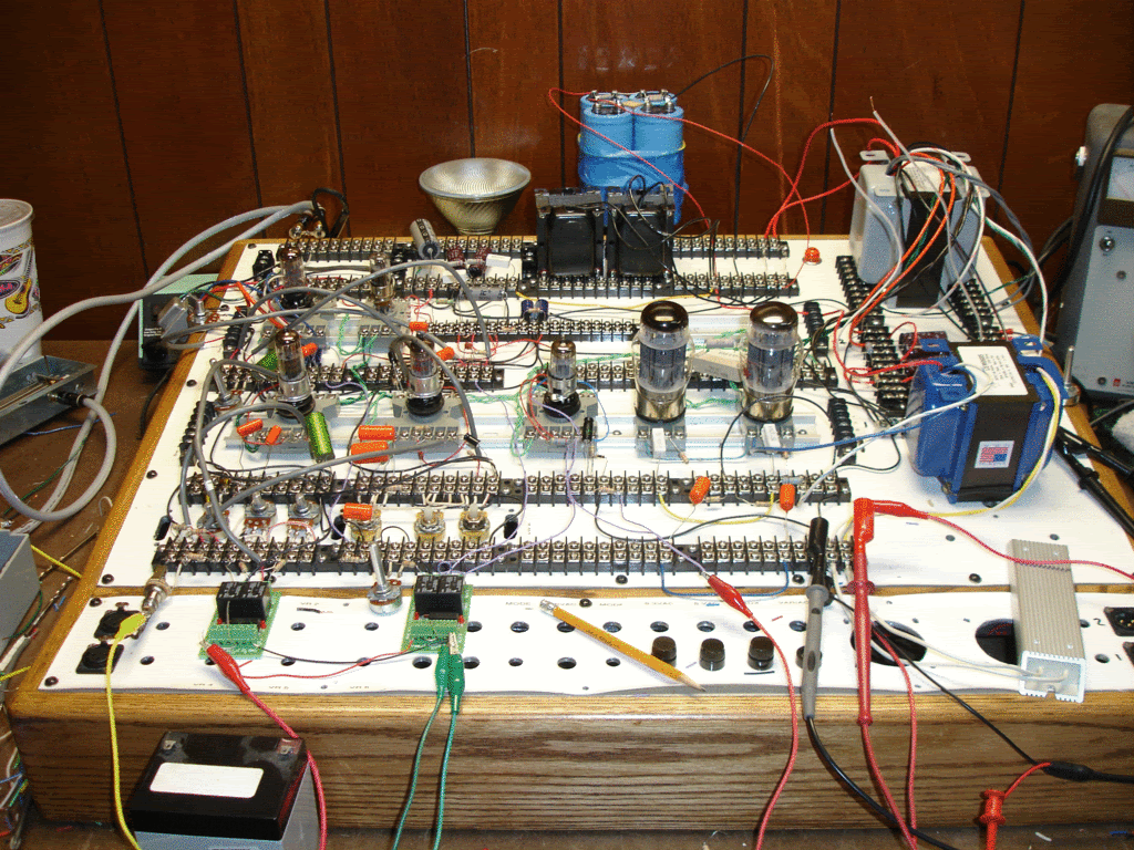

Offline RicharD
  • Posts: 2057
    • Toxic Water
Re: "breadboarding" amps?
« Reply #4 on: February 25, 2011, 08:37:58 am »
>What happens when you break a string and it goes flying into it?
Good point.  First off, I use D'Addario strings which just don't fly apart.  They seem to be the only strings which can survive my gorilla hands.  They last and they stay in tune.  I still think Slinky's sound and play the best but they just don't last.  Here is a picture of my bread board.  You will notice the power supply is in back.  I prototype everything this way so as to keep the most lethal parts somewhat out of reach.  We also know not to lean in and make adjustments while holding a geetar.  I am an electrical contractor by trade so grounding posture is 2nd nature to me, still I also know that when you get too comfortable is when an accident can happen.  I'd be telling a lie if I said I've never gotten bit by the Zilla board, but I've never actually been hit hard fooling around with it (knocks on wood).  The last time I got the peepee knocked out of me was from a split chassis Silvertone.  It has a Molex connector that carries power and a RCA connector that carries signal and the only ground.  I had forgotten to plug in the RCA and did it hot while holding a guitar, a mistake I won't make again.  The last big scare was when one of my kittens jumped up on my bench.  I now make sure they are not in the lab when I'm messing around. This is a dangerous pass time we share.  It's always good to discuss safety precautions.  The only shoes I own are insulated work boots and my eye glasses are plastic lens safety rated.  The best advice I have is something I tell all my employees:
If you're not 100% comfortable doing something, then don't do it.
My protoboard has 3 power supplies in it's belly.  6.3VAC @ 8A, 12.6VAC @ 4A, and 0 - 140VAC @ 5A via a Variac with an output voltage meter and current meter.  I can roll down the HT leaving filaments hot while I make changes.  As dummyload (formerly ISOTone) says, it's a lot of fun.  I can change a pot in 30 seconds.  I can build a Champ from scratch in about 30 minutes.

 That is just so freakin cool. Are those screw strips from Radio Shack? I was thinking of doing something like this and I think you've inspired me to do so.

allied electronics has a nice selection. it is difficult to find them with wire clamp screws - most have a binding screw which is made for a single solid (or tinned) wire looped around the screw shank. the wire clamp screw has a free-wheeling flat washer that can clamp down several wires of similar gauge.
the part for the # for the wire clamp screws is 515-0073 - link below has a pic. they are kind of pricey, but overall, it's easier to buy the screws than try to source the barrier strips with wire clamp screws. buttery found the last box of 50 count .325" 30 pos. w/ wire clamp screws in the US. at first tyco did not want to sell such a small quantity direct, but buttery somehow convinced them to do so.
https://www.alliedelec.com/search/searchresults.aspx?N=0&Ntk=Primary&Ntt=515-0073
use DIN mount octal relay sockets for octal tubes (duh!) and 7 pin tubes. use 11 pin DIN mount relay sockets for 9 pin tubes - this is the fast track. in version 2 of buttery's, i designed the PCBs that you see that hold the sockets. i never finished mine - it took us two days to machine buttery's on my sloooow CNC machine and i lost interest in the plan after playing with the .325" spacing barriers strips - use .375" spacing parts - they are longer but multiple wire connections are more manageable. did i mention that don't like the .325" spacing barrier strips? not at all. if you want the PCB artwork send either of us a PM.
be careful! my protozilla has only bitten me once, but admittedly i was doing something foolhardy to begin with. i have both version 1 models in my lab, after buttery and i machined version 2 for him, his original was gathering dust in his garage and i couldn't bare to see it unused. buttery built the cabinets for both version 1 boards - he did a beautiful job.
we have hashed out a version 3 of the board that uses a simpler mounting method for the PCBs' (not as complex to machine), it is longer to accommodate .375 spacing strips with more tie points, it has a universal mounting plan for X mount type transformers (Z mount is PT mounting type you see in fender BF and SF amps) and it is larger (20" x 36"). it will likely be machined by a 3rd party.
you could build something similar with the .25" spacing radio shack strips on a piece of lumber on the fly on the cheap - most decent electrical supply houses sell the DIN rail and DIN mount relay sockets. some supply houses even sell the barrier strips, however, most seem to only carry the .437" spacing items.

those are 680uF 450VDC computer grade electrolytics... i guess you could call them batteries!  :wink:

I designed mine primarily off the tubelab modular design, but was greatly inspired by the pair DummyLoad & Buttery built. I like that I can quickly wire up little sections while looking after my baby daughter then take them out to the workshop to plug in when I get a chance.
Here's one channel of a 6BM8 (triode-strapped pentode) SE "hifi" I'm building:
Ignore the pine plank with the PSU on it, that's my stand-alone PT test jig.
There's a solid core ground bus running the length of the board along with two lots of twisted pairs (10A each) for AC heater supplies.  On the shelf behind the board is an 8A variac, a 450VDC@275mA heavily filtered supply and 6.3VDC@3A along with function generators, and scopes which I use with this breadboard.
I spent a long time deciding on the size of the breadboard, what features to build into it and which ones to leave external (eg: no inbuilt variac etc), but now that it's built and I've used it for a couple of different circuits I'm VERY happy to have built it. Experimentation rules.  :hello2:
