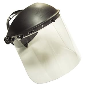

Woodworkers use a $20 full-face shield.

« Reply #15 on: March 16, 2011, 09:28:59 pm »
I like those full-face shields. They still can fog up a little, but a lot less than googles.
I'm drilling out a chassis right now and am using one. Also much easier to lift up to see when not needes, instead of moving the googles. Plus they don't hurt your face.

Well, maybe it is only for TV shows or when OSHA is inspecting.
SAS Safety 5140 Clear Full-Face Shield - List Price: $17.35 - Price: $14.06
http://www.amazon.com/SAS-Safety-5140-Full-Face-Shield/dp/B000M603GI

Yeah that's the one we have.  There are actually just a few things we do use it for, but for most of the things we do they get in the way, if they aren't down right dangerous.  Truthfully, the most important thing is to use your mind, and to understand the way a tool might fail.  Some tools self feed, so you don't want your hand anywhere it might get pulled in and cut off.  Other tools will try to kick back, and then you need to make sure you are not standing in the path of whatever will be shooting back at you.  Then there are routers, which can do both, depending on how you are using them.  And of course, the scariest tool, the shaper, which is like a router on steroids.  With either of those, you mostly just want to make sure that, if it grabs, it doesn't pull your hands into the bit by holding the piece so your hand will only be pushed away from the bit, not into the bit.
