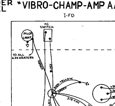

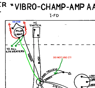

The layout for the blackface Vibro Champ shows to ground to chassis pins 7 (Octal) and pins 9 (preamp). To use one 6.3vac wire out from PT to all heaters (pins 2 and pins 4/5). Can't I just wire the heaters like I would a AB763 Fender amp? Using (2) 100 ohm resistors from pilot lamp to chassis ground, and omitting use of the Center Tap to ground for the 6.3v heater taps?
See 2 pics below. One is stock wiring, other is the way I normally wire from PT to heaters.
Is there a reason Fender wired the heaters the way they did? Should I wire it exactly like the layout says?
Original wiring of heaters.
Modified wiring of heaters.

mostly all amps of that era were wire the Fender way.They simply didn't know about twisted AC wires or chose not to do it.If you have an original Vibro-Champ then you know they are quite quiet wired the old-school way.
  Either way works just fine.There is no discernable difference between using the 100 ohm virtual center tap method vs using the center tap.

Question: On original wiring, did Fender use the CT plus only one GREEN secondary tap soldered to one leg of the Pilot Lamp? Then they run the second leg of the Pilot Lamp to Ground? I am not getting how they got 6.3vac out of one secondary tap. Did the original PT's only have one 6.3vac secondary tap?
I have the MM PT and it has the 2 green secondary heater taps, and the green & black CT. If those Vibro-Champs were quiet running amps with the old school wiring, it would save about a foot or so of heater wiring. I just have always read that it was better to run (2) 100 ohm resistors (virtual CT) from pilot lamp to ground, and it may save your PT if a filament was to short to the plate. Plus twisted heater wire will cancel hum if you keep all the soldered ends to sockets in correct polarity.

On original wiring, did Fender use the CT plus only one GREEN secondary tap soldered to one leg of the Pilot Lamp?  No check the schematic:  http://www.el34world.com/charts/Schematics/files/fender/VIBRO_CHAMP_AA764.pdf
Stock, there is no CT in the filament supply, only 2 green wires; one to ground as shown on the layout diagram.  This is a 6-0 tranny.  Hence there is no humbucking for the AC filament supply.  Adding a virtual CT makes the filament secondary 3-0-3.  Now you can run a 2-wire supply which provides humbucking.  Twisting the 2 supply wires together further reduces hum.
Per Psycho, I agree that my VibroChamp was not noisy to begin with.  But after upgrading the filament supply to virtual CT with twisted pairs, it is dead quiet -- even after boosting gain.

Look real close at jojokeo's picture of the chassis wiring. One green filament wire from the PT is soldered to the chassis. Each tube socket has one end of the filament grounded by running a wire from the tube pin to the chassis at the socket. Now, if you look hard at the pilot light assembly, you will see the lug that contacts the bayonet portion of the lamp is spun around and soldered to the frame of the pilot light assembly (obviously before installation).
Spinning that lug is how the earlier Fender amps grounded one side of the pilot light, so that it would actually light up when using the 1-wire method. It's also why you'll blow fuses when you try to rewire a 1-wire system to a 2-wire system, if you fail to unsolder that tab and run a wire to it.

single output tube class A1 amps don't have hum-bucking attributes. there is no P-P for hum-bucking. leo knew what he was doing. wire it the leo way. save wire. save time. save 2 resistors. save $$. --DL
We're not talking signal humbucking here, which is not present in an SE amp anyway. He're we're talking humbucking of the 60Hz AC filament supply.  By using a 3-0-3 filament tranny, the 60Hz filament hum is bucked in the tube's heaters (or in the cathode of a directly heated tube).  Optimal humbucking is achieved if the 3-0-3 supply is perfectly balanced.  Sometimes a hum balance pot is used for this purpose, in place of a pair of resistors for a virtual CT.
