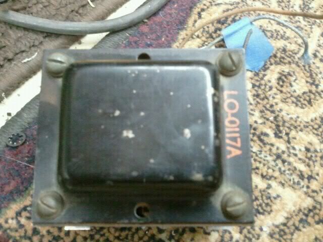

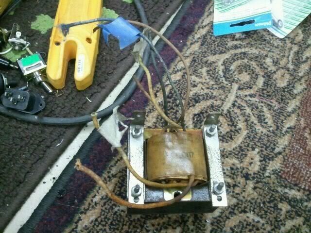

I got this output transformer for an amp that I am building, But I have no idea what it is, or what each wire does.
The only markings on it are LO-0117A
There are 7 wires total coming out if it and 2 more that were cut off.  The wire with the masking tape is labeled 8 or possible has the infinity sign on it.  The wire with the blue tape is marked 4.
How can I tell what wire does what? Or what exactly I have here, specs, etc...  Sorry, but I am really new at this.  The only testing tool that I have is the voltmeter that is in the picture.
Thanks!!

First thing to do is identify all wires as they relate to windings. IE, use your ohm meter to determine which wires have continuity or resistance to other wires. Put one lead on one wire (any wire) and check for resistance to every other wire. Group all wires that have any resistance reading to the first wire. Either twist together, tape together, or put a cable tie around the group. There should be some more wires left over. Repeat the above process to find all wires that have continuity to other wires again. Hopefully you'll only have two groups, but if you still have wires left over, repeat this process again.
If you have more than two groups, the transformer 'may' not be an output transformer, or may be a special case OT. I'll assume you only have two groups and this is really an output transformer. One group will have a low resistance (only a few ohms or less than 1 ohm) reading between wires. This will be the secondary winding. The other group will have a higher resistance (maybe a few hundred ohms) between wires. This will be the primary winding.
Report back with your findings and the measured resistance readings for all wires. Then we can go to the next step.

OK, there are 2 groups of wires.  1 group of 3 and 1 group of 4.
Here is how they Ohm out:
Group of 3 has 2 light wires and 1 dark:
Light 1 to Light 2 = 207 ohms
Light 1 to Dark = 403 ohms
Light 2 to dark = 196 ohms
Group of 4 has 1 dark wire, 2 light wires, and a reddish wire:
Light 1 to light 2 = 1 ohm
Light 1 to Dark = 1 ohm
Light 1 to Red = 1 ohm
Light 2 to Dark = 1 ohm
Light 2 to Red = 1 ohm
Dark to Red =  1 ohm
Also in the group of 4 the 2 light wires have tape on them. 1 labeled 4, the other 8.
Here is my guess:
Group of 3 wires are the primary and the dark is the center tap.
Group of 4 wires dark is ground, red is 16 ohms, and the 2 light are as marked
Am I right here?
The highest reading has to be between the two outside wires of the winding. That means "Light 1 to Dark = 403 ohms". And that leaves only Light 2 to be the center tap.

dark to light 1  gives me 3,4,6 volts
dark to light 2 gives me 6,8,13 volts
light 1 to light 2 gives me 6,9,13 volts
does that make sense?  I am not sure we have the center tap correct, Or I don't understand something here...  shouldn't the center tap give me less voltage?

Light 1 to dark gives me half the voltage of light 2 to dark, or light 1 to light 2.
Does it boil down to me using the 2 wires that give me the highest voltage as the outer leads?  If so then light 1 to light 2 is slightly higher.  I guess it makes sense to have the dark wire the center tap.
This means Light 1 and dark are your outer leads (brown and blue typically), and light 2 is your center tap (red typ.).

Does it make sense that the center tap puts out more voltage.
ABsolutely!
It can be confusing when dealing with transformers, turns ratios, resistance, etc. Hopefully this simple drawing will drive home the idea that applying a voltage between center tap and end of winding will cause a BIGGER voltage on the secondary than you would get by applying the same voltage across the entire winding. I used simple numbers in my drawing to make it easier to get the concept, but the principle applies to your transformer as well.
Your resistance readings proved that wire "Light 2" is your center tap. And your voltage readings offer further proof that the wire "Light 2" is the center tap.
