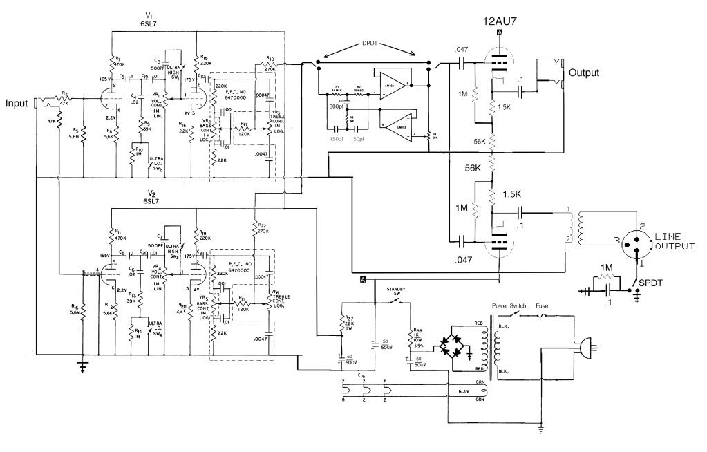

« Reply #54 on: November 02, 2011, 10:08:11 pm »
Here is where I am at now:
Will I need some sort of resistor for the B+ to the CF now that I am using both sides of the 12AU7?

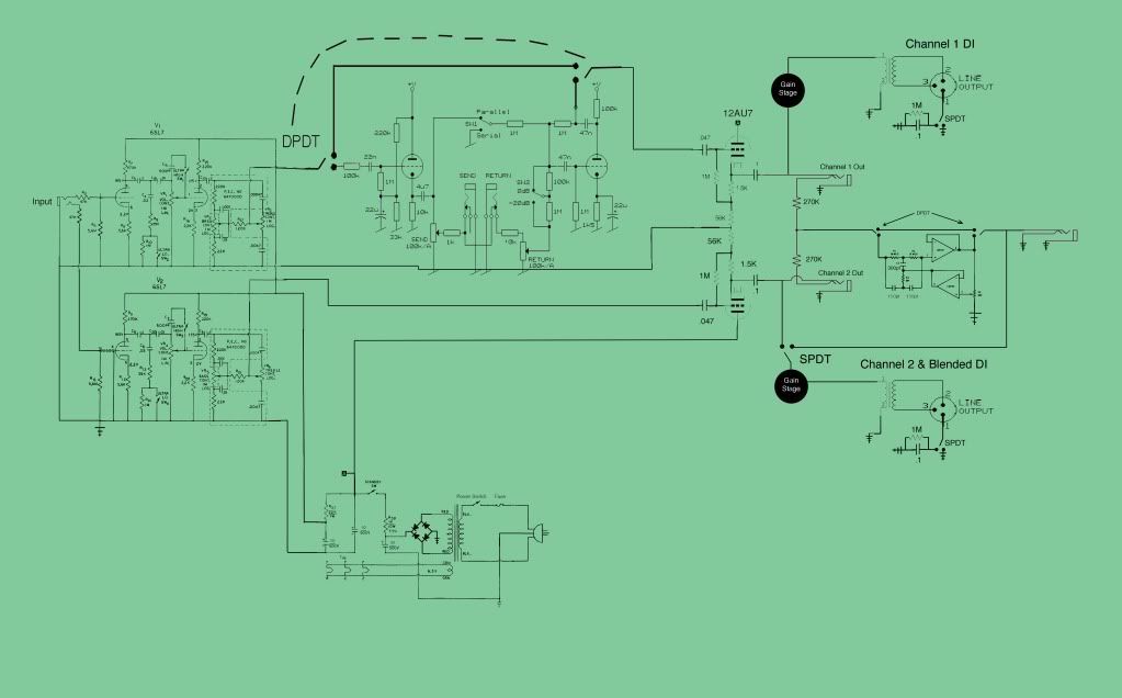

« Reply #62 on: November 03, 2011, 11:33:05 am »
Here is another feature I would like to add:
An Effects loop with 3 switched posisitions:
1.  Effects loop off
2.  Effects loop on
3.  Effects and clean thru, with a blend pot so I can blend the clean signal with the effects signal.
How would I do this?

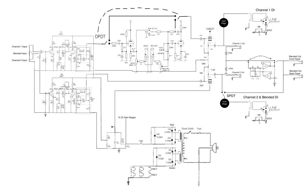

« Reply #70 on: November 04, 2011, 11:21:35 am »
I sketched up a topology.

you might KISS, and simply add stereo option like this:
Then, later,, when you are happy with that, and you have some money, do something like this:

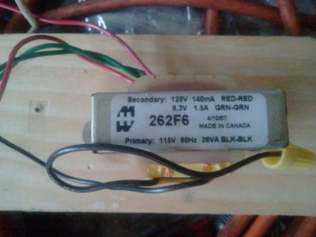

Here is my transformer, I seriously doubt it will work:

It'll actually work perfectly using voltage doublers.  120VAC into a doubler will give you close to 300VDC.  You have to figure 50% for current.  Your PT is rated for 140mA so we get 70mA out of the doubler.  I doubt your circuit will hit 1/2 of that so you're cool with room to grow.
Filaments.....  I'm gonna push 12VDC for the filaments.  First off you need 12VDC for the Opamp.  Secondly DC is quieter.  Finally this is not a PP amp so you don't get any canceling.  With proper layout, AC filaments would be fine but...... trust me on this one.  The Dc might come in handy if you do any relay switching.  6.3VAC into a doubler will give you about 14VDC.  Hit a little 12V regulator and call it good.  So you have about 750mA available.  2 6SL7's in series = 300mA.  Each 12A*7 tube at 12V = 150mA so right now you're at 600mA.  That leaves 150mA before you snag a handful of mA each for LED's, Opamps, relays -n- such.  Call it just enough filament supply.

1.  Yes.  Your 2 6SL7 filaments stack in series to =12V.  Current stays the same in series.  Load = 300mA.  Each 12A*7 tube draws 150mA.  You do not connect pin 9 to anything.  You're limited to 4 tubes no matter how you slice it with the PT you have.  You could always use a 2nd filament power transformer or compromise.
2.  No.
3.  To be determined.  You need 3 right off the bat to make a voltage doubler.  Add 1 more for each voltage node.  Truth be told, it could all hang off 1 node, but isolation is isolation.  For right now lets look at it as 1 node.
See attached.
This is a voltage doubler full wave rectifier.  I'm ball barking 25 to 10mA.  The current transition is graphed at 5 seconds.   Call B+ = 315V.  This swing does not occur in real time but is simply to demonstrate the loading of your transformer. 3%, don't lose any sleep fretting about this.

OK, here is where I am at this point:
Still need to figure out the correct way to do the gain staged for the 2 DIs and the power rail.  But I really like the way this is coming together.

In this schematic I added inputs for channel 1 and channel 2 separately.  I figure why not have the option if I want to plug a couple acoustic guitars or something else in.  I still have the "stereo" input for my bass.
Also, I did the power rail and the 12v heaters, and got my front and rear blended outputs back.
I still need to get the exact setup for the DI gain stages. And I think I am going to have to add a 12v tranns for the other tube and the OpAmps.
« Last Edit: November 05, 2011, 11:27:10 am by blown240 »

You drew both of your voltage doublers shorted.  Gonna wanna use a regulator in the 12V circuit.  You need to design in compartments, preamp 1, preamp 2, summing, effects loop, notch EQ, direct outs, B+, filaments, and controls.
Offline blown240
  • Posts: 409
Re: Ampeg Based Piezo Preamp Build
« Reply #83 on: November 06, 2011, 12:15:17 am »
So the line that parallels the 220uf isnt supposed to be there?
Ya, Or I may just do with a 12v trans, I have to have 5 tubes anyway, so the one I have wont be enough.
You mean break down the schematics into sections so they are easier to read?  Like a MESA schematic?
[/quote]

« Reply #84 on: November 06, 2011, 08:48:23 am »
Here ya.  I got bored last night.  No notch filter or effects loop.

Wow!!  Thanks so much.  Thats Perfect!
And once I get to the point where i add the effects loop and notch i can easily integrate them with their own 12v transformer.   Thanks Again!!

It'd be a good idea to completely review this schematic.  It was late and I was drinking.  There should be enough 12VDC for the opamp circuit although the LM102 is an antiquated part.  I think pretty much any old opamp should work.  You may want to think about replacing some switches with 12V relays but I think your $200.00 budget is already shot.  While on the subject, a time delay and output relay is also in your best interest.
I question summing off the 2 tone stacks.  Yes I realize this is how Ampeg did it but it seems like the 2 tone stacks will interact with each other.  There will be some loading factor, ie. when switching to mono, the output will be somewhat diminished.  This may be the "magic" of the circuit.  I didn't bother to recalculate the gain of the previous stage with the additional loading, but I'd bank on losing at least 3dB if not more.
