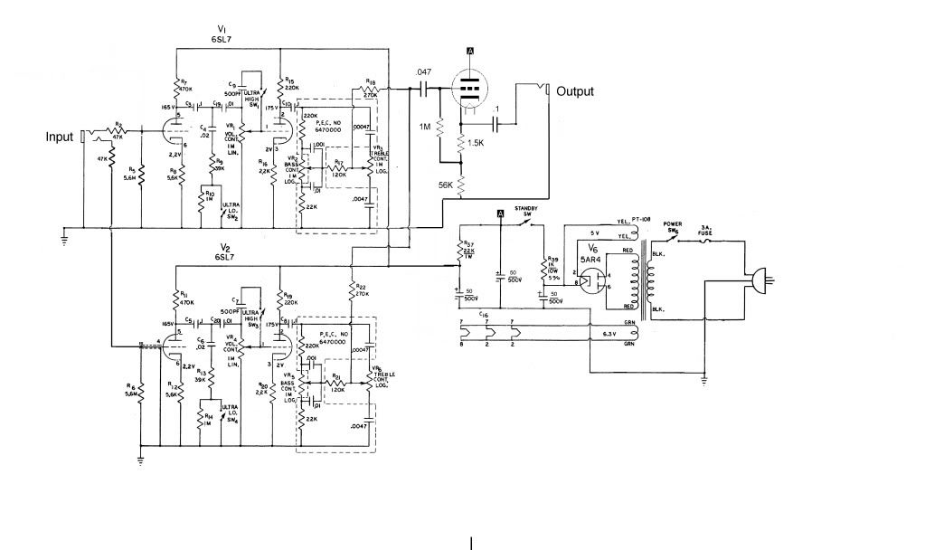

Here is a schematic for a b15n for reference:

Offline birt
  • Posts: 706
Re: Ampeg Based Piezo Preamp Build
« Reply #2 on: October 29, 2011, 03:44:05 pm »
if you make only one input for each channel (the one with the 100K for example) then you don't have the 47K to ground from the other input. this means the 5M6 resistor is more or less the input impedance. good for a piezo.
this will also boost the signal a bit when compared to the original circuit. you might use a lower gain tube so it will be cleaner. it doesn't matter for the volume because the FOH mixer has loads of volume for you ;-)
can you post what is written on top of that transformer that you have?
you might want to look into good passive DI transformers so you can have a balanced XLR output without having to use a separate DI. add a jack output too and you can plug into a poweramp on stage at the same time.

Here is a schematic I did to start with.  I still need to make sure the input impedance is correct for a piezo.  And I need to figure out where to put the notch filter(s) and exactly how to do them.

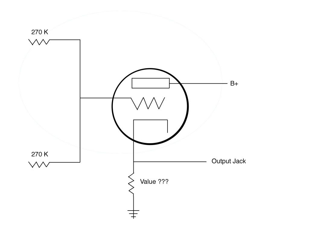

The two 270K mix network is just strong enough to run inside the box, maybe thru a short cord.
You need more beef to drive modern power amps and long runs to sound system.
Don't over-think the input impedance. After all, you can always change it on prototype.

« Reply #8 on: October 30, 2011, 01:19:34 am »
I never even considered that.  What should they be?  100k?

Changing the mix resistors is not the answer. Put a cathode follower between the mix resistors and the output jack.

Ok, Thats easy enough.  Something like this:
What value should the load resistor be?  And what tube should I use that will color the sound the least.  And does it matter what filter cap to get I get the B+ off of?  I can add another since I was going to get cap cans anyway and would have an extra.

That's basically it, but you need a wee bit more to bias the CF and block the dc voltages. This should work. The input cap can be a small value .001µF to .047µF) since the bootstrapped grid circuit is very high Z. The output cap should be larger (0.1µF to 0.25µF) since it's in a much lower Z circuit. Caps are easy to play with if you don't like those values.
Some of the other guys can put you on a tried and true CF circuit. You may even consider a MOSFET source follower.

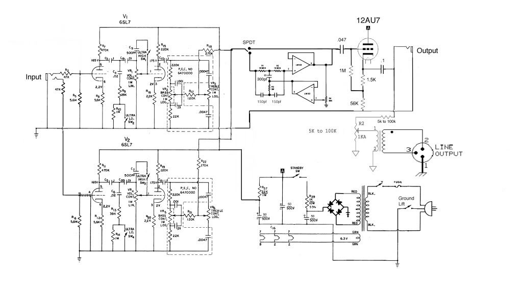

Here is an updated schematic:
I was looking at a pic I have of the trans that I going to use.  There are only 4 wires coming out of the secondary side.  1 pair is the heaters.  I am not sure on the power of the 2nd pair.  I may have to go with a SS rectifier because of this.  Which is fine I guess.
So I still need to figure out:
1.  Notch filter at 100k
2.  What tube to use for the CF
3.  If my trans will work with a tube rectifier

Here is the updated schematic:
Couldn't I just use a cap in parallel with a resistor to make a high/low pass?  Use the cap to cut out everything below 120hz and the resistor to cut everything above 80hz.  It seems to me that in the end there would be a cut from 80-120hz. Maybe put this in series between the 270k resistors and the CF, and use a double pole, double throw switch to take it in/out of the circuit.

« Reply #23 on: October 31, 2011, 11:21:21 am »
take a look on how the filters in a graphic EQ work. i'm sure you can find schematics for that. there's also stompboxes lie the Boss GE-7 that you can look at.
and don't forget you will need a DI when you plug this into the sound system of a venue. you might as well add a transformer and XLR output to your preamp.
for hi-pass 'yes', for low-pass, no.  for low-pass, you can use a cap, or a set of parallel caps and resistors to ground.
BIRT has a good suggestion about the XLR balanced output.
I've built a few tube pre-amps,  here are some thoughts:
1.) have a ground lift switch,  if you plug this into an amp with unbalanced signal (1/4 inst. cable)  and both the preamp and the amp have 3 prong plugs, you can get ground loop noise.  the shield on the inst. cable will provide path to ground from with the chassis.   This is different than a ground lift switch on a XLR/balanced output box, but you can have a ground lift there as well (for pin 1).
2.)  re-evaluate the tube rectifier.   pre-amp tubes won't draw enough current to ever get a tube rectifier to cause sag, and I'm not sure there is any reason beyond that to use them.  If you are modeling your engineering of Ampeg, they switched to SS as soon as they could.
3.) Triode transformers makes a nice Dynaco pre-amp PA211/PA522 that is  a 330-0-330 and 12.6v/900ma filament transformer that works well for this application, tho its 12.6v, not 6.3v and I see you'd like to use 6SL7s.   If you reconsider and decide (1) use 12SL7s or (2)  decide to use 9A based tubes (12ax7/12au7 etc), this is a perfect tranny.  I've used the International version PA522 (which has 120v and 240v windings) by using the 240v windings with 120v USA wall power to produce 165-0-165 and 6.3v secondaries.
4.) you've got stereo inputs, you could add extra switched output jacks to have optional stereo outs,  pre-mixing resistors...
5.) you've got a 12au7 enlisted for the CF, you've got another section there for another CF out (maybe for the other channel,  or to drive a transformer XLR/balanced out.
6.)  that preamp has enough gain to hit a power-amp section, you might want to tame it down with lower Mu-triodes (6SN7s, or 6072As, 6211s, 12AU7s).   If you go with 6SL7s (or 12ax7s), your usable gain will be between 0 and 3 on your volume knobs,  I suspect).
7.)  9A based tubes will give you a lot tuning of the overall gain,  with an 8BD pinout, you are limited to 6SL7s and 6SN7s, with 9A's, you can you use 12au7s and 12BH7As all the way up to 12AX7s (there are about 10 different Mu tubes in between).

Thanks for the reply terminalgs!  You have some good ideas.
1.  Ground switch - will do, thats a no brainer.
2.  Going to use a solid state rectifier.
3.  Transformer - Hopefully the one I have will work.  If not my local amp guy has loads of them that he sells CHEAP to his buddies.
4.  Stereo out - I may do this after the initial build is done.
5.  How could I use the other half of the 12AX7 to drive a transformer XLR out?  What would the circuit look like?
6.  I will see how it sounds with the tubes and switch them out of need be.  Another advantage of my local amp guy!
7.  I really want to try the 6SL7, if that sucks, then I may switch to 9 pin.

>ground lift switch
Last several pres I've built, I've blown off the switch and just simply wired the output lifted.  You run it grounded unless it it buzzes, then you lift it.... which never buzzes.  I 100% think you should conjure up a post EQ direct out.  Your instrument, you're the player, you should be in control.  I have a tried and tested bass preamp circuit that everybody who has used it loves it. Drop me a line if interested.

I got your PM and I have attached the last (I think) schematic.  This circuit is loosely based on the STV Channel B preamp.  This is the side without all the cool inductors which in 2011 are unobtainable. (L to R)  V1b was changed to a plate follower to reduce gain and distortion.  S1 inserts a RC circuit that cuts the lows @ 20ish Hz.  It also loads V1b but doesn't really cut volume all that much.  It's the magic button when feeding a Big BooM PA.  R6 through V2b are a direct copy of the SVT sans the summing network R19 & R14.  V2b is the HiZ output (J2).  I added V2a to drive a DI transformer.  Yup, I know you don't wanna add another transformer but life is cruel that way in the world of tubes.  It's designed around a cool old Peerless 15095 transformer.  15k:600 ohm plate load.  We had a few of them and they're too cool not to use.  The Edcor XSM10k/600 will do the job just fine.  http://www.edcorusa.com/products/160-xsm10k-600.aspx  It's $15.00.  The B+ is pretty straight forward SS full wave recto.  I did 12VDC regulated filaments.  The 555 timer is simply a 60ish second delay that keeps the outputs disconnected (via a very poorly drawn relay) until the filaments are hot and the circuit is quiescent.  The little relay and timer thang is good to have.  This circuit goes NASTY for about the first 5 to 10 seconds.  It's all food for thought.

OK so here is where I am at.  I have added the balanced DI out, the ground switch and the variable HZ cut.
What do you guys recommend for:
1.  The first resister on the XLR DI out.  It can be 5k to 100k.  What should I start with?
2.  will the SPDT switch work for the notch filter, or should I use a DPDT to completely remove it from the circuit?
Thanks!
« Last Edit: November 02, 2011, 12:10:50 am by blown240 »
« Reply #37 on: November 02, 2011, 12:20:02 am »
1.  The firs resister on the XLR DI out.  It can be 5k to 100k.  What should I start with?
Probably a 50k trimpot in series with your actual level pot.
I don't know what signal level your line out needs to supply. We can guess your preamp should output 1v or less of the normal signal, and if we knew the required output for the XLR, we could figure a ratio.
But it's easier to just add a trimpot, turn your level full up, then adjust the trim for the max signal you'll likely need. Button up, and your done.
DPDT.
The variable Q pot of the notch is a 50k load that is fine for the opamps, but too low for the tube stage ahead of it. You want to be able to completely bypass the notch filter when it's off.
And a question you didn't ask:
Don't do the ground-lift the way you've drawn. The 3rd prong should always be attached to the chassis of any amp/preamp. If B+ is shorted to the case, you want a breaker to trip, not you to trip after you get zapped touching the case. I've grabbed ahold of 450vdc before... it's not fun.
If you really want to incorporate a ground lift that works, but is safe, you need to use isolated jacks, and have a ground buss on the circuit board for everything with a ground symbol. 3rd wire of the power cord gets connected to the case. Connect a 100pF cap and 50k resistor in series.  Connect this resistor/cap combo across a SPST switch, which has wires running to your wired ground system and the chassis (close to the 3rd prong wire).
It works like this:
If the switch is closed, the circuit ground is connected to chassis ground, which is hardwired to the 3rd prong.
If the switch is open, circuit ground is disconnected from chassis ground. 3rd prong wire provides shock safety. 100pF/50k combo connects the circuit ground to chassis ground at radio frequency, which helps keep RF buzz/noise out of your circuit. This particular combination is -3dB down at about 31kHz.

So a 50k trim pot, sort of like a bias pot.  What does that resistor actually do? is it even necessary with the level pot?
SPDT - will do, makes sense.
Ground Switch.  Is it even worth the hassle? Seems like if it had a ground loop thru a cable to a power amp, it wouldnt matter if there was a chassis ground thru the power cord.  It would ground to the power amp thru the cable.
« Last Edit: November 02, 2011, 01:07:05 am by blown240 »

don't rely on a cable between devices to provide a ground path like that. (it can be helpfull in some situations but since you are designing something you better go for the safer way)

Good Point.  I suppose an easier way to do it would to use a non conducting chassis.  I had planned on a 16aug steel chassis, because I have a ton of 16aug sheet metal.   OR I can isolate the pots and jacks from the chassis.  I guess that isnt too bad either, just a bunch of nylon washers...

Re input impedance matching:  I'm not sure what your input impedance is.  It looks like the incoming signal is split so there's about 2X 6M in parallel = 3M.  Piezo's usually have about 6M output impedance, so 3M input impedance is rather low.  It might work well enough though.
FWIW Merlin recommends a 12AX7 cathode follower (not preceded by a gain stage) as the input stage for a piezo PU.  It has an effective AC impedance of 6M.  Designing Tube Preamps for Guitar & Bass.  This equals the input impedance of hi-end SS acoustic guitar preamps.
Another alternative is an outboard SS preamp/buffer designed for piezo's, in front of the amp.
« Reply #43 on: November 02, 2011, 03:46:42 pm »
No, he's got _2_ piezos (bridge and fingerboard), wired with one 3-conductor cable and jack. Each piezo sees 5.6Meg.
He can readily try 2Meg or 22Meg just by changing resistors.... no need to fret about it before the Build.

You're missing the boat on the ground lift.  I don't think it's safe IMO to float a HV circuit.  All you lift is pin one of the XLR output.  This prevents the possibility of a loop through other equipment down stream.
Offline blown240
  • Posts: 409
« Reply #45 on: November 02, 2011, 03:54:11 pm »
OH YEAH, I missed that one for sure.  Well thats a whole lot easier!
Ok.  Then that's as good as it gets!
