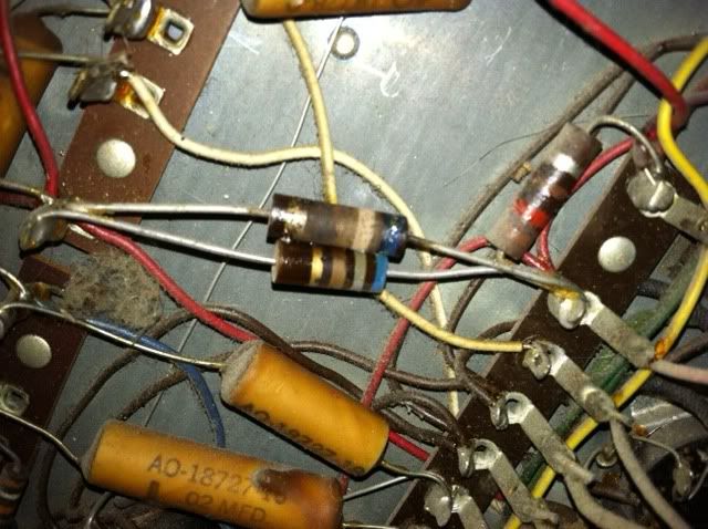

I was putting new electrolytic caps in my organ tonight and I ran into a snag...

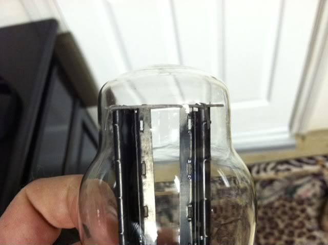

I got them all in and bundled nice and cleanly and I went to turn it on.  A split second before my 3amp slow blow fuse went out there was "lightning" in my rectifier tube. (shouldnt have used a slow blow)
Come to find out I installed the caps backwards.  I thought the crimp was in the negative end and the stripe was on teh negative end of caps with both leads on the same end.
So I reversed all the caps and tried to fire it up again.  I guess I must have fried the rectifier tube because 2 of the 680ohm resistors started smoking.
Does this make sense, or am I missing something?  and just to clarify, what lead is the negative and positive on electrolytics?  I guess I am looking at a new rectifier tube and a couple new resistors.

usually a rectifier tube is working or no. So if it is producing enough voltage to make the resistors smoke, it's probably fine. On the celectrolytics caps the positive end is marked with a "+" and negative "-". On a guitar amp I would normally pull the tubes to take the load off and turn it on to check voltage output of rectifier, but with all the tubes in some organs it may be a problem to do. Something you changed is still amiss! Look closely. Platefire

I am going to take the rectifier tube to my amp guy to test tomorrow.  And get the replacement resistors.  The caps I got are not marked with a + or -.  The either have a crimp, or a silver stripe depending on the way the leads come out.

I will build a lamp limiter today and redo all of this.  I hope I didn't fry anything else, but it seems to be limited to the power rail.

Also, if you have spare parts on hand you can temporally bypass the rectifier tube socket with a pair of SS diodes.  (Add a power resistor, say 100R 25W if you want to keep B+ down).  That should give ballpark correct, unloaded & loaded voltages, maybe save another rectifier tube at start-up.  And the project can go forward without waiting for the tube.

Looks like I fixed it!
I built a lamp limiter ($10.01)
Got another new set of Electrolytics installed
Borrowed a 5U4 from another amp
Them I fired it up with the lamp limiter. It took about 20 seconds before it really dimmed down, but I figured with all the circuitry and caps in this organ that may be about right.  So I unhooked the limiter and now the organ sounds FANTASTIC!  Its amazing what $20 in new caps will do!
