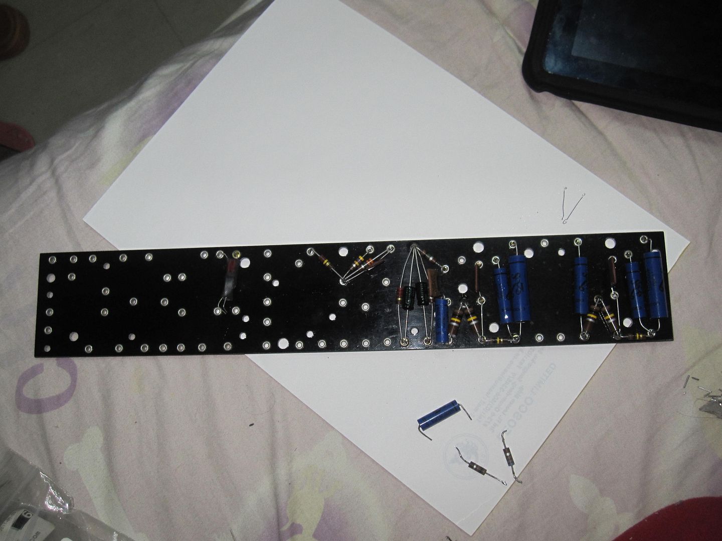

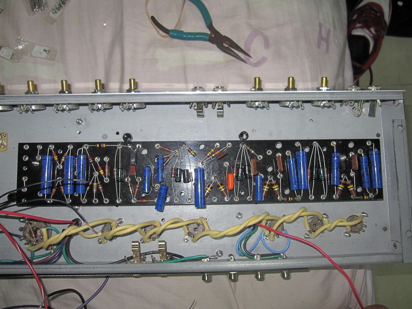

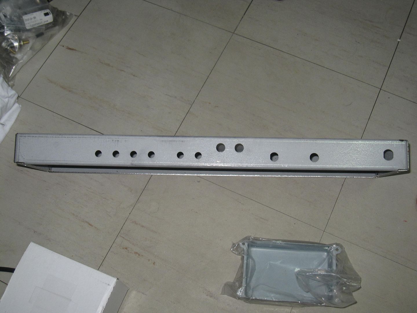

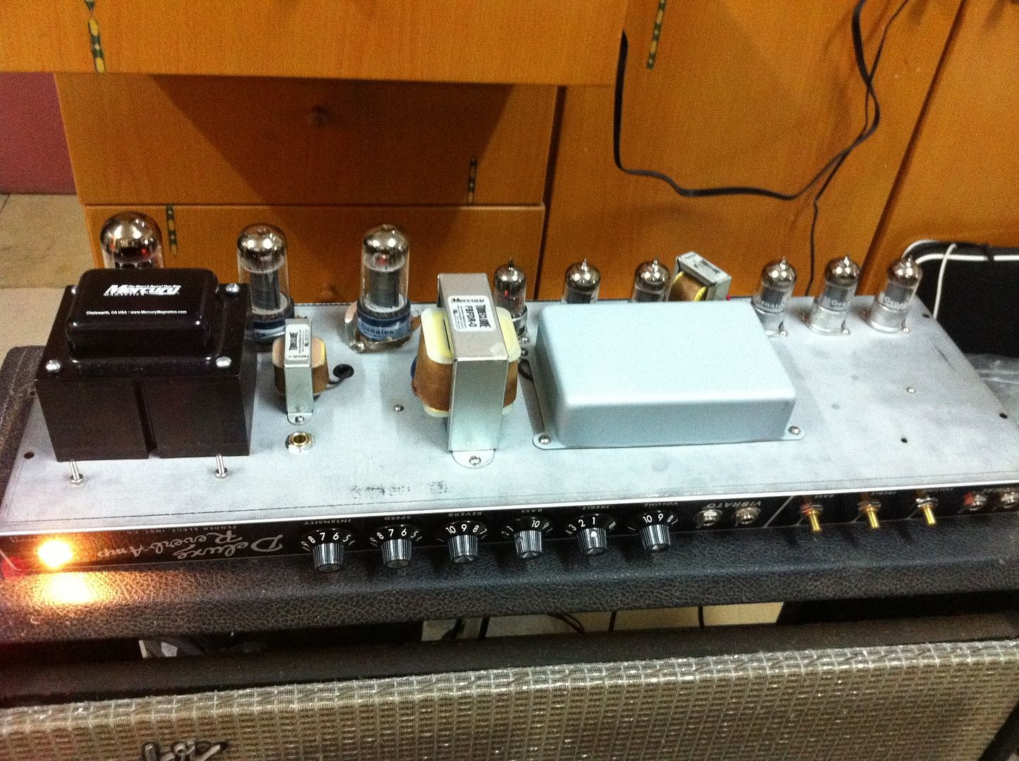

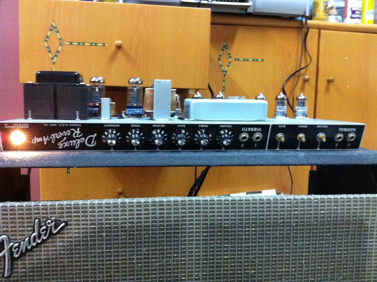

thank you for your help. i learn a lot from here. i build this amp very successful this time. i just get the hum noise problem when i first to turn it on. after fix it 30 min, everything is perfect.

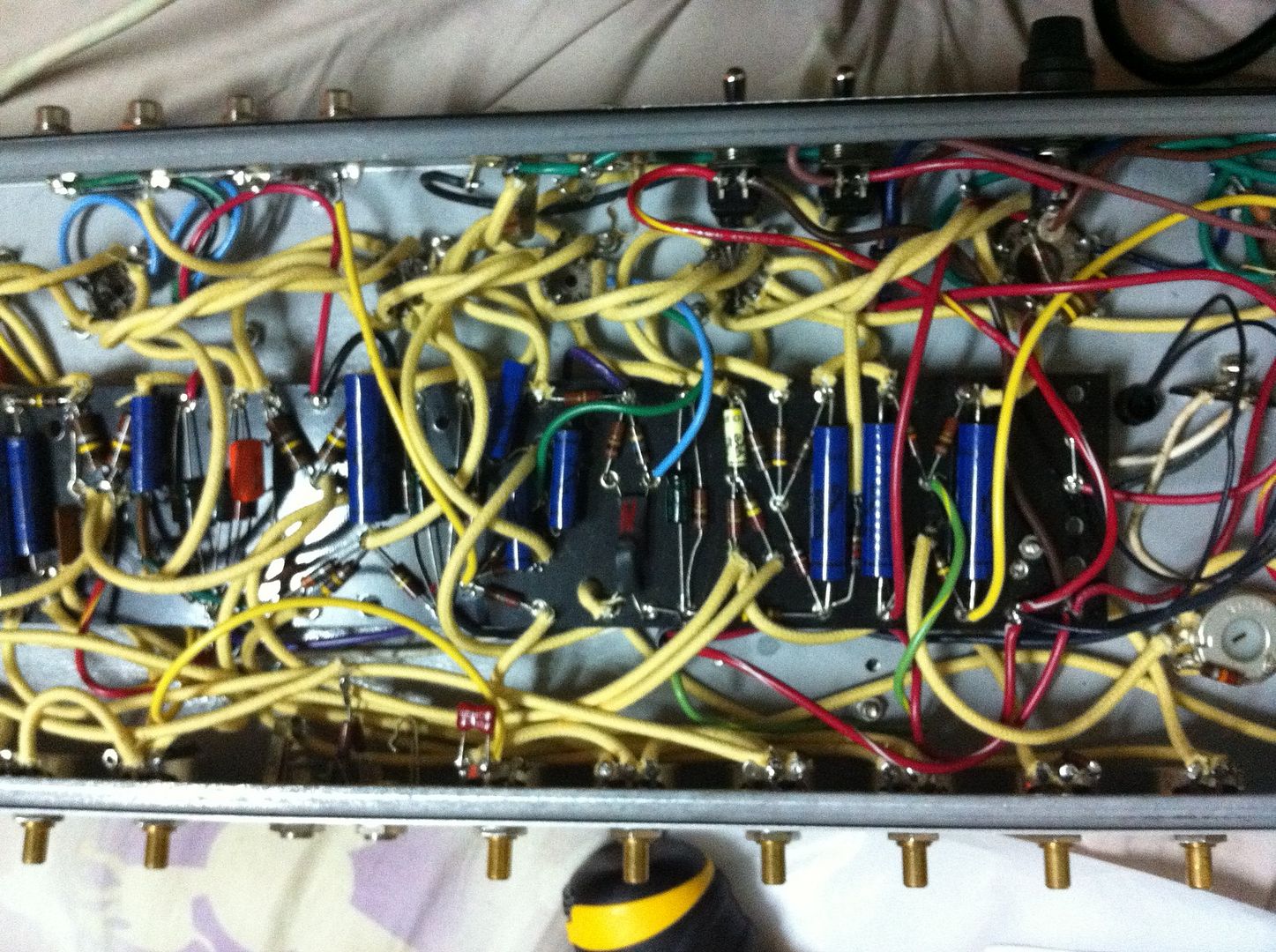

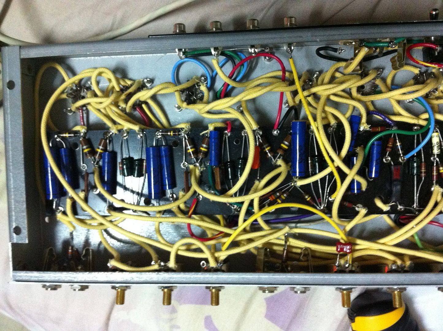

I too have just completed a Deluxe Reverb build and fortunately mine is very quiet. (probably good luck more than anything as it was my first build).
I don't know why the hum goes away after 30 mins but I do suggest that you think about following the original wiring layout as this will have a large bearing on how quiet the amp is. I followed Leo's wiring using pics of original DR's and the wiring layout diagram that you also have.
I know one thing that I read was that the heater wires should be twisted tightly and kept away from the other wiring.
Good luck. PS. The pics below were taken before I completed the heater wiring to V1,2 & 3.

i am sorry, my english is not good. my meaning is that i use 30 mins to fix the amp. so it is no hum noise now. and i also follow leo layout to build this amp.

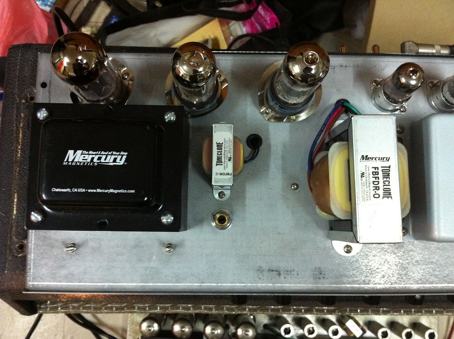

and your deluxe reverb is very nice too. BTW, the sozo bluemodded cap sound very good. and what brand of transformer you use?

I used Classic Tone transformers from Magnetic Components.
