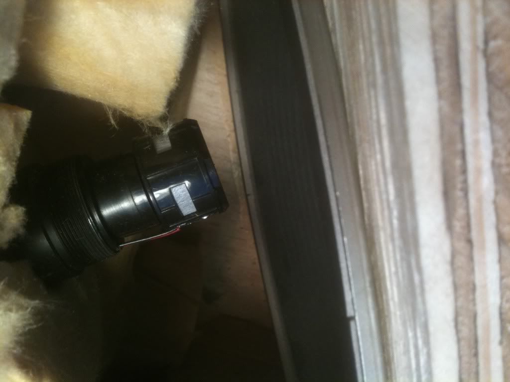

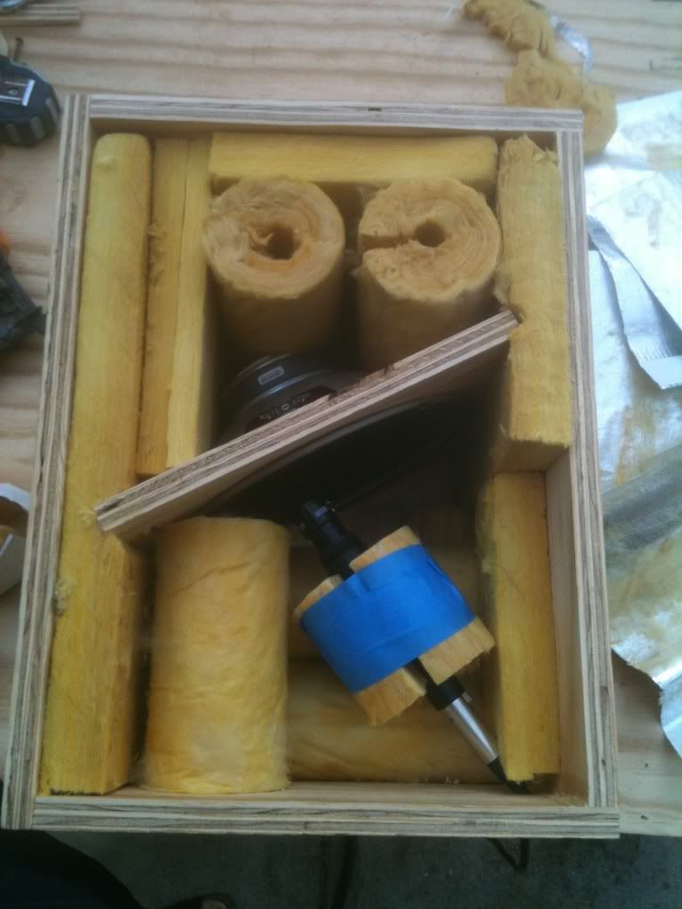

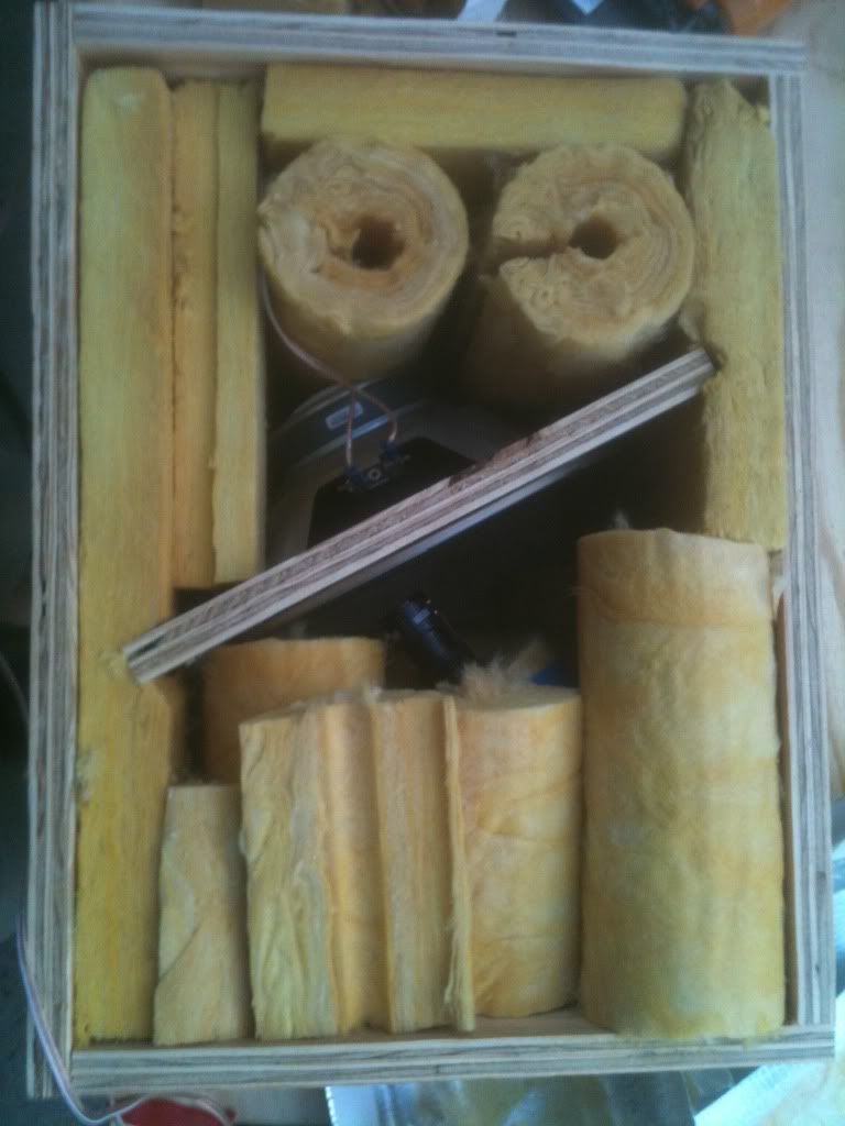

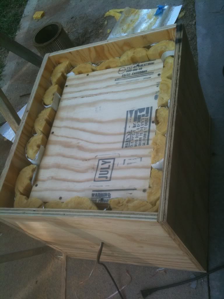

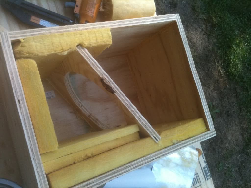

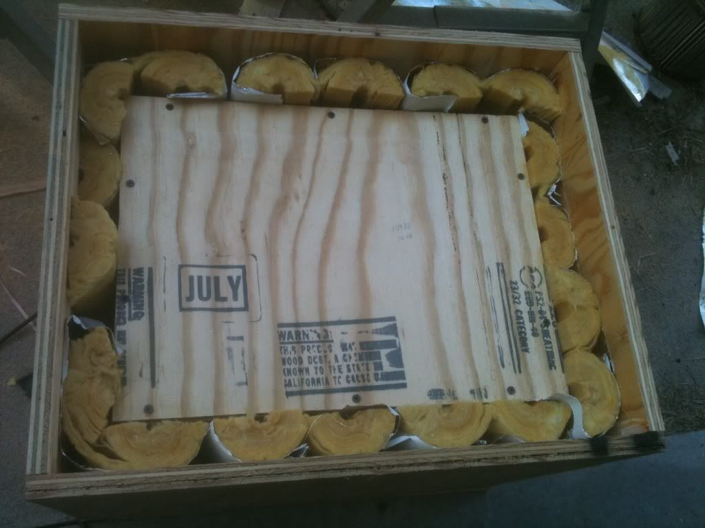

Offline seedlings
  • Posts: 25
Re: SEALED SPEAKER ENCLOSURE WITH MIC
« Reply #8 on: May 03, 2012, 11:21:39 am »
I built one such enclosure with double-walls and a Tube 10 speaker.  I put a cheap Nady mic inside, and jammed it as full as I could with owen's corning rigid fiberglass (this happens to be in pipe-form, but that doesn't matter).  When we went to in-ears, the goal was little or no stage noise, and direct-in sounded horrible.  This sounds very nice.  I left the 'sides' of the baffle open between front and back.  In my mind it was to give a 'open back' sound, but I can't say if it really helped.  With my 20W SE KT88 amp on full, strumming strings are significantly louder than the sound from the cabinet.
