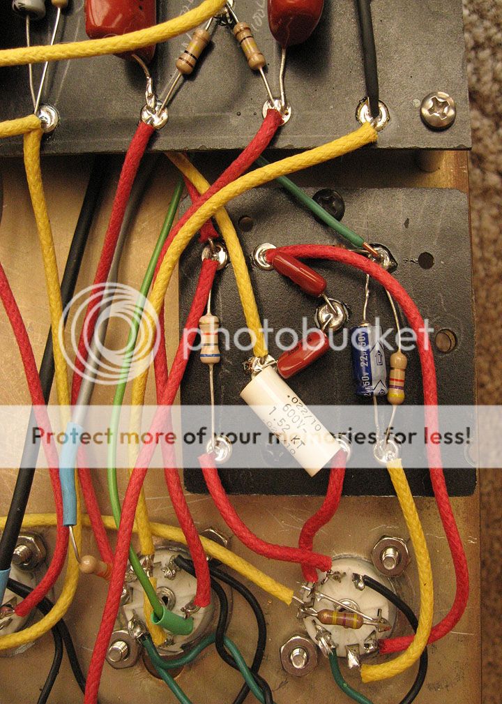

Offline Tyrannocaster
  • Posts: 263
Re: YUCK - tremolo installed - no tremolo
« Reply #10 on: July 21, 2012, 07:21:32 pm »
Here are a thousand words:
Maybe somebody can see where I plugged the output into the output or anything else equally lame. And yeah, I know my wiring job is messy but I just never do it very well, I'm afraid.
  • Posts: 13202
« Reply #11 on: July 21, 2012, 08:34:38 pm »
I see a presumably 1M resistor from the red wire connected to pin 2, which runs to ground.
The red cap that connects to it runs to another red cap. The junction of those red caps should have a 1M resistor running to pin 3 of the oscillator.
Is that resistor missing? If so, the oscillator won't oscillate.
I assume the yellow wire connected to the white 0.022uF cap runs under the board to the 3M reverse-audio Speed control.
In a nutshell, each series cap and resistor to ground is a phase-shift stage. Each stage shifts the phase something less than 90 degrees, therefore it takes three such stages to ensure the loop will shift the phase 180 degrees and oscillate.
  • Posts: 5302
« Reply #12 on: July 21, 2012, 10:07:31 pm »
That oughta do it.
  • Posts: 263
« Reply #13 on: July 22, 2012, 05:50:34 am »
Damned if you're not right! It's an error in my layout, which I followed faithfully and then managed not to see when I traced the signal while trying to troubleshoot. Heck, I should have just posted the picture first. Well I was right about one thing: that was worth more than a thousand words.
Thanks! I'll get soldering later this morning and maybe my neighbors will hear some Link Wray chords vibrating in the air.
  • Posts: 263
« Reply #14 on: July 22, 2012, 07:56:35 am »
It works; yippee tie one on! So it was a simple error in drawing the layout and leaving one resistor out. I never would have found it on my own though, as I proved to be totally blind to it.
It works really well, too; the speed range is perfect for my taste and the depth is fine at both fast and slow speeds. There is some mild motorboating evident at the fastest speed, but it doesn't get louder as you turn the amp up, which means that it's effectively absent unless you are playing very quietly. I guess that makes sense, since the volume control is in front of the tremolo and the power amp is on full all the time since I took out the master volume. I may try another master circuit at some point but the amp doesn't cry out for one.
There is one problem, though; the switch makes a major pop when you turn the trem on or off. It does it with both the footswitch and the switch on the amp so I think it's the circuit and nothing to do with the switch itself. Is this a case where a judiciously applied cap might clean this up? And I know that sometimes you can use a big resistor, too.
Thank you guys for your help in debugging this. I have been wanting to do a tremolo that doesn't work on the power tubes' bias for a long time and now I have one. The big advantage to this one is that it should be more portable to other designs than the more circuit specific power tube wigglers.
  • Posts: 5302
Re: YUCK - tremolo installed - no tremolo - SOLVED!
« Reply #15 on: July 22, 2012, 08:50:34 am »
I don't see a wire for the FS on your pic. Where did you connect it? Needs to be connected as shown in this pic...
  • Posts: 263
« Reply #16 on: July 22, 2012, 09:15:24 am »
Jeeze, you're right - it was in the wrong place! That red wire on the left is actually the footswitch connection. Amazing that it worked, I guess. I'll fix that as soon as I get offline; hopefully, that will fix the pop issue. That's another error in my layout and I followed the layout faithfully. This is why I like working from other people's layouts.
  • Posts: 263
« Reply #26 on: July 22, 2012, 05:36:13 pm »
You're right - it is not correct to use the term "motorboating" for this because that refers to oscillation and that's not what happens here. As you noted, it's a low frequency spike that becomes more apparent as the trem speed goes up (if you were able to set it at, say, 20hz you'd actually have a tone just from the number of pulses - that's not counting effect of the pulse itself!) and I believe you are also right to say it is a byproduct of the circuit. As I have said before, it isn't that bad when the amp is turned up to a reasonable level, and I just spent about 45 minutes playing it with different tubes in the V2 position and also with a dummy load through the board vs. through a speaker, just to eliminate that variable.
I wanted a preamp injected tremolo for this because I really like cathode biased amps with dual bypass resistors on the output tubes; it seems to let me use poorly matched tubes better, of which I have quite a number. I was also hoping the the circuit would be portable to other amps more easily than the output tube bias types, but with all these issues I don't know if that's true. Of course, most people wouldn't be trying to use this in an amp with two power tube bias resistors and two interactive channels, LOL!
One thing I can say for sure: this thing is really touchy about what tube is in V2, the first preamp tube. The trem is dramatically different depending on the tube - not the actual tremolo sound itself, but whether or not I get that odd volume drop when the switch is used. Additionally, the choice of tube really impacts the interactivity of the two channels. 12AX7s bring it out gloriously but it's too much gain for the amp and I don't like the quality of the resulting distortion at all. A 12AU7 gets pretty clean (this is a good Rockabilly amp that way, as is my '55) and makes a nice spanky tone but when I use a 12AU7 and turn the "unused" channel down all the way it oscillates - can't have that. It's not a whistling sort of oscillation, more of a buzz-crackle type. I only have 1 12AY7 here and it doesn't sound very good in the amp at all, although it sounds great in my old '55 Tweed Deluxe; go figure. I'm going to play with the amp (musically play, I mean) some more and see what I think works and what doesn't - luckily I am a much better player and listener than amp builder, and I'm also willing to go with whatever the amp seems to do best rather than try to force it into my ill-conceived notion of how it is supposed to sound. I just don't want any obvious problems such as the strange volume drop or oscillation,  etc.
And thanks for that detailed response!
  • Posts: 263
« Reply #29 on: July 23, 2012, 06:54:25 am »
Remember the cap trick (that didn't work) on the depth pot? Try putting a resistor (1K to about 10K) where that cap was and see if that helps.
If this doesn't help, you could always convert to power tube trem. It works with cathode bias circuits too.
I'll try the resistor later today. Can you do a power tube bias tremolo circuit on an amp that uses separate bias resistors for each tube? I also wanted to try this Vibro Champ trem out because in the past I have had so much difficulty with bias tube trems; looks like they can all have their share of bugs.
  • Posts: 263
« Reply #30 on: July 23, 2012, 08:52:49 am »
It looks like I have to choose between a switch and a deep tremolo. The 10k resistor helps with the volume drop when the trem is off, but it decreases the depth of the trem when it is on. Lower values increase the off volume drop and the tremolo depth. I imagine that going even higher would solve the volume drop off completely but then I would have little or no tremolo left.
I am about ready to simply remove the switch jack and have a knob-only tremolo. It's not ideal, but it's better than the alternative. I am pretty sure now that I've wired this correctly; I wonder how it works in the Vibro Champ. I've played those and I don't remember any volume drop when you turn off the tremolo - Fender would never have let it out of the factory if it did that. So it has to be possible to get it to work.
  • Posts: 5302
« Reply #31 on: July 23, 2012, 09:58:21 am »
I believe it's wired correctly too. But what does that mean? You have a cross breed between a 5E5, 5D3, and VC. Fender never built this crossbreed so it's unfair to say they would have never let it outta the factory. Just because that trem works for a VC doesn't mean it will work properly with your amp.
I still believe we can make it work satisfactorly for you with a little tweaking, so hang in there. I have two more ideas. Maybe one will work.
1. Again, remember the cap trick that didn't work? Well combine my idea with HBP's idea. Use a .1uF cap and remove the 5uf cathode bypass cap from the gain stage. Does that work? If this works but the overall gain is now too low, reconnect the 5uf bypass cap and replace the .1uf cap with a 50uF cap (positive lead to the pot. Does this work?
2. Put a diode (1N4007 is fine) between the depth pot and the gain stage cathode Just like the cap trick) The diode's cathode connects to the pot. Does this work?
« Last Edit: July 23, 2012, 10:01:25 am by sluckey »
  • Posts: 5302
« Reply #32 on: July 23, 2012, 10:18:58 am »
Ding! I just had another idea. Put the 10K B+ dropping resistor back in to lower the supply voltage to the trem circuit.
  • Posts: 263
« Reply #33 on: July 23, 2012, 10:40:38 am »
Thanks for the suggestions! The diode didn't do anything except prevent the trem from working at all. Putting the old B+ back resistor didn't seem to have any effect, positive or negative. I can try the other idea later today.
EDIT: Removing the cathode bypass cap and adding the .1 cap to the pot killed the trem, although I could hear a ticking sound.
« Last Edit: July 23, 2012, 12:00:03 pm by Tyrannocaster »

  • Posts: 10630
« Reply #37 on: July 23, 2012, 06:13:57 pm »
I know HBP said it's not PSU LFO, but at this point I'd be tempted to see if giving the term tube it's own ground star node would help?
I know you had it in at first but the 10K B+ dropping R was too much, so you took it out.
Since you've tried about everything else, if it were me, I'd try it again but this time with a 1K or 470R + 20uF/450 cap and run all the grounds from the term tube to a single ground star and then run a single wire to your ground buss. Might not fix it but it couldn't hurt?
Just a thought, but it will put the idea to rest one way or the other if you try it again.
                  Brad       :think1:

  • Posts: 5302
« Reply #40 on: July 24, 2012, 06:51:59 am »
I think you should add the NFB circuit exactly as implemented in the VC. It 'could' be a factor although I doubt it.
The trem circuit is behaving exactly as I think it should. The way I see it.... When the trem is on the dc voltage on the osc plate is about 170v (as on the schematic). But when you disable the oscillator with the footswitch, the voltage at the osc plate will rise considerably (tube drawing less current). This rise in plate voltage is direct coupled to the cathode follower's grid and causes the voltage on it's cathode to rise also. The increased dc voltage is then passed on to the gain stage and will reduce the gain of that stage. The fact that you get the gain back simply by turning the depth control down to zero is normal because you are no longer passing that dc voltage on to the gain stage.
There may be a way around the above situation. Let's try cap coupling between the osc plate and the cathode follower. To do this, remove the jumper between pin 1 and 7. Also move the red wire (the one that goes to the white cap) from pin 7 to pin 1. Now put a .1uF cap between pins 1 and 7. Finally, put a 1M resistor between pins 7 and 8. Now the trem osc is cap coupled to the cathode follower and the dc voltage on the osc plate will be blocked from the cathode follower and will not affect the gain of the gain stage. There will still be a dc voltage on the cathode of the cathode follower just due to it's operation, but the change in dc voltage from the plate of the osc tube will no longer be a factor.
It's a quick and easy mod and can be done (or undone) right on the tube socket. I offer no guarantees but it sounds like it just may work. Definetly worth a try.
If this doesn't work well, then I'm about out of ideas. You may have to accept it for what it is. And remember, this trem circuit came from the cheapest, bottom of the line, trem tube amp that Fender ever built. There may be a reason this circuit never made it into Fender's upper class models.
Hopefully one of the heavy theory guys can confirm or reject my idea about cap coupling between the osc and the CF. Give it a try and let us know.
BTW, I've looked for alternate ways to switch the trem on/off and just don't see one that works without popping using a simple SPST switch that will have one leg connected to ground.
