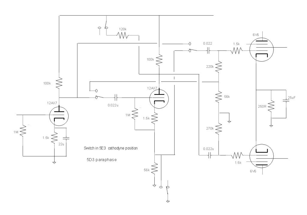

In your earlier post that disappeared you were saying you wanted to compare the 5E3 to the 5C3. Not sure if you would be interested in comparing the two circuits in the same amp but here is a circuit that switches between the two PI's which is the difference between the circuits using a four pole switch.
Thanks for the info on the PI.  I may experiment with this as I get deeper into the project.  Right now I am more interested in the difference in preamp tubes...noval vs. octal.  A few years ago I built a Weber 5C3P kit for a guy and it sounded nice.  I think lots of what I liked was the octal preamp tubes.  Of course the difference in PI contributed but I'll get into that later on.
